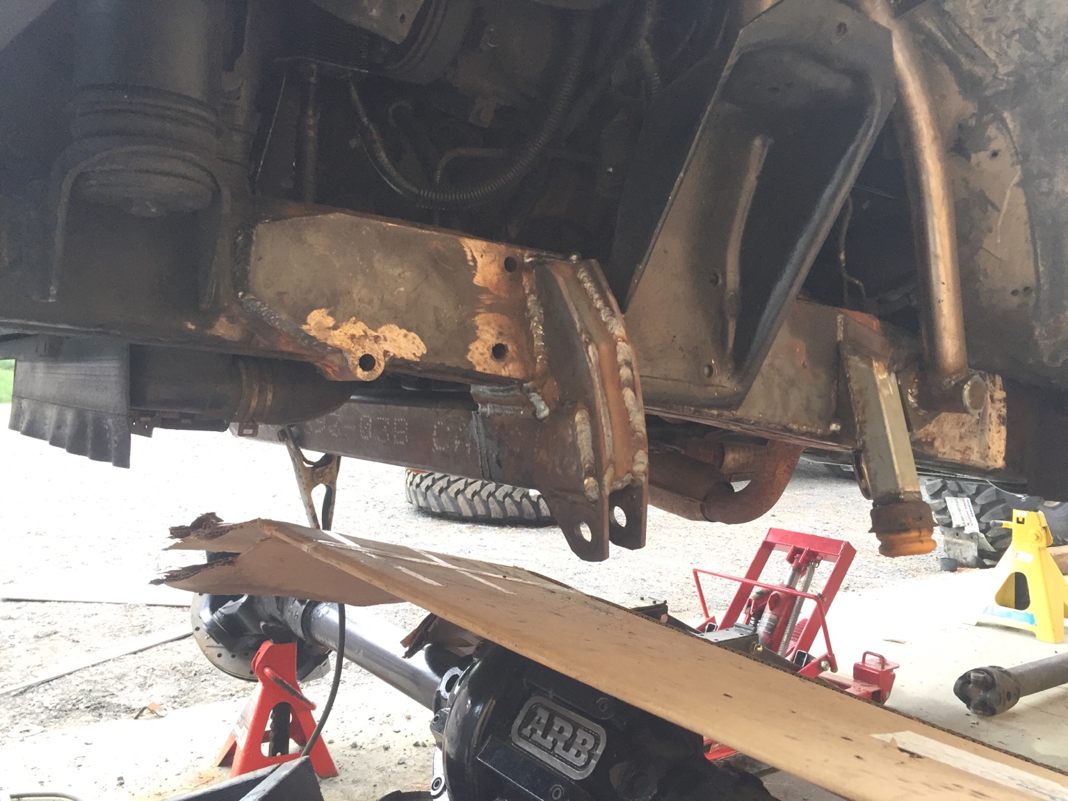

Engine crossmember/track bar mount support

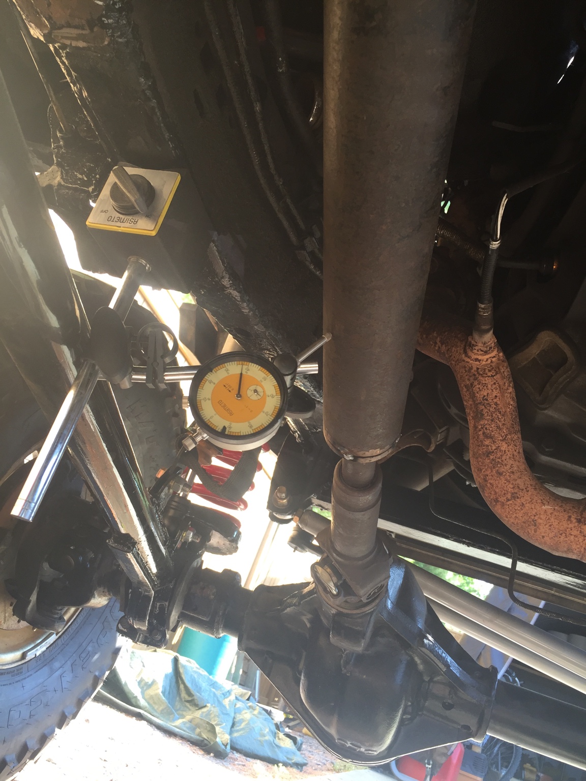

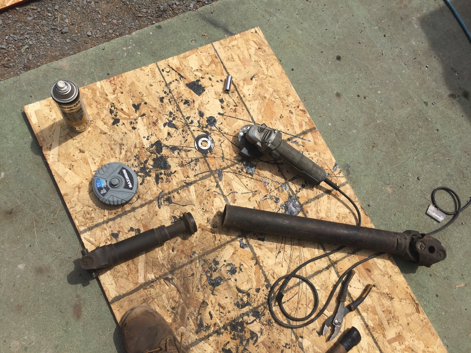

Shortened the driveshaft, still have to true it up and weld it.

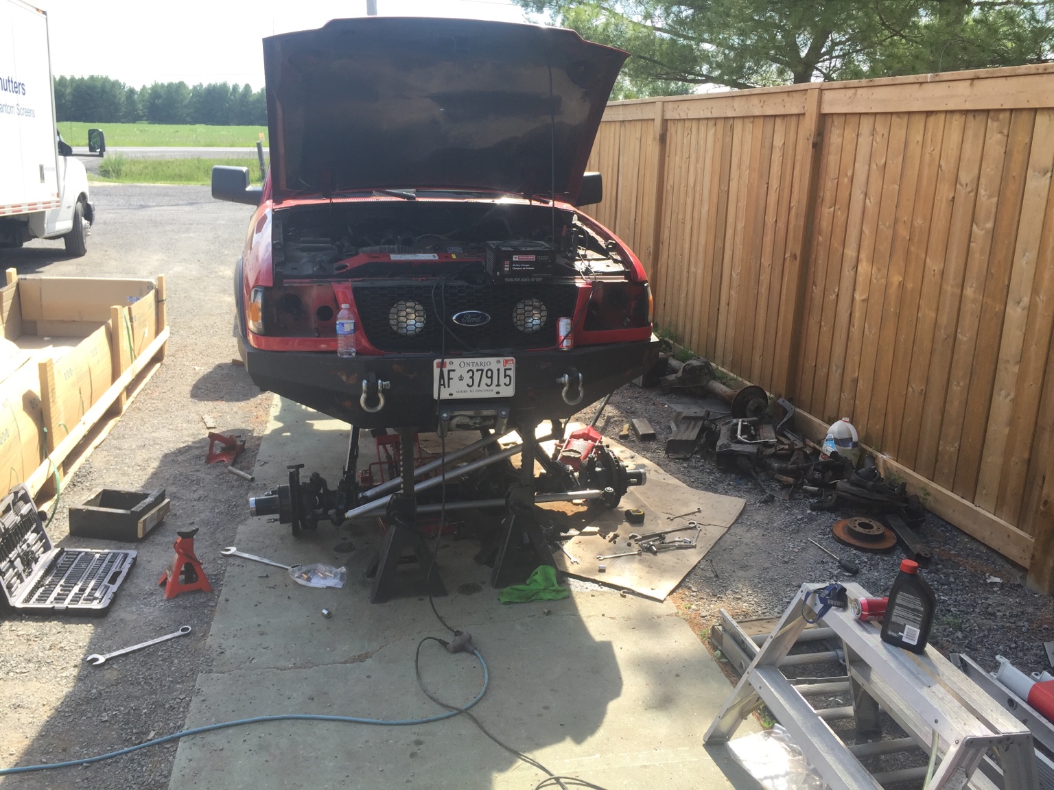

Power steering is hooked up and works!
02 FX4 Twin stick Build

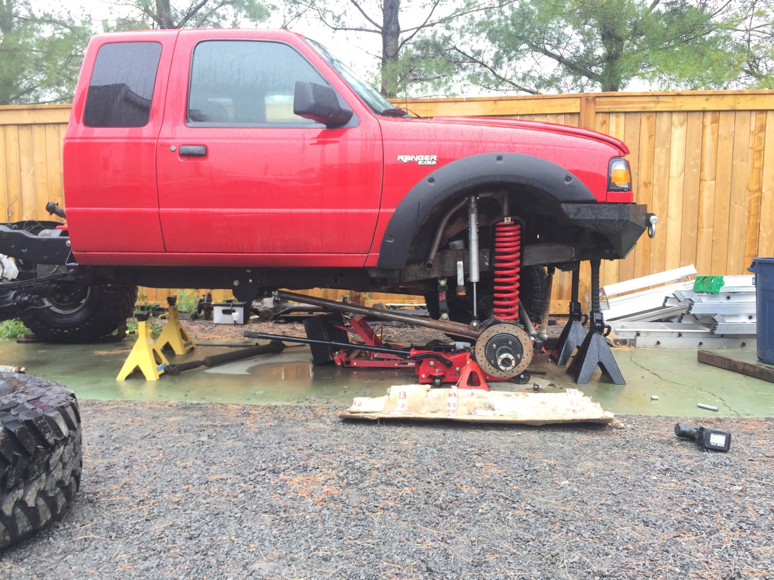

Finished brake lines for front and rear, e brake cables are hooked up, shock mounts on rear axle are welded on, front driveshaft is welded, getting pretty close to driveable

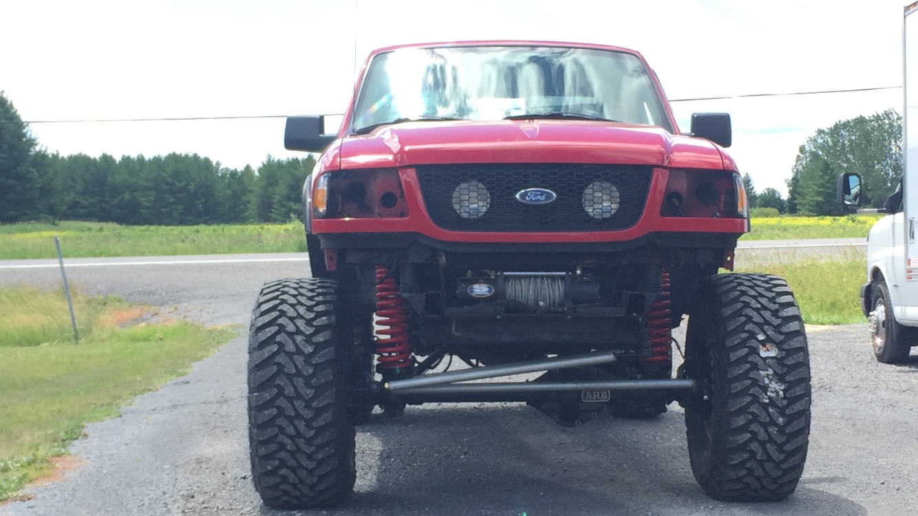

Drove it for the first time today! Needs lots of little things here and there finished, but it drives nice and cruises nicely at hwy speeds too.

Wow looks awesome with the full width axles. Nice Work!
Cant wait to see some action shots :headbang:
Thanks, got a couple things to finish before it's ready for the trail, but when it's ready I plan to take it to calabogie
Tried to see what it can do on some stuff near my place, but I can't find anything big enough lol, it didn't even phase the truck. it's also only rear wheel drive right now too

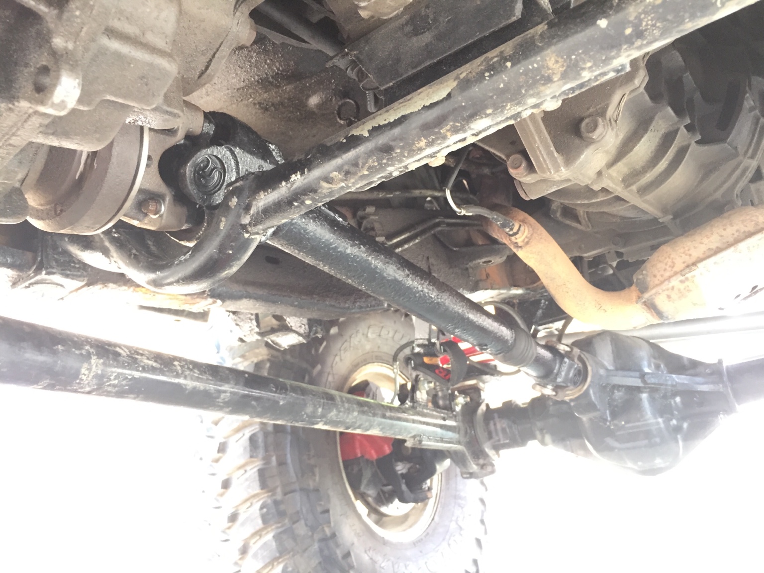

I've been trying to figure out a vibration I've been having, ive messed with the pinion angle and still couldn't get rid of it, turns out the used transfer case I put in has a bad rear output shaft bearing.
So I put the old t case back in, I found and adaptor that with convert the front flange to work with a double cardon shaft. So il order on of those

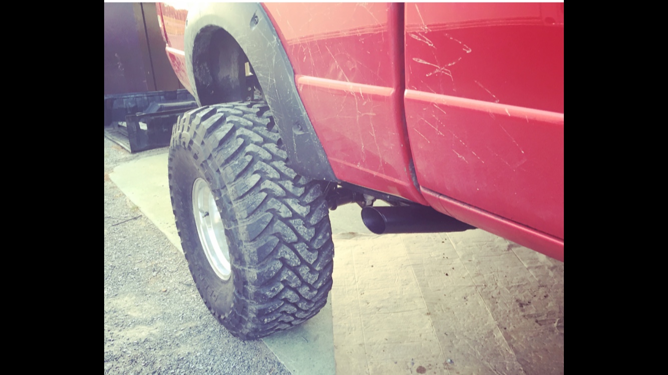

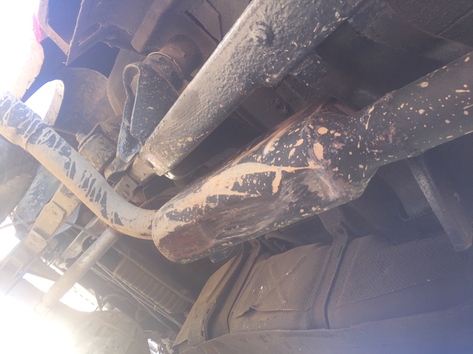

I redid the exhaust and went with a black tip

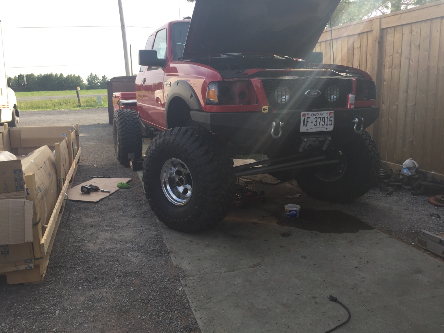

Still no flange for the tcase so I only have 2wd, I went out anyways

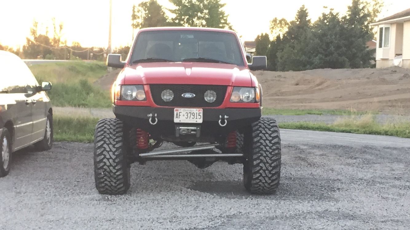

The ranger is looking badass!!! You did a great job on her and is one of my favorite one on the site !!
Front driveshaft is in

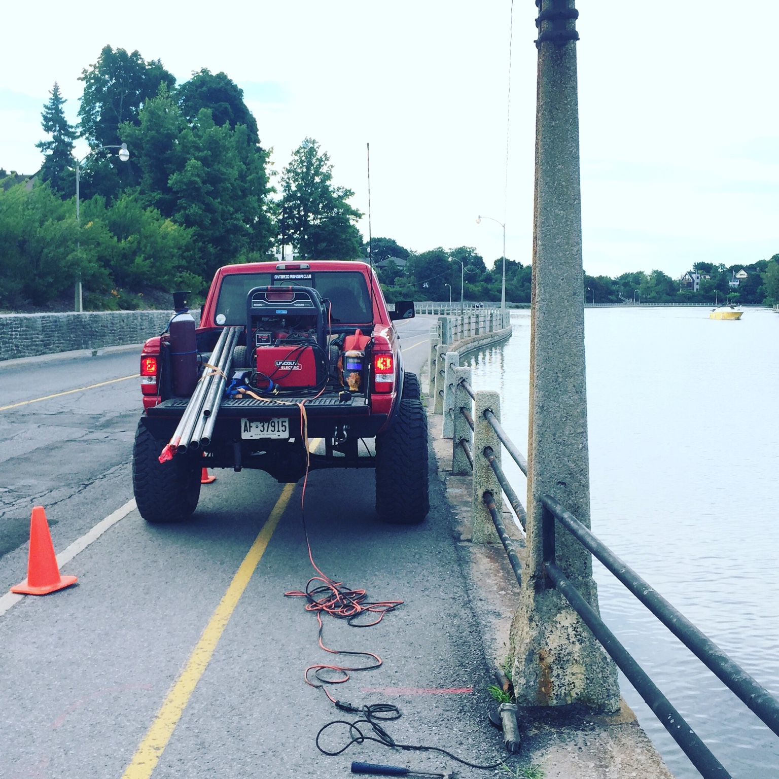

It makes a decent welding rig too

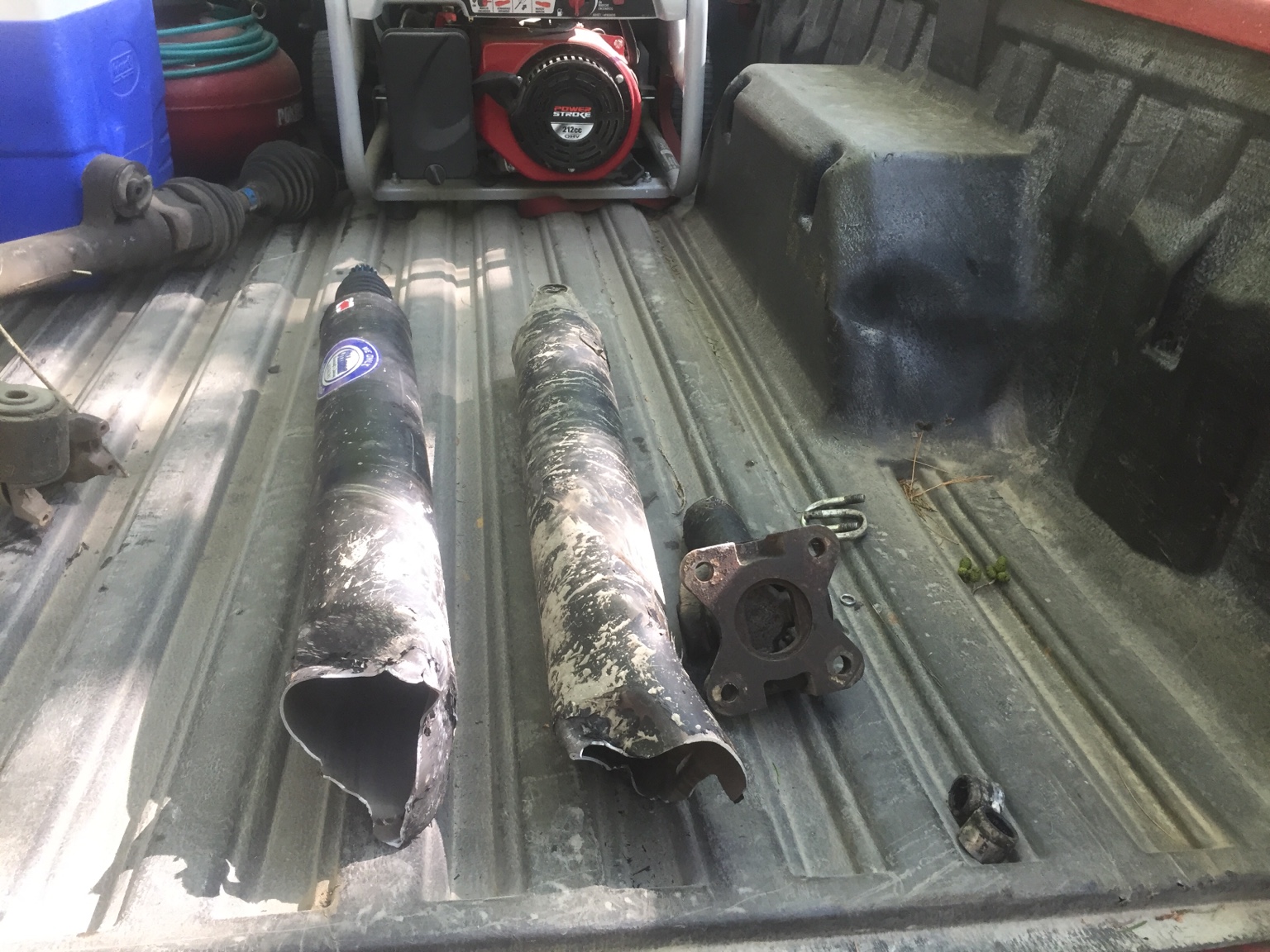

So much for that driveshaft lol

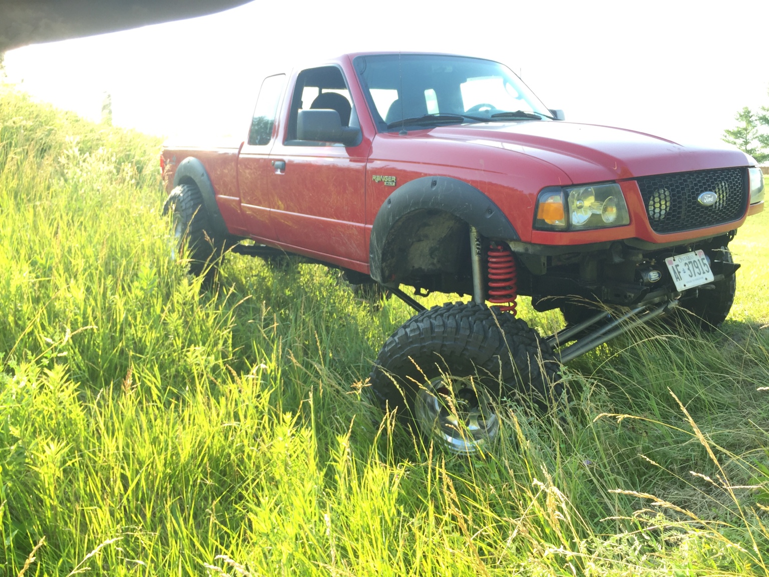

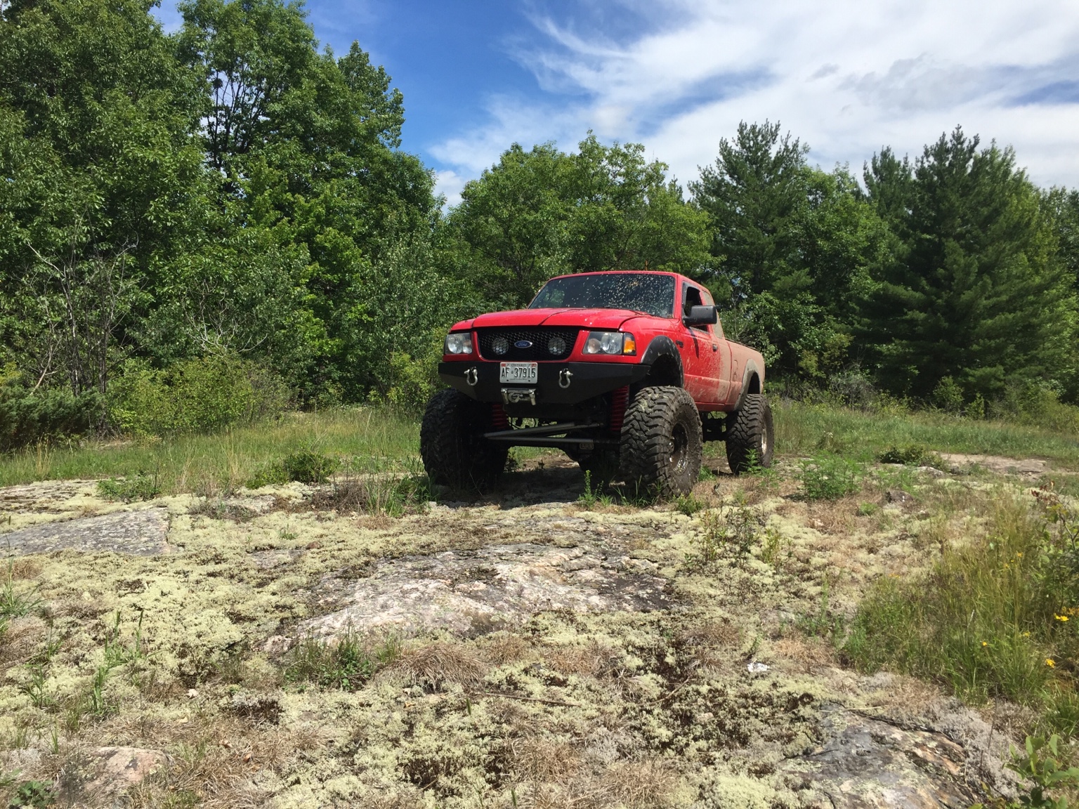

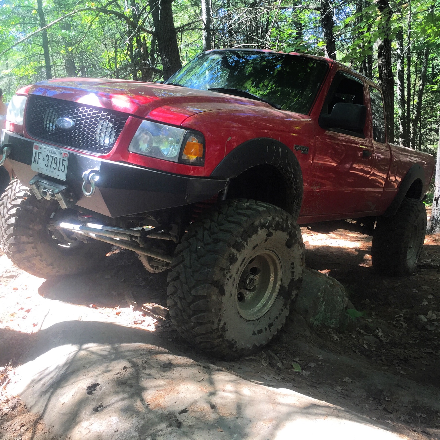

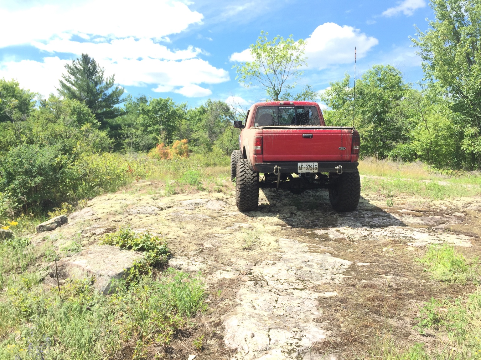

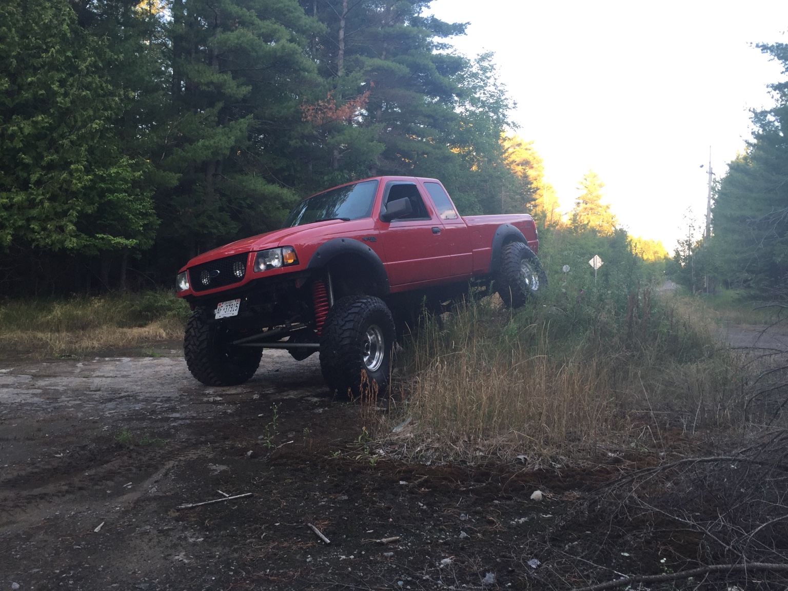

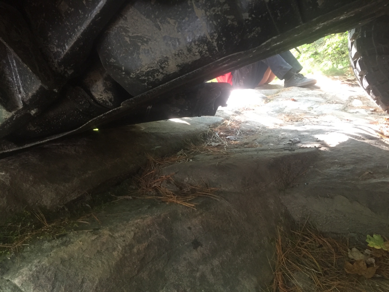

Still made it out in front wheel drive, the front true trac works a lot better than I expected, you'd almost think it was a locker
Climbed a jeep in fwd
