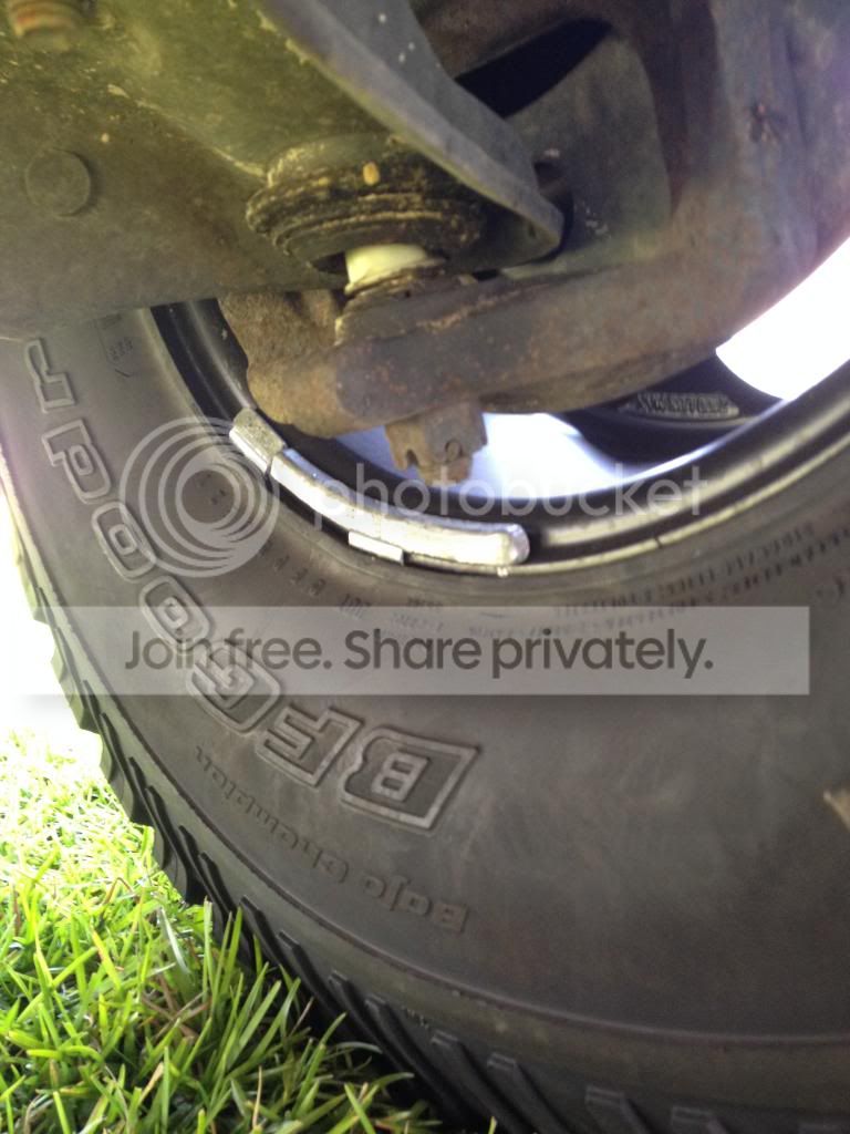

Here's a pic of the drivers side lower ball joint. I haven't lifted it to see if it wiggles/wobbles, but I at least know the rubber is gone. It's an '02 with 84k miles on it. I figured after 12 years of life I might as well replace them. Better safe than sorry.

The lowers can be pressed out, you can do it at home if you have the right stuff.
The uppers are the ones that require arm replacement.
Thanks ADSM. I did some more research via a few forums and learned a bit more. I'll rent the press and pickle fork when change them out.
