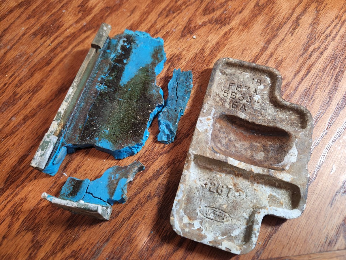

I haven't found the plastic/rubber part alone, but I might make one from a sheet of poly.
