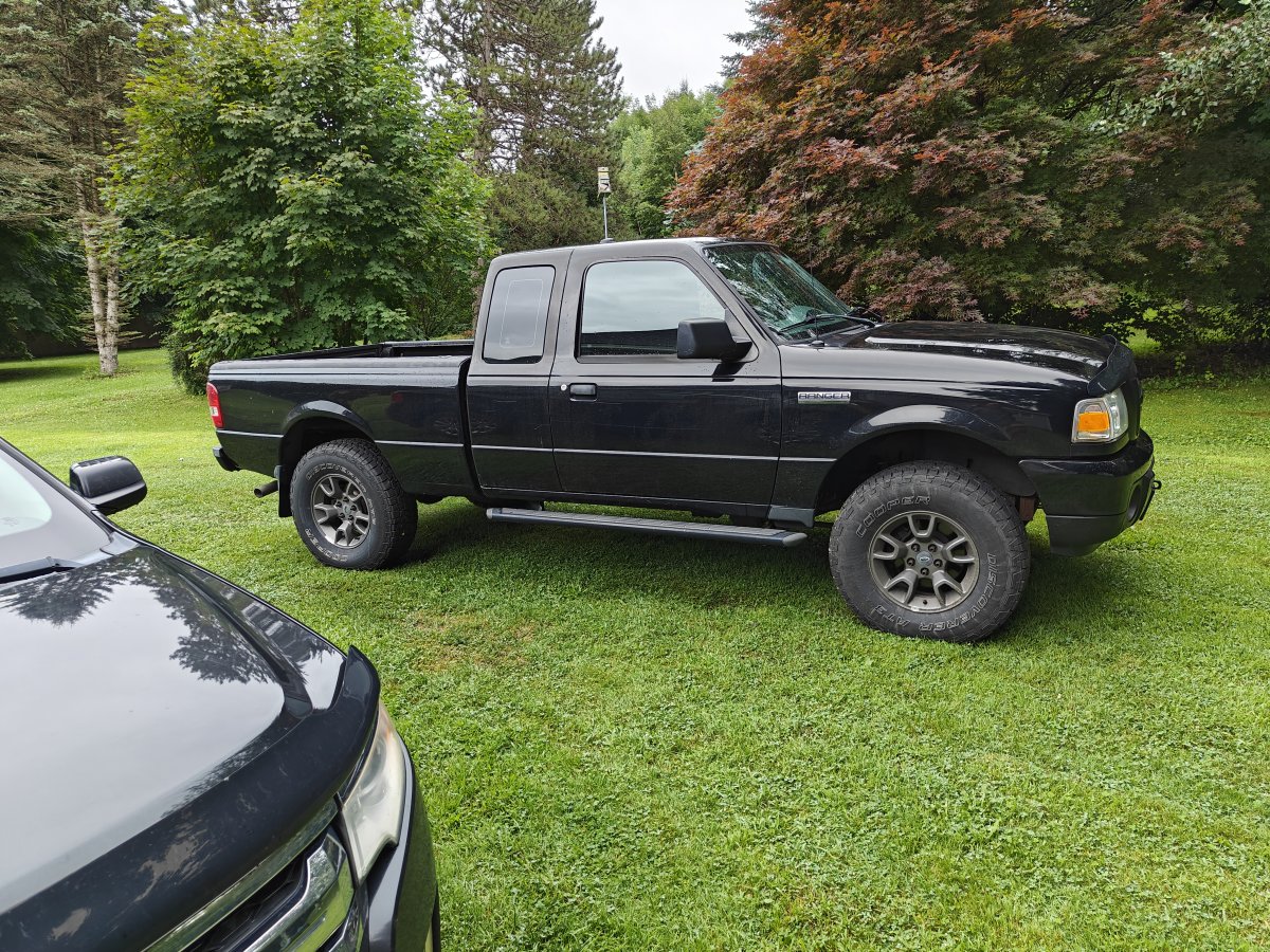

Hey guys, I just bought a used 2011 Ranger 4x4 and on the test ride it went great and also on the way home from buying it. Apparently he had added 2" torsion keys to level the truck but the front was at least 1.5" higher than the rear.
After driving on bumpy roads on my way to work this morning I realized I had a problem. When I hit a bump it ripped the wheel right out of my hands and the truck rode very harsh as well. After asking a friend at work he noticed that the previous owner had added torsion keys but he ALSO cranked the adjustment bolts up so the front shocks were maxed out. Instead of making the truck level it was squatting. Looked terrible and drove even worse lol.
Anyway I got in for an alignment and had them back off the torsion bar adjustment bolts so the truck is dead level now and rides great after the alignment. My question is, is there any point going back to stock keys and use the adjustment bolts to level the truck or would I just be at the same point I am now? I hope this makes sense. I think the previous owner took the "long" way around, swapping keys when he could have just turned the bolts in but now the keys are in there and the truck is level and rides ok. Just leave them?
How the truck looked before I had it adjusted. I don't have a level spot on my yard to park the truck on.

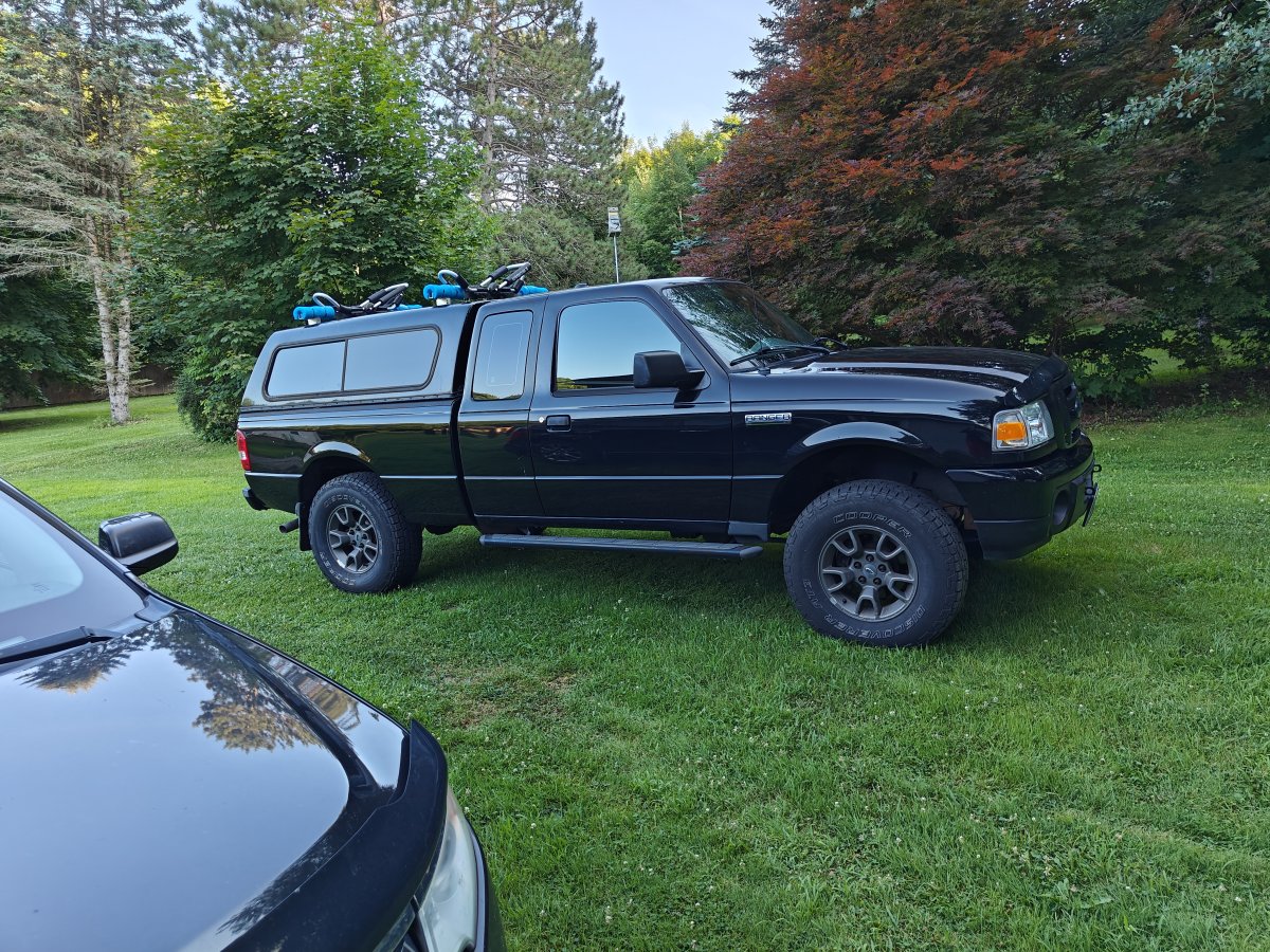

Fyi, I was just looking for a nice clean Ranger and never wanted any kind of "lift" though it doesn't bother me as long as the truck rides nice and isn't chewing up parts.
How it looks now:
Thanks, it kind of makes sense to me now. I know if it were me I would have never bought them but oh well.
i would leave them too. its nice your truck is leveled and a little taller thoug. it looks good
