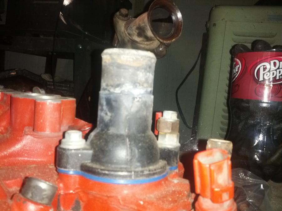

If i swap out the lower intake plenum I have to swap out the upper as well because the bolts that secure them together are different sizes and the coil packs are mounted in different locations. The '01 Intakes are baked in oil as it had a blown engine and was consuming 1 QT of oil every 200 miles. benefits of swapping out the lower intake plenum is that the '00 thermostat bolt was damaged during last removal. I stuck a high quality thermostat and a $10 gasket and it didn't leak. picture included.
