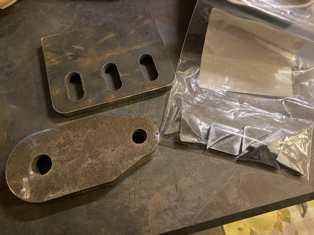

The week after I let the kids paint my valve covers, I decided it was time to do something about my font bumper mounts. I can't find a picture of how I had initially done them, but it was super janky. I had cut up a set of stock mounts and scabbed them on with some 1/4" plate.
I wanted to ad recovery points and I wanted the ability to build in a winch box so I chose 1/2" plate. This is what I drew up in CAD.
55458
1/2" A36
55459
The plan was to cut slots into the bumper so the shackle tabs would slide through. Now I have two recovery points that will pull directly on whichever frame rail. I think I'll have to do some beefing up on the frame side if I ever put a winch on it. My core support is toast.

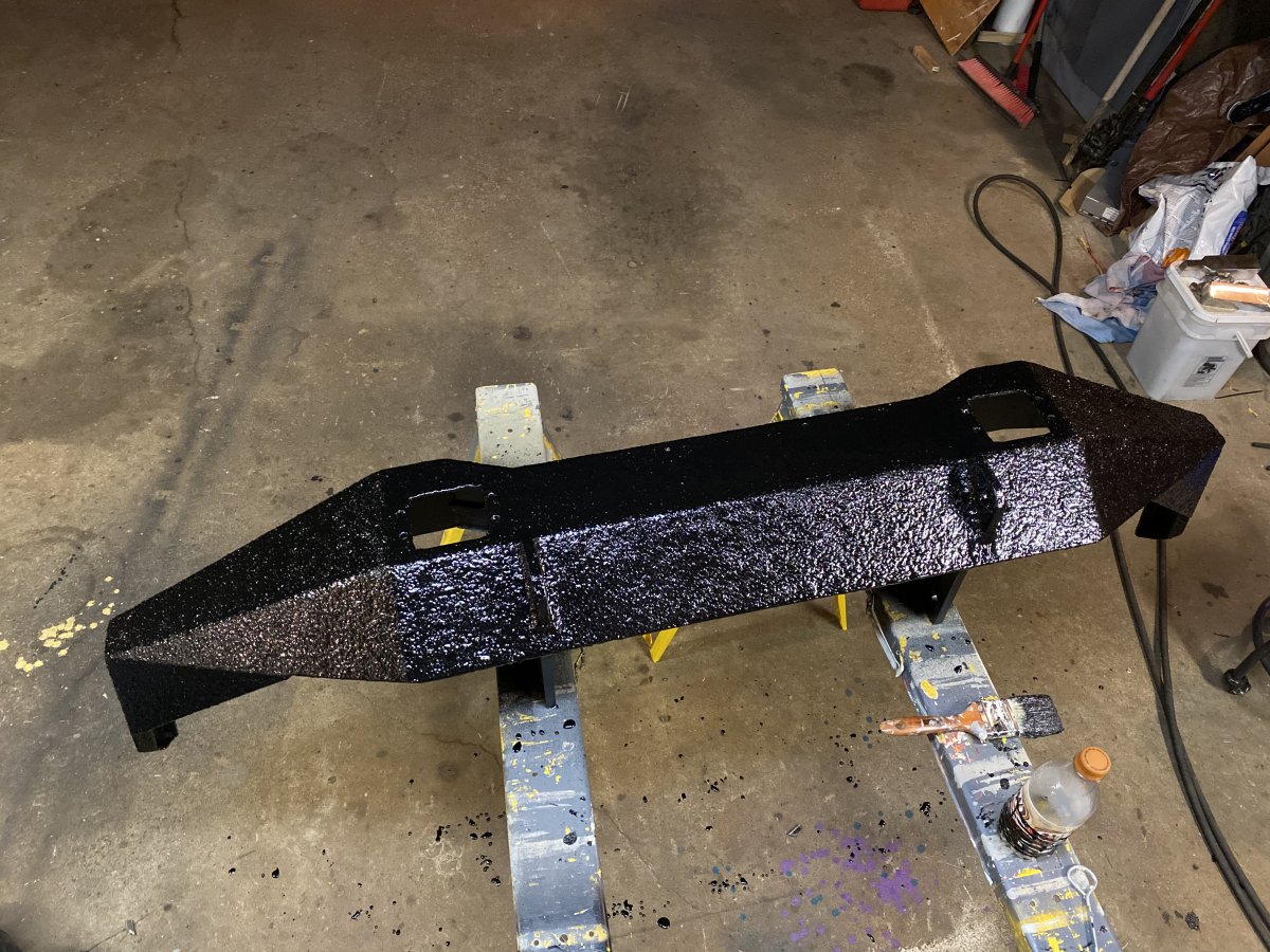

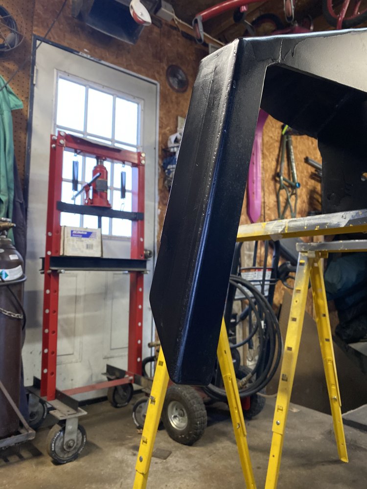

Decided I might as well finish the bumper complete while I had it off. I had never finished the sides. Sorry the pics suck. I'm terrible at stopping to take them. I added the filler plate on top and capped the end of the C channel that actually makes up the sides of the bumper.
55466
55467
Two coats of herculiner.
55468
And its finished (for now). Yes that's a purple smiley on the front diff.

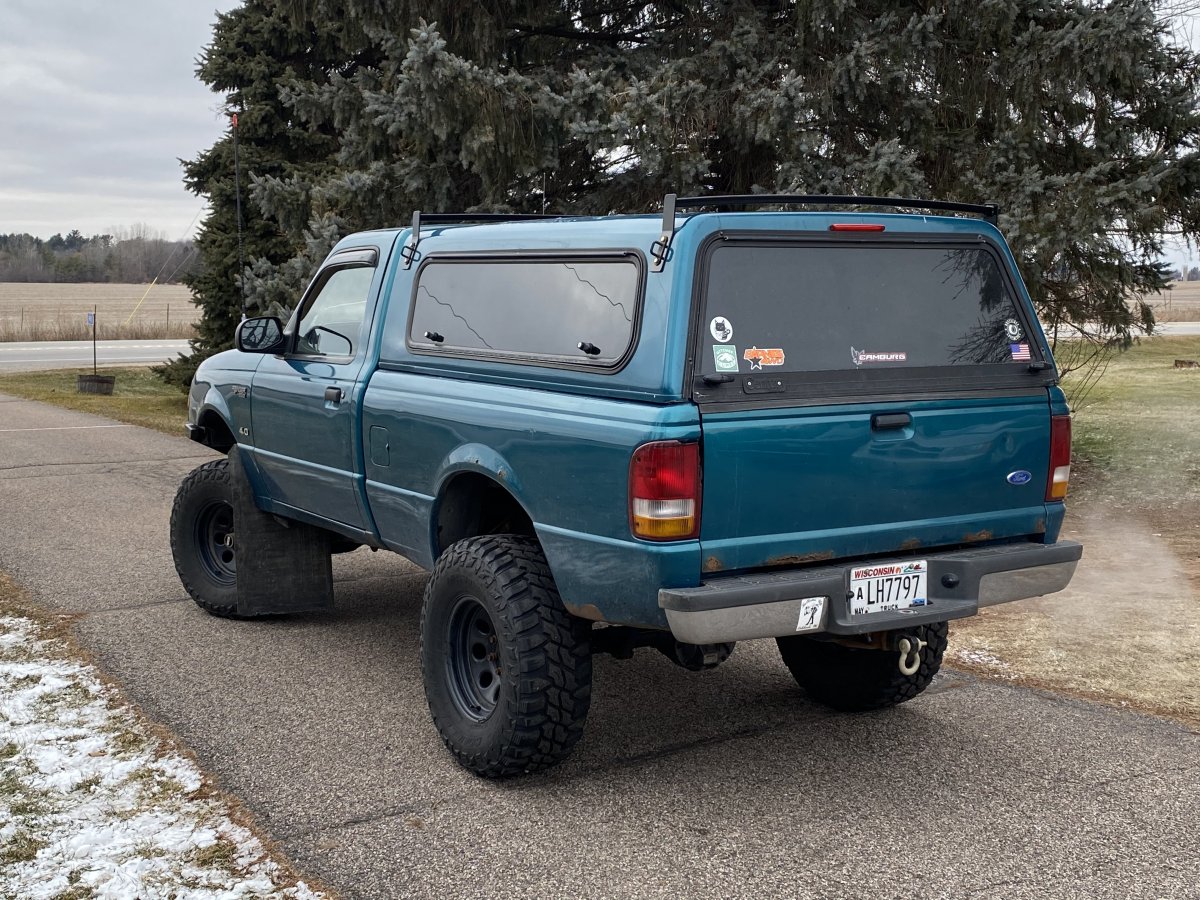

Fast forward about a month and I noticed the Explorer roof rack I mounted to my topper was loose. I couldn't devise a good, sturdy way to remount it so I took it off.

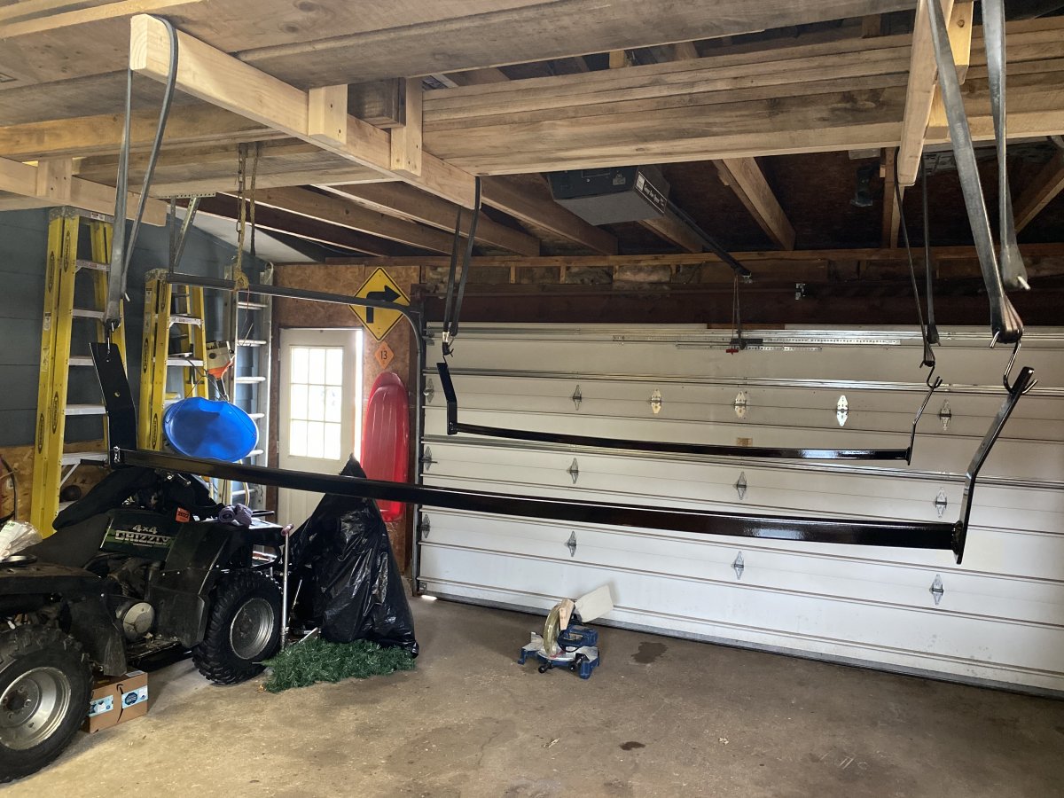

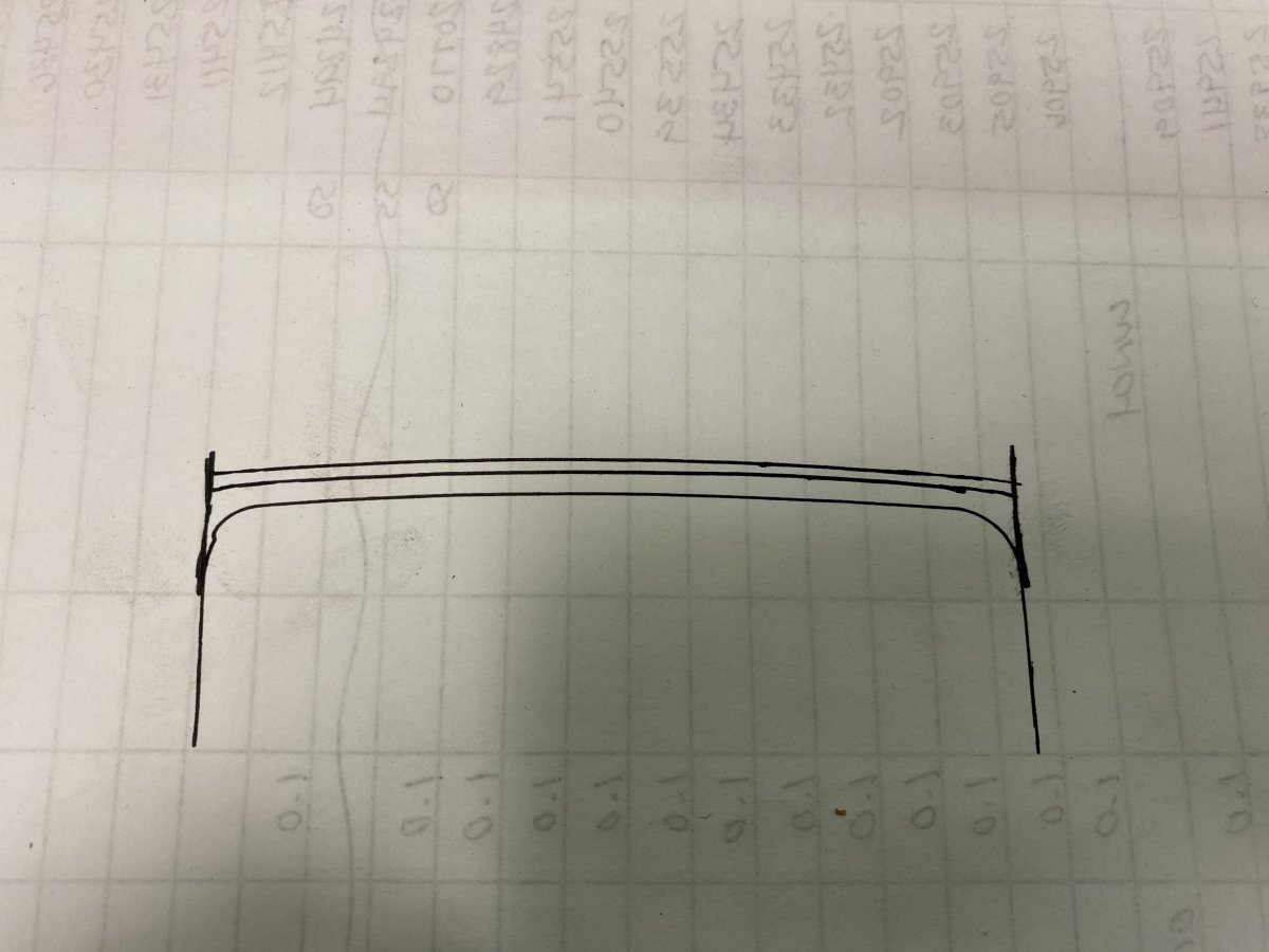

And wouldn't you know it, I needed a way to bring a 16' board home for a closet shelf! :pissedoff: So I made a call to my local steel supplier for some 1x1 square tube and some 3/16 x 3 flat stock.
Pretty simple plan.
55471
Bending side plates.
55472
I've had these factory bed tie downs floating around my tool box for a couple years.
55473
I used the D ring on the back of my truck to bend the slight arc in the square tube. Use your imagination.
Welded up and paint drying.
55474
Mounted pretty easy. 4 5/16 bolts in each bar with doubled up fender washers on the inside. They're rock solid up there now and shouldn't come loose any time soon. They handled the 16' x 18" shelf board perfectly. Failed to get a pic of that.

Let me know what you guys think. A buddy and I are planning a small overlanding type trip for the end of June. The trail we are planning to run is called The 7 Hour Plane Crash trail. It goes from Crandon, WI to the tip of the Keewenaw peninsula in the UP. He has a 2009 Tacoma with a 2" lift and 33's. We both camp out of our trucks a few times a year so it should be pretty fun.

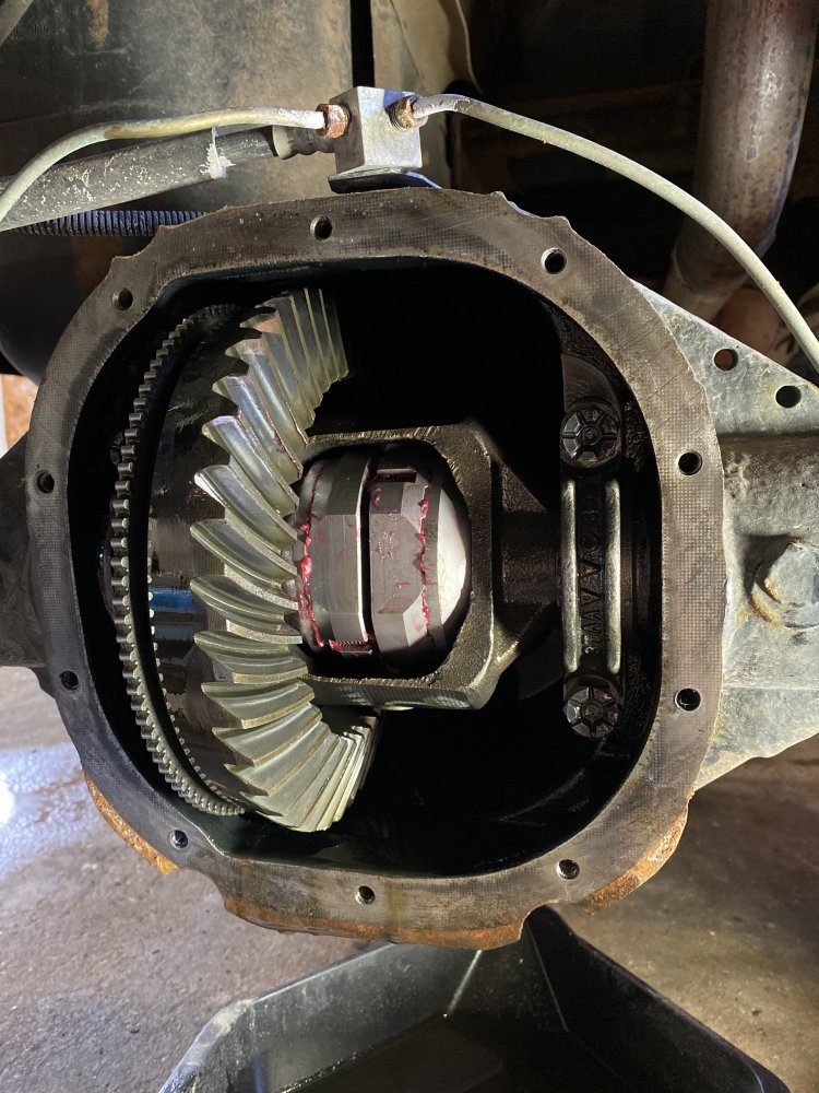

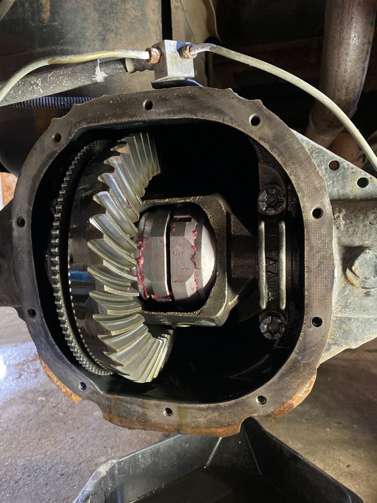

This is the only picture I took yesterday during the locker install. Not much to see anyways.
Couple loud bangs and some pops and it’s working like it should. My carrier is really tight so I’m on the low end of the tolerances. 0.008” and 0.007” on the cross pin to spacers and 0.148” between the cam gears. I guess the Explorer’s auto 4x4 really saves on wear in the rear end. We’ll see how my driveshaft holds up.

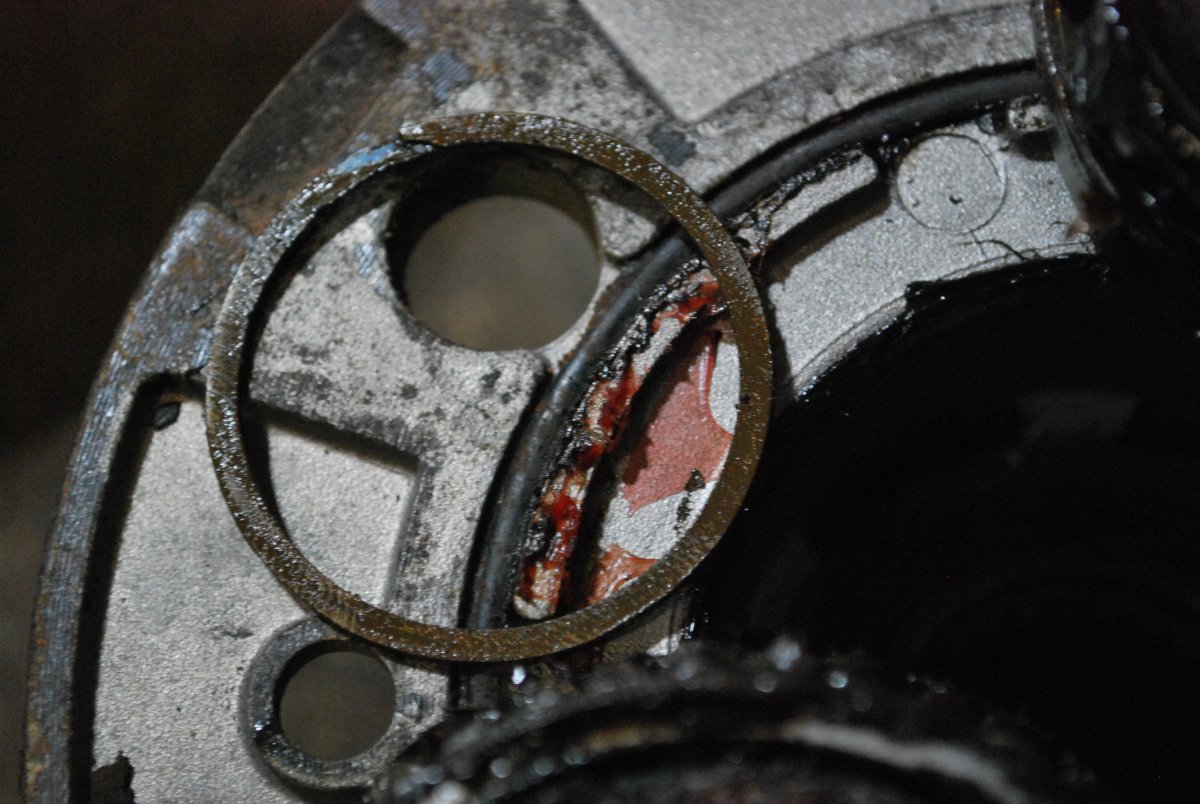

Heres the snap ring or circlip or whatever you want to call it that popped out. This actually allowed the hub to just barely slide into the locked position. I've had both Warn hubs apart before. I should really replace these with real snap rings like the Mile Marker hubs have.

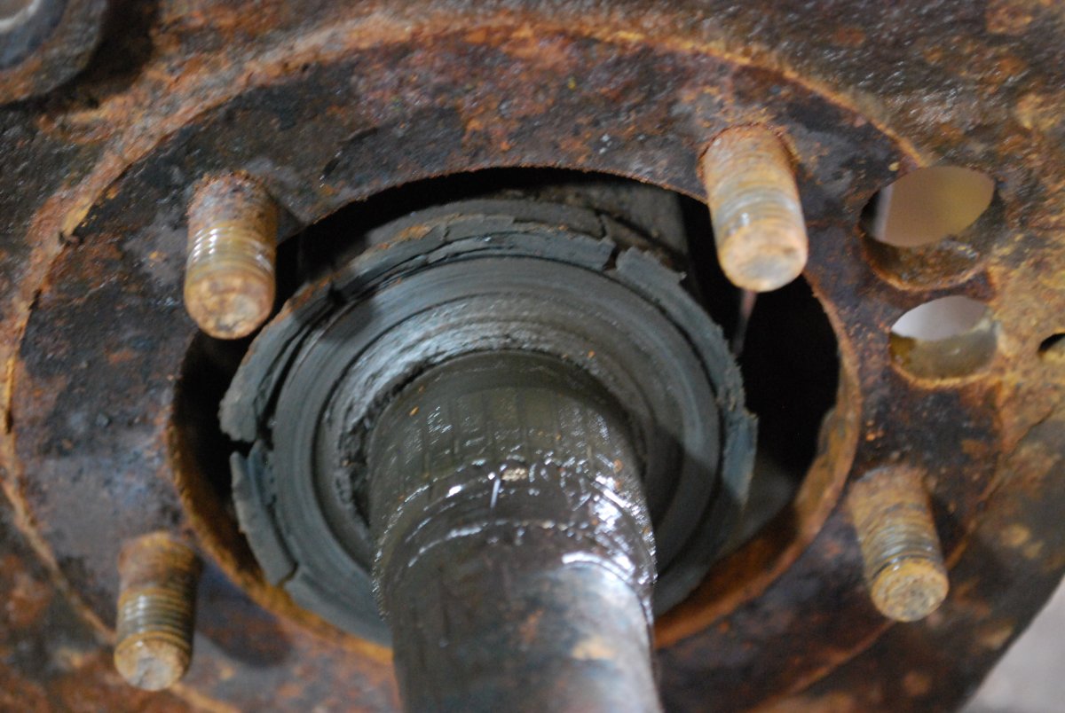

Looks like I REALLY need some seals before the truck sees any mud.
55623

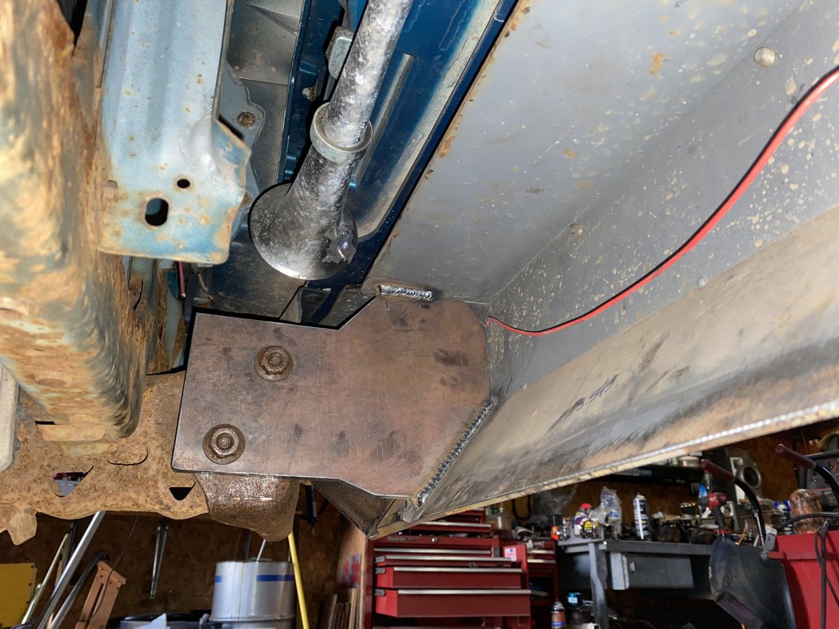

Made parts for a transmission crossmember. Im going to steal Skyjackers idea a little bit.
