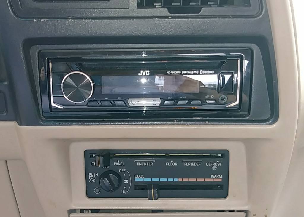

I picked up an AM FM CD player for my truck from Best buy for $85, it was what they call "open box" reduced-price, with the promise that everything was in there, and everything was, it plays great, sounds great, no noise no distortion, has Bluetooth and all the other bells and whistles that go with newer technology,

You paid too much for that.
I just got a similar unit, same features, with all the install stuff for $80 from Crutchfield.
