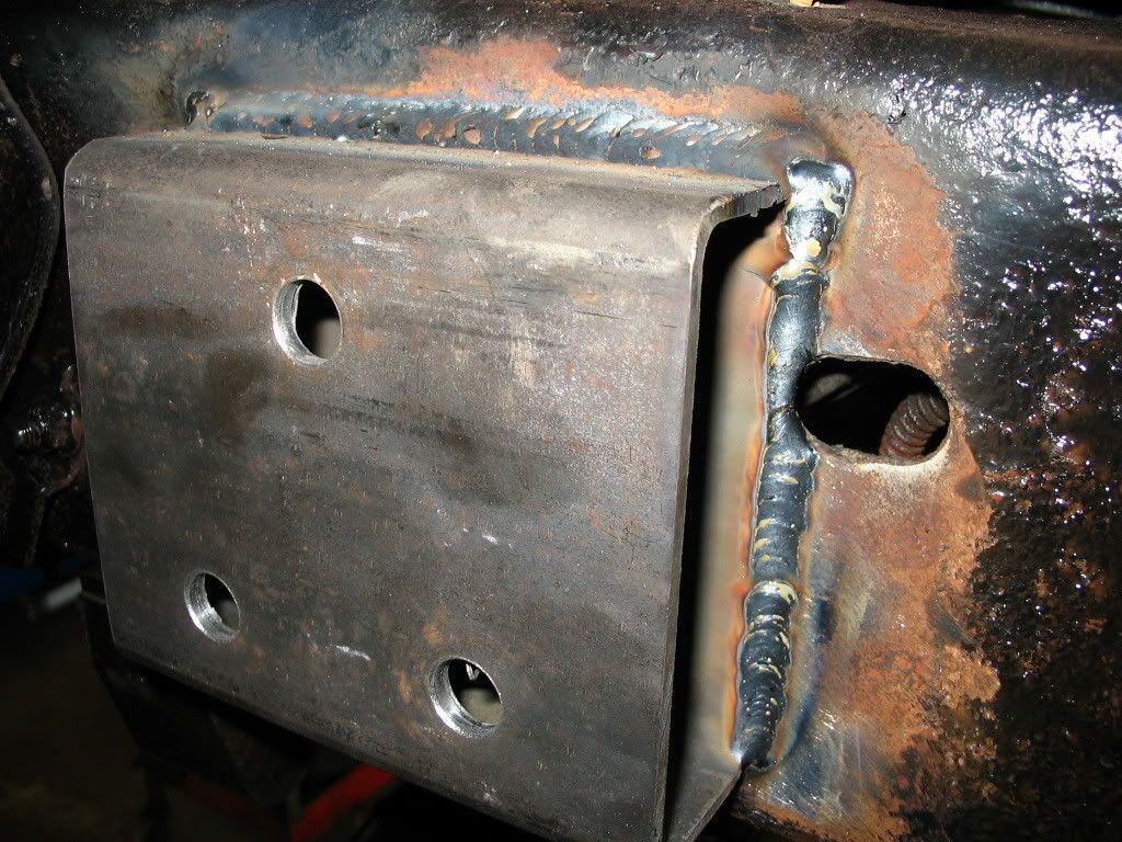

SHOCKING NEWS!
got some super duty shock mounts today.
had to mod them a lil
plus we spray bombed everything
had to drill a top/third hole in the brackets after cutting them down.
next used some 1.5"x4" steel and made some spacer/mount brackets then welded them to the frame.
finished product
cheap curb flex

Looks good bud, nice 4x4 swap.
Only critique I got is grind everything down to bare shiny metal before laying any weld.
