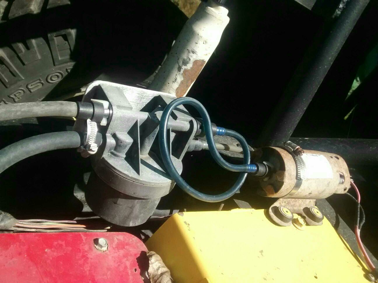

The older ranger with two fuel pumps, a low pressure in tank and a high pressure frame rail mount, had a frame mounted fuel reservoir that might solve the problem.
I use one on my race truck to solve the same problem. This particular set came from a f150. IIRC the years 1987/88 are the ones to look for, rangers too.
