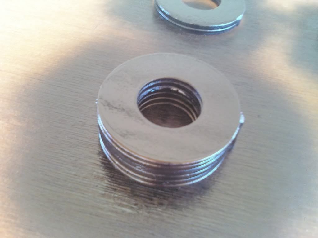

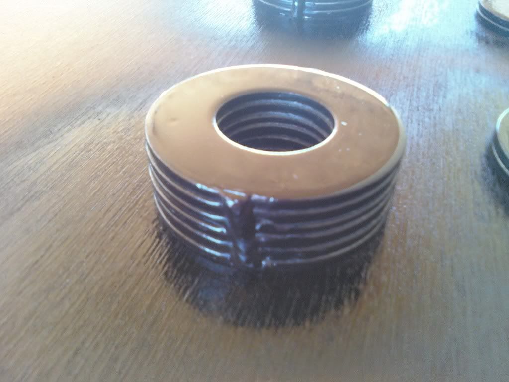

What are you planning on using for coil spacers? About everyone on here will steer you away from anything but washer stacks. I have a set ready to go into mine right now. I'm into them about 20 bucks with the can of spray paint. Here's a pic:

I only welded them because I saw a video that had them welded on youtube. I agree though, they would be fine without welding them.

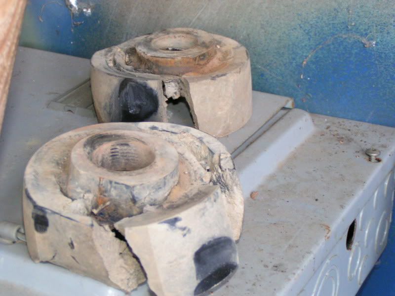

Washers are the way to go, the daystars deteriorate, and the aluminum ones crack. Don't even get me started on the rubber ones that "thread" into the coil windings.
