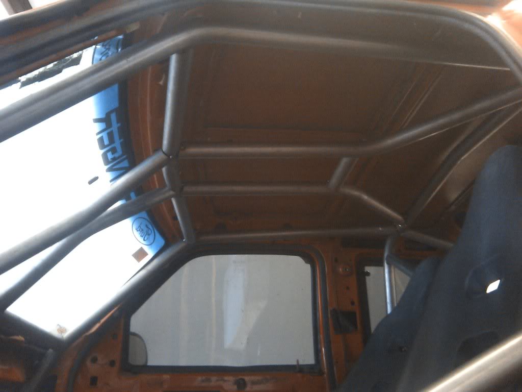

Other features include a full roll cage to protect the occupants in the event it should ever flip over. For a moment, it almost looked like the cage was going to get tested in this video:
