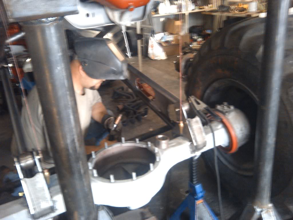

Unfortunately, you can’t just go buy radius arms for a 2.5 ton Rockwell. You have to make them. But you can buy the brackets to bolt them to your Rockwell:
The 1,000+ pound 2.5 ton Rockwell axles come with 6.72:1 gears, but Jeremy gave his the ‘mohawk’ treatment that involves trimming away the excess material on the round differential housing, and leaving only the space needed for the gear. This helps give the axle an extra 1.5-inches of ground clearance.
You can buy kits for shaving a Rockwell axle as well:
