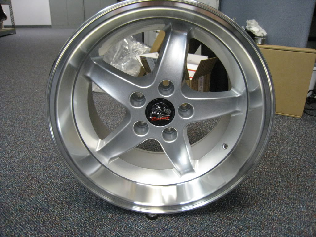

To complete the look, the Ranger rides on 10.5 x 17 (rear) and 9.0 X 17 (front) CobraR wheels with HanKook Ventus (rear) 275/40ZR17 and (front) 255/40ZR17 tires.

Wheels:
OE Wheel Fake CobraR 10.5×17 & 9.0X17
Tires:
HanKook Ventus (Rear) 275/40ZR17 (Front) 255/40ZR17
