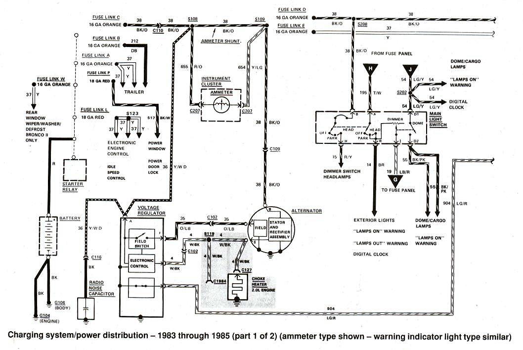

When I got rid of the dash in the old Ranger (well after the V-8 swap) and created a custom one, the alternator stopped charging the battery. I traced it back and found that when I removed the battery light (idiot light) it stopped charging. I forget how this system works, but the connection was basically needed to 'excite' the charging system to start charging.
I figured I couldn't just break the connection at the Amp guage because current flows through it.
This is the diagram for the charging sstem I have:

One wire is the sensing wire. It is downstream in the electrical system somewhere. Probably, it runs to the main power feed. It is the feedback wire and the regulator is going to try to keep it at 14.7v. If there is higher than normal resistance in that wire, the rest of the system will go above 14.7 to make that wire read 14.7.
I'm not up to speed on that external regulator charging system right now, but I would check out that yellow wire with the white stripe on the diagram. If that one has unusually high resistance, that could do it as I think it's the sensing wire.

If you notice there is a shunt or a solid wire that the amp guage is inline parallel to the shunt. The amp guage just tells you what direction voltage is flowing either into the battery or out of it. The volt meter just measures voltage at the battery. Pull all your grounds apart and sand them metal to metal you may have burnt up both regulators it dont take long to burn up all three. A bad battery can destroy the alt/reg and visa versa. Your getting voltage to the battery from the alternator check the wires to the regulator are correct and good depending on the system you are using. My 83 has key on hot to the regulator and the stator wire is terminated (not used) the field wire tells the alternator what to do. If your not getting battery voltage to the regulator B terminal the shunt was in the amp guage and you will need to connect a jumper where the amp guage was. You might be alright if you didnt run it very long without the battery wire to the regulator it is telling the alternator to run wild. GL
http://www.therangerstation.com/tech_library/EDiagrams/files/diagram_charging_1983to1985_1.JPG
So it's an external regulator alt...
I'm wondering if the ammeter shunt needs to stay inline with the circuit maybe and the wires that originally went to the cluster (R/O and Y/LG) just left open? It would appear that the "Y/W D" wire is the sense lead, so I'd certainly check that similar to how I mentioned in my above post, make sure the voltage at the regulator's A terminal is not more than the tiniest fraction of a volt less than at the battery itself.
