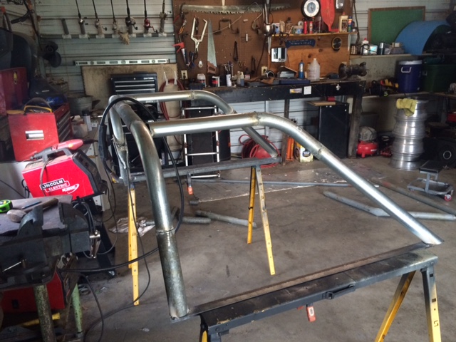

Now why I wanted a B2 in the first place........ chop the top

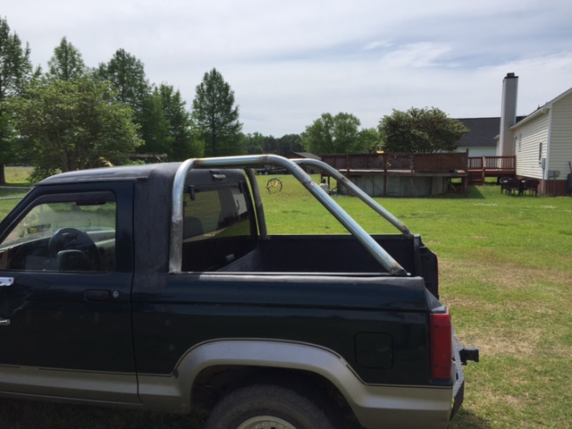

Dang! how did that happen? wasn't like that on the computer

Ok, I had a B2 in the past with an open top and hated being limited by bad weather. so this time I wanted to do a half cab version.
I wanted to be able to weld in the cab so I got a rear hatch off an explorer and mated it to the cab of the bronco.

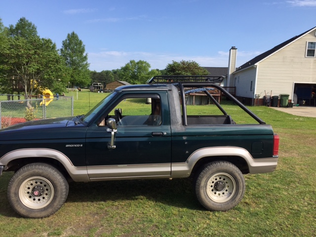

I used the sheet metal from the chopped top to finish off the bottom below the window and get the fit I wanted.
The other nice thing about this is the rear window opens and a couple of screws, it come off and the cab is almost as open as the last chop job.

The interior mostly finished. Still need to get a molding for the hatch. The one I had got broken laying around in my shop.

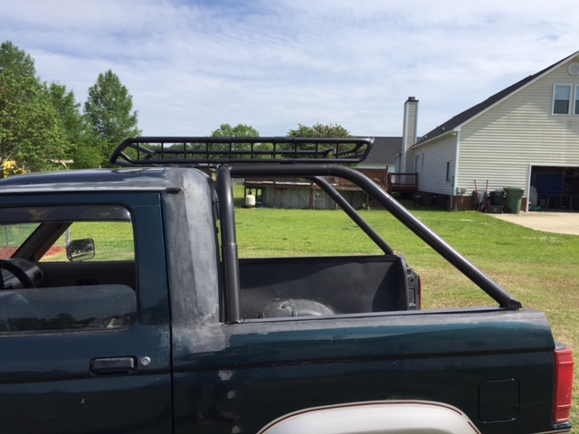

Now to finish off the bed. I made inner bed walls to give it a more finished look and add strength to the rear fenders. I still have to bed coating on it but I have a few more odds and ends back there before I do that.

Im learning body work as I go but its getting there.
Next will be the expedition rack and suspension. May have to wait a little, time to enjoy the weather and water so the bronco my just get driven like it is til fall....but who knows:icon_welder:
