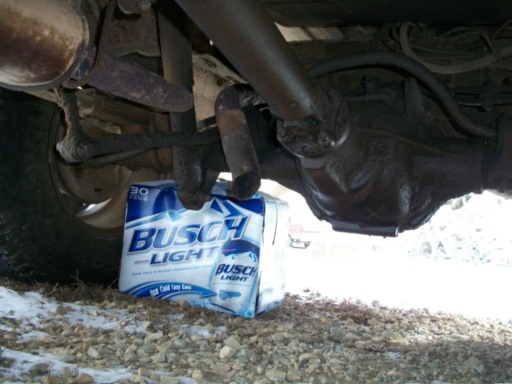

Rear axle & broken tail pipe
[IMG]http://imageshack.us/photo/my-images/809/1002612y.jpg/[IMG]
[IMG]http://imageshack.us/photo/my-images/27/1002613h.jpg/[IMG]

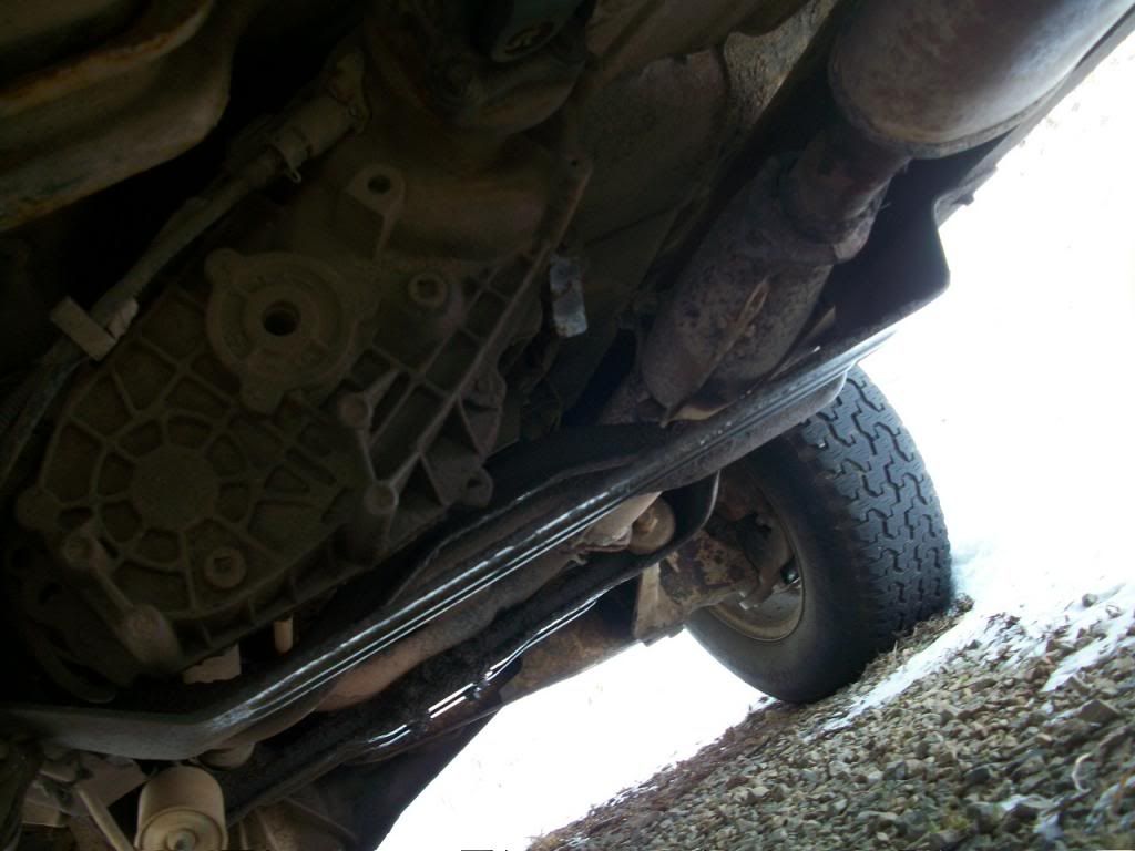

Bottom of Transmission
[IMG]http://imageshack.us/photo/my-images/829/1002618s.jpg/[IMG]

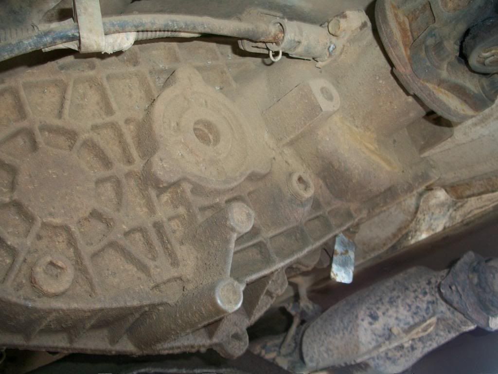

Transfer case
[IMG]http://imageshack.us/photo/my-images/138/1002608f.jpg/[IMG]
Any help on the Front and rear axle please.

If after 11/89, it is a 90 model. Should have a 1354 t case and a Dana 35 front end. It will have a 7.5 rear.

Can you post a pic of the front of the t case?

Will remove the transmission and transfer case soon or today so i can take better picture For everyone. sorry about the crappy Pictures.

The pics are fine. It looks like you have a D35, if you have a fixed yoke on the front of your t case then its a 1354. If its a slip yoke its a 1350.

Back to your original post.....the rear dana35 is used in jeeps, I don't think ford ever used them. The front dana35 is what's called a twin-traction beam (TTB), which is what it looks like you have.
