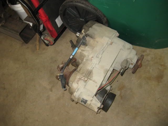

For what its worth, I think I’ve narrowed down my cooling problem to the fan clutch. Once that fan kicks on, it cools it down just fine, but it doesn’t seem to want to engage soon enough. Which is annoying as I just replaced the damn thing. When we get back, I'm just going to go E-fan and forget about it..
In other fun news, I finally found a manual transfer case! I’ll swap this dude in sometime after our trip up to the northwest:
But its missing a piece of the linkage, anyone have the little lever laying around they don’t need. It goes on this shaft:
Worst case, I can make my own if I have too, but if someone has the linkage (1350/1354 will work) please let me know. I also got my new front springs in, so look for an update on that here shortly…

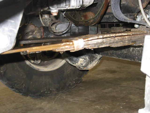

Swapping out the front springs
When I bent my front springs, I tried to find a replacement OEM type pack. After a little searching, I was seeing nothing but good things about BJ’s off-road. Unfortunately, they wound up being a wee bit irritating. I’d placed my order on 8/2/11 via the interwebz. One week later, my order was still ‘pending’. Several phone calls later (and lots of, “we’ll ship them now!” phone calls). I wound up canceling the order when they finially told me that they wouldn’t have the springs for at least another 1.5-2 weeks (Found that out on 8/11/11). Rather frustrating to say the least...
With the power of Google, I came across Team Grand Wagoneer, they had another set on the shelf, and it was beefier than the stock 7 leaf waggy pack I was using. As an extra bonus, they showed up two days after ordering them!
So after doing this to the stock 7 leafs:
They were looking like this (The other side was looking over taxed as well. Keep in mind, about 1,000 lbs over the curb weight of a Grand Wagoneer):
The New springs are waaay thicker than the old ones, so I've got more hope of these lasting a bit longer:
While they're stock height springs, they netted me about 1.5” of lost lift in the front (even after putting some road miles on them). They sit were the used 7 leaf pack sat prior to me destroying them The truck sits pretty close to level at this point.
I was worried that they’d give me a poor ride, but its actually pretty nice still. Not quite as soft as the 7 leaf packs, then again, I’m not hitting the bump stops as I cruise down the highway anymore
I also welded on some ‘anti kickback’ stops for my front shackles. In the end, I think I’m going to make my own boomerang shackles, but these will work for the time being.

whats your pin to front eye measurement on those springs?
i was planning on running the expo rear leaves up front but they arent going to work like i want. just trying to figure out what im going to run.

I see this ending badly with those shackle stops.
I'll get that measurment for you tomorrow, but you might want to look into getting YJ springs instead. They're dirt cheap, and you can get them mil wrapped. Look into BDS springs as they have a no questions asked warntee.
There just isn't as many options out there for the Waggies, and If I didn't allready have everything setup for the Wagoneer springs, I'd jump ship over to the YJ junk.
Care to elaborate?
Function wise, its accomplishing the same thing as the boomerang shackles. The way these are set up, they are spaced about 3/16" away from the shackle at full droop (Droop is being set with the limit straps). They shouldn't see much of any force against them, and with the thicker springs, I'm not entirely certain they're actually needed. But I wanted something there to help keep everything in place while I'm running around the backwoods of MT :icon_twisted:
Or am I completely missing something?
