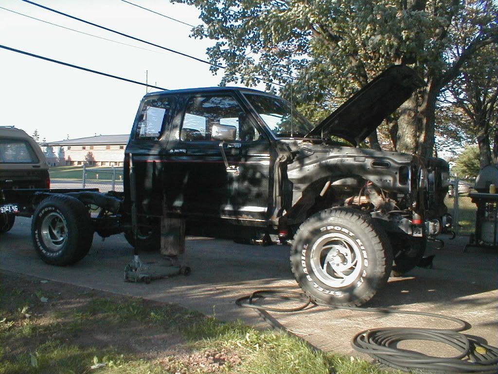

After stripping the truck down to the frame, I slowly began the rebuilding process. I removed all the rust from the frame with a needle descaler as my siphon feed sandblaster didn't want to do much to the heavy scale rust that had built up everywhere due to the truck living its entire life in the Upper Peninsula of Michigan and its salt road winters. THAT took quite awhile. Once the frame was relatively clean, I coated it with Corroless Rust Stabilizer to neutralize and encapsulate any remaining rust. I coated THAT with Eastwood Co Chassis Black and coated THAT with a spray on rubberized undercoating. I also coated the entire bottom of the box, the cab and the inside of the fenders in the same manner.
I had my brother (he owns his own repair shop) remove the stock 3.45 gears and open differential and replace them with 4.10s and an Auburn Gears rear limited slip. This was the only work to the truck that was not done by me. I knew that installing ring/pinion and getting a good mesh pattern can be tricky, so I let him handle this. With the 32x11.50 tires I planned to run, I calculated that running 4.10s would put me right back into the stock RPM band. Plus adding the limited slip would definitely help in winter up here. Since I didn't plan on doing any real off-roading other than going to camp once in a while, I installed the rear anti-sway bar from a BII to help reduce body sway on the highway. I realize that the hard core members among you just cringed after reading that, but it's what the truck is built for. Mostly highway/town usage with occasional off-road adventures.
With that out of the way, I decided to replace a lot of the rubber bushing with polyurethane. So out with the old and in with the new spring bushes, swing arm pivots, sway bar bushings and body mounts. I also rebuilt and beefed up the body mounts so I wouldn't have to worry about them rusting out ever again. I debated going with a 4" suspension lift, but decided that a very moderate body lift along with Bushwacker fender cutouts would give me the look I wanted without raising the trucks center of gravity. So I cut down a 3" body lift kit into 1 1/2" and used that.

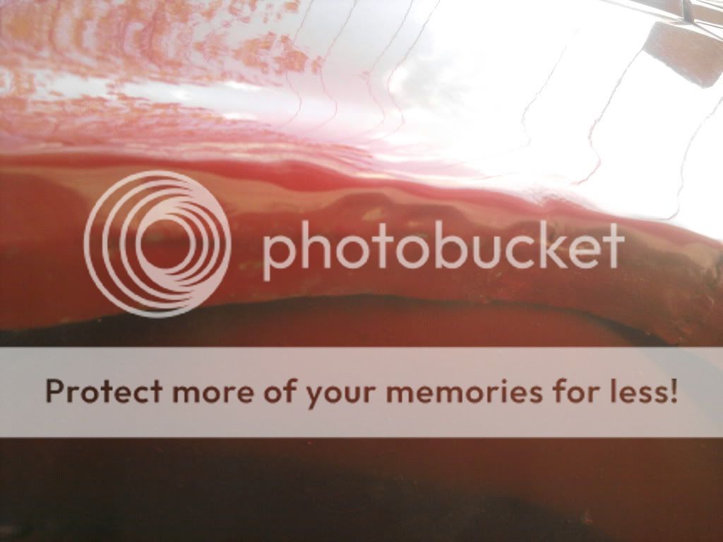

Since we ended up with some dust in the paint on the hood and roof, I decided to wet sand and buff them. BIG MISTAKE! Not because I screwed anything up, but because they turned out GORGEOUS! I could NOT BELIEVE how nice it looked!
For now, the only things wet sanded/buffed are the hood, roof, visor and fastback. Although I suspect that at some point the remainer of the truck will get the same treatment.

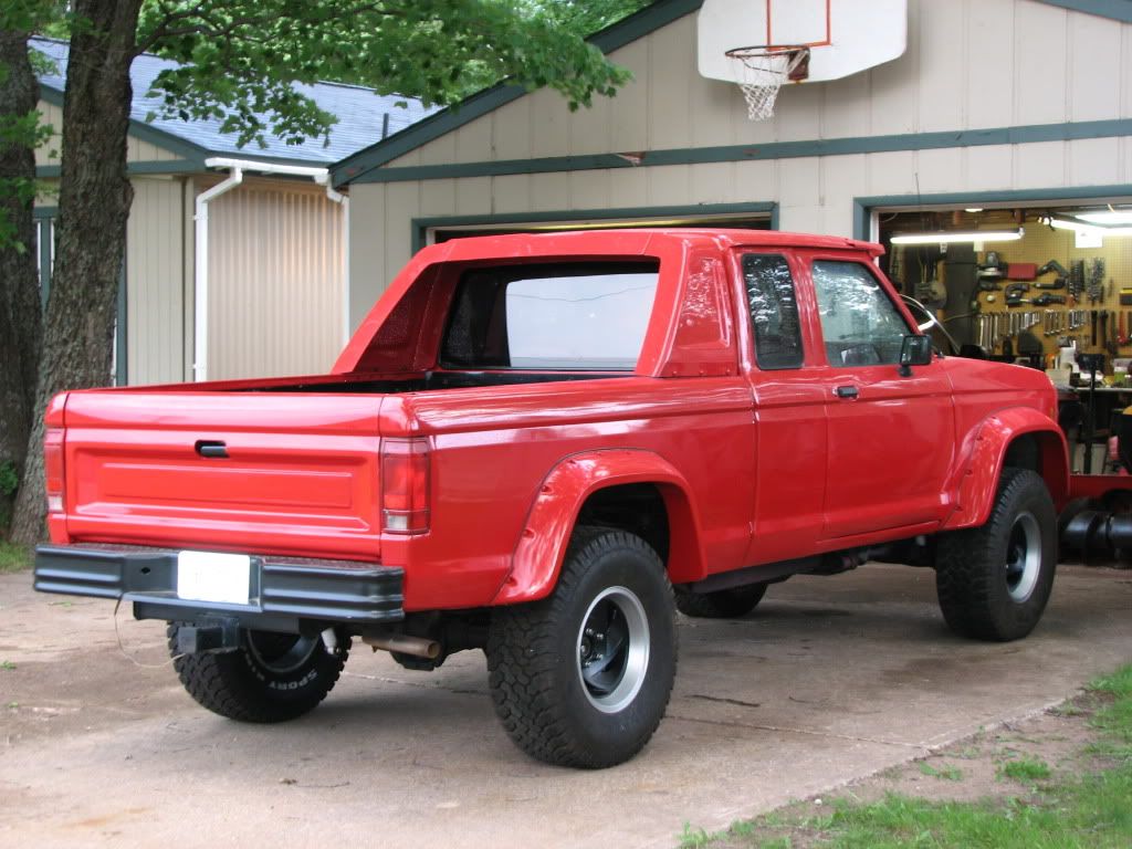

Which brings us up to the present and the fender flares. I got one installed yesterday as it took much longer than expected. I'll try to shoot for one each day after work assuming time/weather cooperate.
And now you're up to speed on the last eight years. I figured it was close enough now that I could post it here and keep interest. An eight year build would probably have bored most of you, so now you can watch as I struggle to finish this up and get it back on the road.
Today's update: Installed the left rear fender flare. It went a lot smoother than the front did. Probably because I didn't have to deal with the inner fender well and because I'd worked out the easiest way to install it. So now the left side is done. I won't get to work on it tomorrow as I'll be busy all day at work. Hopefully by the end of the week I'll have both right side flares on as well. It looks a bit funny right now with the stock tires. Hopefully the 32x11.50s on the 8 inch wheels will fill the wheel wells a bit better.
And here are a couple of pics of the interior showing the white faced gauge kit, the tach with matching white face kit and the buckets/console.
