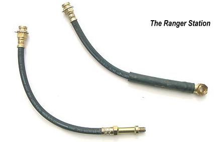

The first photo below shows the two individual hoses:
Longer brake lines

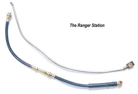

The second photo shows the two hoses connected next to the old aftermarket braided hose:
Skyjacker stainless braided brake line vs part store brake line
Parts store extended brake line
(Photo by ‘crawlin91’)
The new lines shown are ‘Brakeware’ that I bought from Autozone.  Their part numbers are listed below along with a cross reference to other manufacturers part numbers.
You need (2) hoses from each list below to assemble and make (2) complete brake hoses:
Manufacturer Part #   Manufacturer  Part#
Brakeware 77226 + Brakeware 88291
Wagner F106887 + Wagner F43757
Bendix 77226 + Bendix 88291
Raybestos BH3684 + Raybestos BH36593
So, the 77226 gets connected to the 88291 to form (1) hose. Repeat for the other side.
The #77226 cost me $10.00 and the #88291 cost $9.00.  At that rate it costs around $40.00 to do both sides.  The positive note would be that you could get the hoses from any parts store and could only have to replace 1/2 the line if you broke one instead of having to buy a new set from a suspension manufacturer.

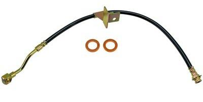

A One-Piece Hose Replacement – A Better Way
Submitted by Bob:
These hoses are 26″ long:
Manufacturer Part # Manufacturer Part #
Brakeware 70053 Brakeware 70054
Raybestos BH38622 Raybestos BH38623
Wagner BH120541 Wagner BH120542
There are (2) numbers because there is a right and left side. Unlike the hoses above, these do not have to be pieced together.
Get the right and left brake line for a 1995 Chevrolet Truck K2500 3/4ton Suburban 4WD 7.4L TBI 8cyl.
Rock Auto lists these hoses fitting:
MAKE MODEL YEAR
CHEVROLET K2500 PICKUP (1989 – 1995)
CHEVROLET K2500 SUBURBAN (1992 – 1995)
CHEVROLET K3500 PICKUP (1988 – 1995)
GMC K2500 PICKUP (1989 – 1995)
GMC K2500 SUBURBAN (1992 – 1995)
GMC K3500 (1988 – 1995)
Brakeware extended brake lines
70053 brake hose
Brakeware 70053
Brakeware 70053
Brakeware 70054
Brakeware 70054

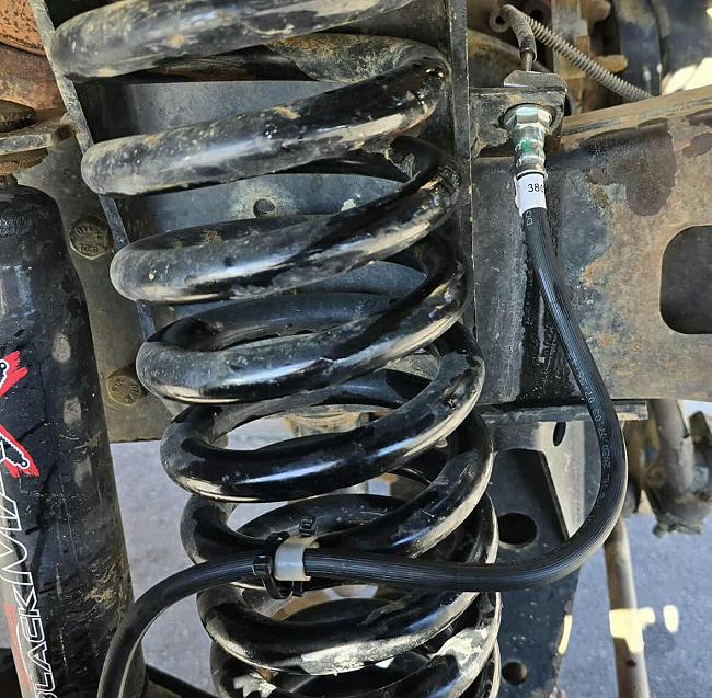

Extended brakeware brake hose on Ford Ranger
(Photo by ’89PBR86′)
Chevrolet brake line on a Ford Ranger
(Photo by ‘Curious Hound’)
