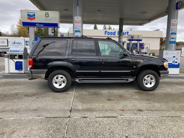

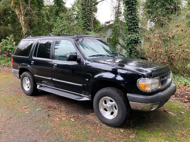

Battered but spirited, 225k miles, gray leather, sunroof, about as close to stock as I could find. Generally pretty straight with the usual bumps and bruises for it's age.
It has one of those vibrations somewhere up front that you can't really tell if you're feeling it or hearing it. Under power only, not during coast or deceleration. My friend did wheel bearings, CV joints and brakes trying to find what was making the noise. I was thinking maybe pinion bearings but the seal isn't leaking and I don't get any excess movement there. Over on the Explorer forum the signs are pointing towards the Front Driveshaft rear CV joint. It could also be the output bearing on the Transfer Case.
It's also had a new Water Pump and Battery recently. My friend's daughter's family was driving it until the stork paid them another visit and they needed something bigger.

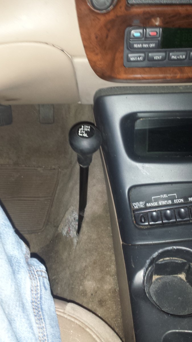

There's only a few junkyards around here anymore too, sometimes you luck out and others not... When I got the parts to do my '00 back in '16 I don't remember everything that went on but I know I got one of the drivelines from craigslist, thought I got the T case from there too but maybe not... when I got the parts for my '98 I lucked out and found everything I needed at the same junkyard on half off weekend... they're still "in stock" as I haven't gotten that far yet... I just looked through my pictures and all I have is this one of the shifter and none of the gas tank bracket... as you can see it's just up against the console, at that point I didn't have a passenger motor mount so it was a little further over, it's within 1/4" now that it's attached properly... On the tank bracket it's just the last like inch that gets in the way, if it's not raining tomorrow night I can probably get you a picture, I took it off to modify but it shouldn't be necessary.

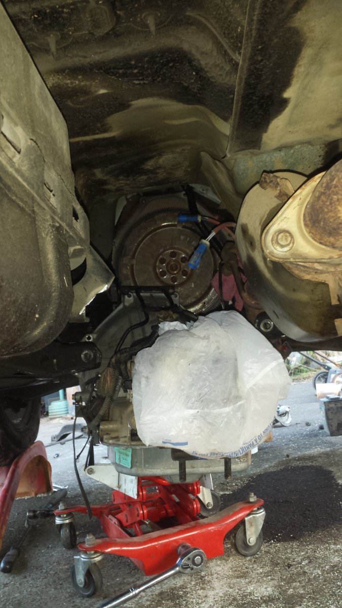

EDIT: I take that back, I looked at a couple more pictures and I found one... in this next pic you can see my sharpened beaver work of cutting the corner of the gas tank bracket, I think that's all I did but maybe took some channel locks and bent it up a little... that was shy of 9 years ago so details are fuzzy... I know it was in my asphalt driveway so that wasn't ideal...

Thank you for those pictures!! Does that TC lever bother your leg at all when driving, or is it mostly out of the line of fire?
