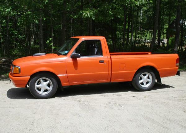

From 19Walt93: 1995 Ford Mustang 16’s on my 1993 Ford Ranger work with 235/65 tires. Steering rubs on lower shock bolts, so I added stops. Spacers would make it easier.
1993 Ford Ranger with 1995 Ford Mustang 16-Inch Wheels
(1993 Ford Ranger with 1995 Ford Mustang 16-Inch Wheels)

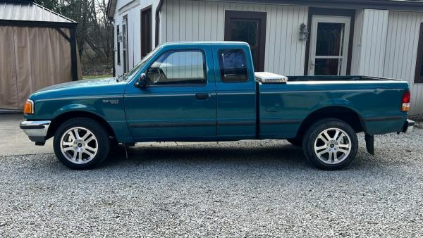

1995 Mustang Cobra 16×8 Wheels
Contributed by veefer800canuk: 235/60-16 front and 255/55-16 rear tires on 16×8 Cobra wheels. Front spacers and ET-style lug nuts helped fitment. Center bore matches Ranger (70.3mm).
wheel spacers
Lugnuts
1995 Ford Ranger with 1995 Ford Mustang Cobra 16x8 Wheels
