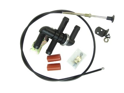

I found a cable operated one....im wondering if i can rig it up to the factory controls...
I used this exact kit in my 88. Its a non-AC truck so anything I can do to remove heat from the cabin helps. Having a 200* chunk of copper/aluminum in the dash whether air is moving across it or not isn't ideal in the summer...but mornings like this morning when I came out to a heavy frost, its nice to just pull the knob and have heat when I need it.
Not the best picture of it, but I did the install when I replacing the leaky heater core. It made it pretty easy to sneak the cable through the firewall with one if the heater core barbs. I think I just drilled a 1/4 hole in the HVAC plenum with a long drill bit from the engine bay side while the core was out. I put thick heat shrink arounf the cable so it wouldnt rub the heater core tank.
I will look for pics of cable routing...I did it during my hiatus from documenting stuff
