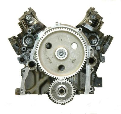

The Ford Cologne 2.8L V6 is a 60° cast iron block V6 engine built by the Ford Motor Company in Cologne, Germany. The 2.8L engine in the 1983-1985 Ford Ranger and 1984-1985 Ford Bronco II is the same design as the 2.8 V-6 used since 1974 in the Ford and Mercury Capri vehicles.  A unique feature of the 2.8L is the timing gear vs a traditional timing chain (See picture below).
Ford 2.8 timing gear
(Ford 2.8L – Timing Gear Shown)
