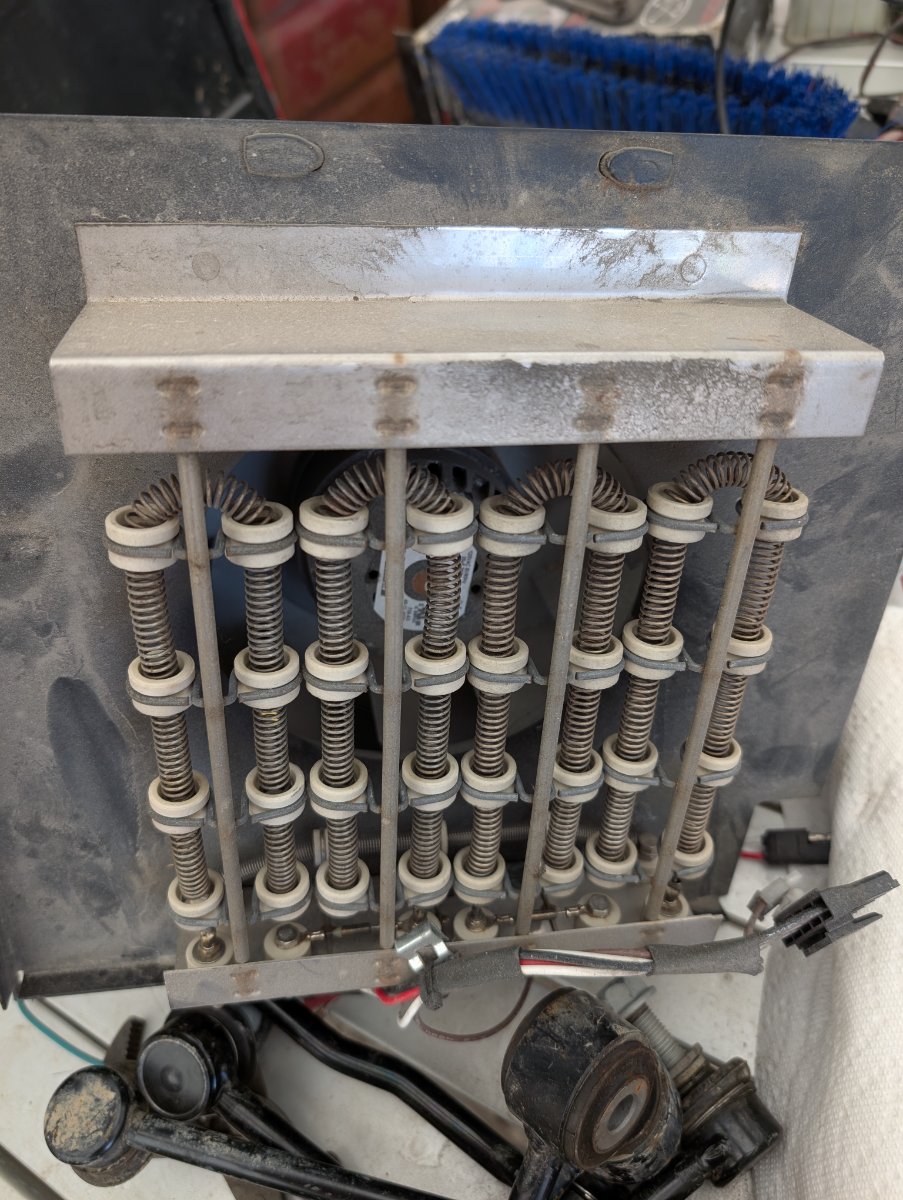

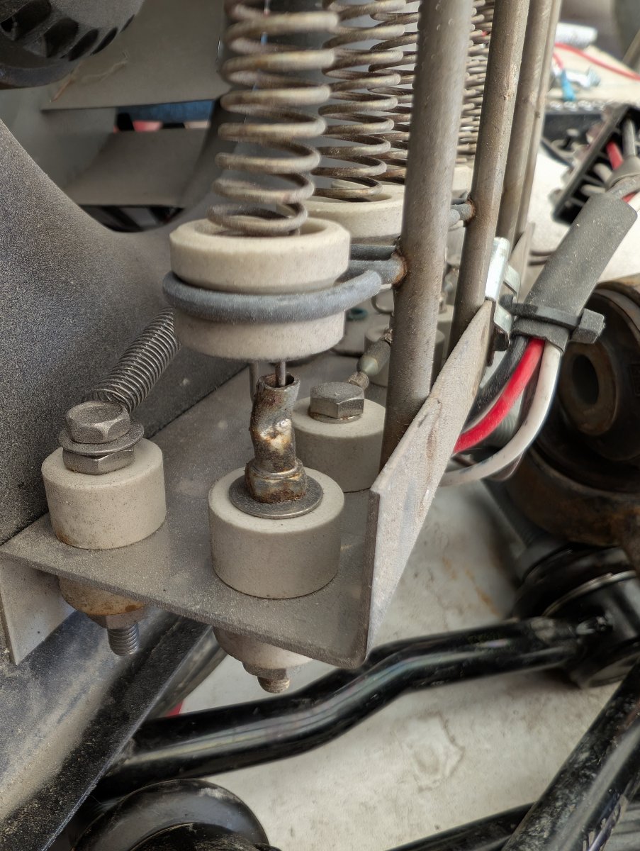

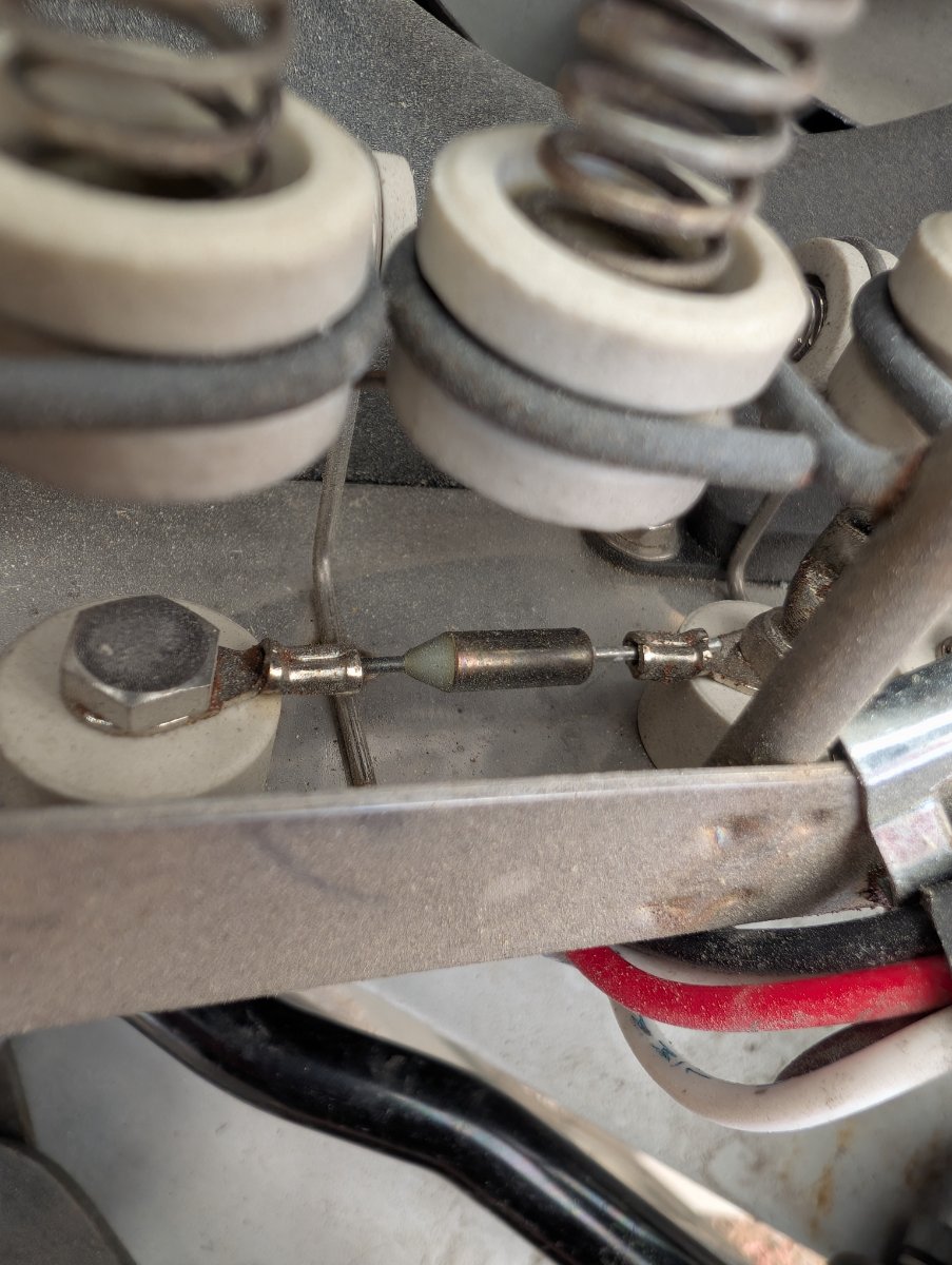

I finally remembered why I saved the heater coils from the dumpster. Some type of special metal that I don't remember the name of. I want to try making my own bolt buster... It will be a steep learning curve as I've never used a tig before and I don't know if the metal is weldable anyway.
Edit; looks like factory used crimps. I have crimps..

Ya know. The whole idea behind the induction heater is that the coil is NOT a resistance heater made of nichrome. It works by inducing eddy currents in the metal you stick in the center. Tje eddy currents react with the natural resistance of the material itself to create heat. The coil itself is very effective made of copper.
