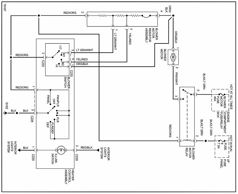

When working with your blower motor you have to first understand that the blower basically works in the opposite manner of most automotive electrical components. Normally you switch on a positive current to an electrical component to turn it on. The power passes through the part and then to ground to complete the circuit.
With a blower, you essentially ‘turn on the ground’. The blower always has a positive current going to it when the key is on. You turn the blower on by completing the circuit to ground.
Diagrams
Diagnosing Blower Motor Problems - Wiring Diagrams
You can open this diagram in a larger file by clicking HERE
