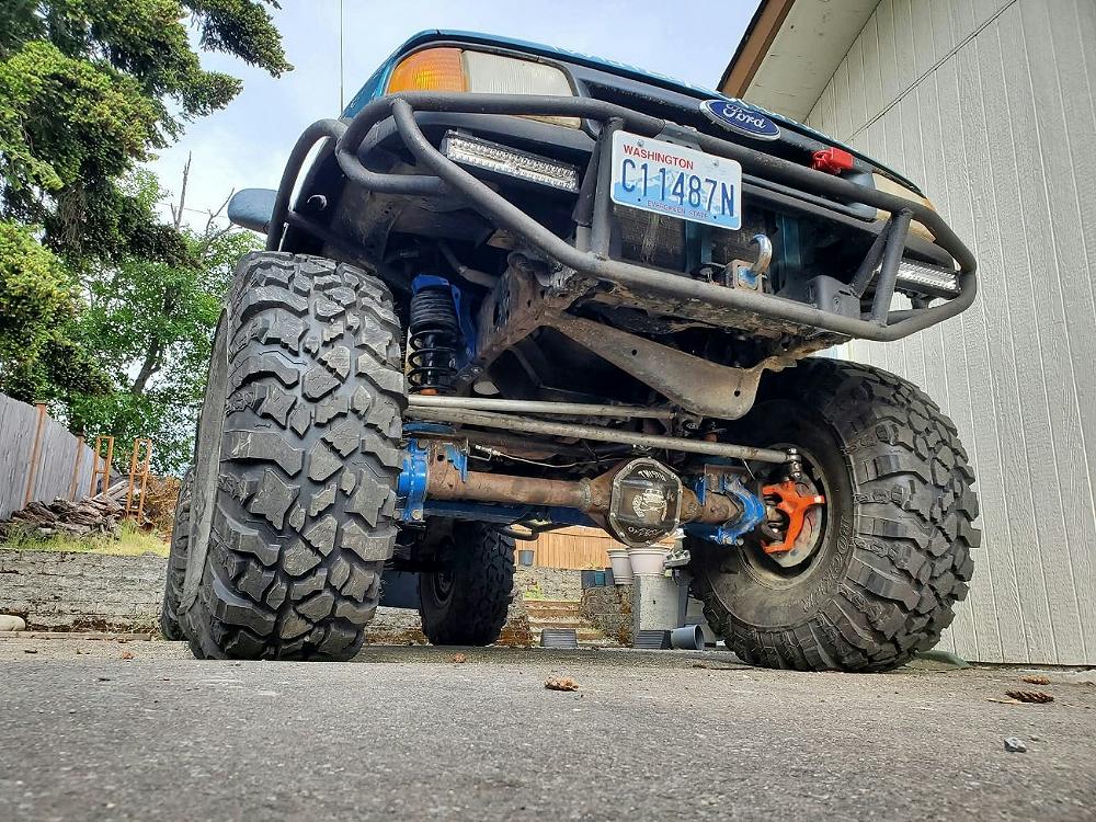

Dana 44 Solid Axle Swap (SAS)
The Dana 44 is the most popular solid axle swap done on the Ford Ranger with the 1971-1977 Ford Bronco Dana 44 being the most popular axle choice. The reason is that the Early Bronco Dana 44 has a 58″ width which matches the Dana 28 TTB. The problem with these axles is that they have a 5-260 U-joint which is smaller than the Dana 35 TTB, and only the 1976-1977 axles have disc brakes. There are companies that make replacement axles that use the larger 5-760 U-joints.
The other choice is the 1976-1979 F-150 or 1978-1979 Bronco Dana 44. These will give you disc brakes and 5-760 U-joints. The problem you’ll run into with the full-size axle is that the coil spring spacing on the axle is roughly 6.5″ wider than the Ford Ranger coil spring spacing. To overcome this, you need to either move the upper coil bucket further out, move the C-wedges on the axle inward, or a combination of both. Other options include using coil overs which don’t have to sit perfectly vertical like a coil spring does or narrowing the Dana 44.
Both of these axle choices use a radius arm and coil spring setup but will need a trac bar to control lateral (side-to-side) movement of the axle under the vehicle. This will require a custom trac bar mount, or a James Duff trac bar mount.
Speaking of coil overs, you can build a whole custom link suspension with coil overs and not use any stock suspension components, but I suspect if you’re considering that you’re beyond needing any of this information.
Finally, I’ve seen people choose to simply mount the front axle with leaf springs instead of coils.
