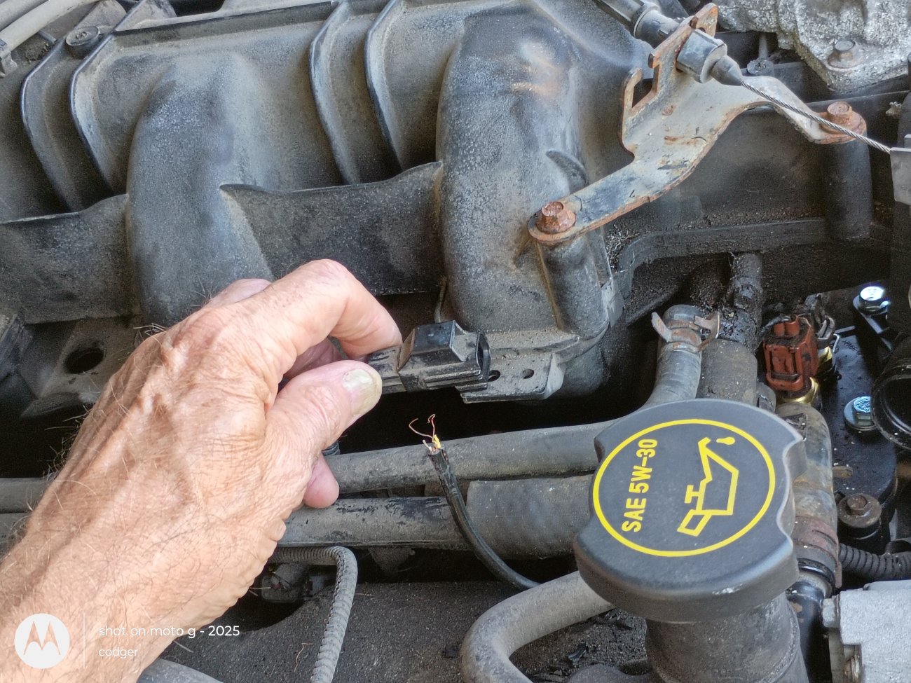

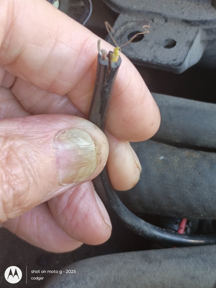

I started this project over 3 months ago but illness and weather took up a great deal of that time. So, an update and a new problem. After removing the radiator, I was able to get the water pump off with the clutch and fan attached. I clamped the pump in a vise and was able to get the clutch off. I've now got the intake manifold (don't ask), throttle body, therm. housing, water pump, radiator, and alternator all reinstalled. My problem is I somehow broke a couple wires off a connector attached to the intake manifold. Probably while removing the upper radiator hose. It's attached to the right (passenger) side of the manifold (see pic). Do any of you know what these wires go to? There are 2 small wires encased in a heavy rubber coating and I'm thinking it may be easier to run new wires than try to cut off enough of the casing to splice in another connector.

4.0l not my specialty. My guess is left rear stereo speaker.
Plug for the knock sensor I believe. The sensor is under the intake manifold in the valley.
Thank you. I guess that means it isn't the left rear stereo speaker wires. :ROFLMAO: That's too bad, since my radio smoked a couple of years ago and I have no need for the speakers. I guess I'll just go ahead and splice the wires because I have no interest in removing the intake again, though I'm sure the engine would run fine even if I didn't even hook it back up. Thanks again.
Atlas if it doesn’t run well you have someplace to start. 🤷‍♂️
I actually found a male plug at a chain auto parts store that would work with the female Ford plug still on the truck. Got it spliced in and everything reassembled. Tomorrow I plan to refill all the fluids and make sure everything works as it should. I'm pretty confident it will. Found something that really surprised me in the Haynes manual. they actually list a torque spec for attaching the fan clutch to the water pump, 30-100 ft-lbs. So, I figured out a way to do it. I have one of those hand held luggage scales like they sell online that I use to calibrate all my torque wrenches. I just hooked it to a 36mm wrench to tighten the nut. So, it's only taken me 3 1/2 months to do a job that should have taken an afternoon, or weekend at the most. In my defense though, I didn't let it cut into my fishing time. :giggle:
