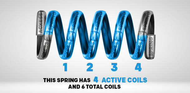

How Can I Calculate the Spring Rate of a Coil?
If you have a coil spring and don’t know what it’s spring rate is, you can calculate it once you know:
Coil Spring Wire Diameter (CSWD) – How thick is the coil wire? The number must be entered as a decimal. To convert a fraction to decimal, click HERE.
Number of Active Coils (NOAC) – Coils that are free to move, not the coils seated. It may be that 1/2 of the top and bottom coil is seated causing a spring with 8 coils to have the distance of 7 free.
active coils in a coil spring
