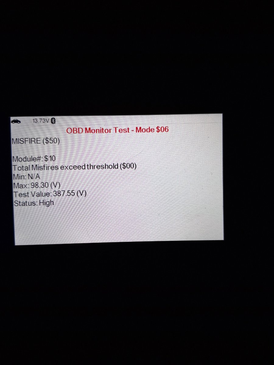

Codes im getting are for "primary control circuit open/short"...for cylinders 4/5/6/8. One cylinder (4) on pass side bank, 3 on the drivers. For some reason cylinder 7 seems immune...despite its bank mates going crazy.

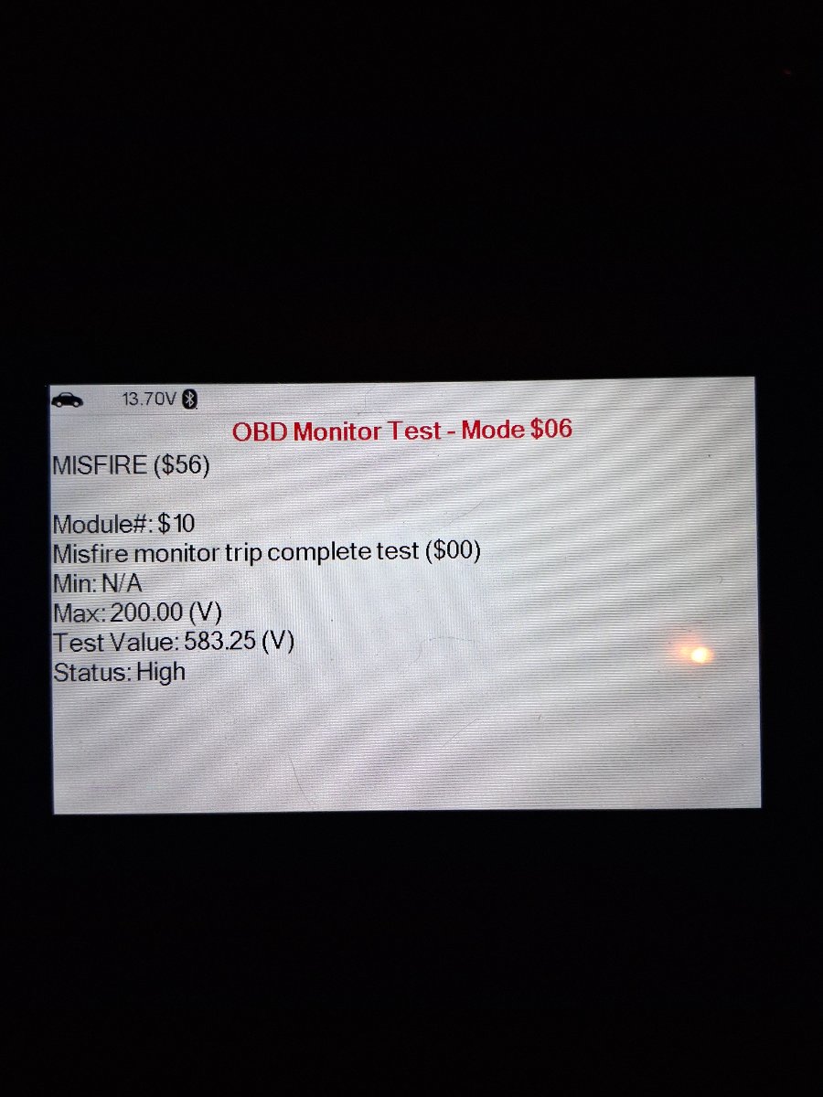

Also...here are some missfire counters that i have no idea about...
According to the google one of those usually indicates a random/mutiple missfire the computer cannot pinpoint...
So why am i getting specfic codes?

so the heavy load should be recordable. what is that you posted pictures of? can it record the drive cycle and see what it is doing like hp tuners?

Mode 6 is a Forscan thing

I dont think so. Its a maddox md14 scanner from harbor freight. The reason i was wondering about the shudder is it would go away as soon as you hit the OD off button. Thats why i figured it was trans and not motor.
