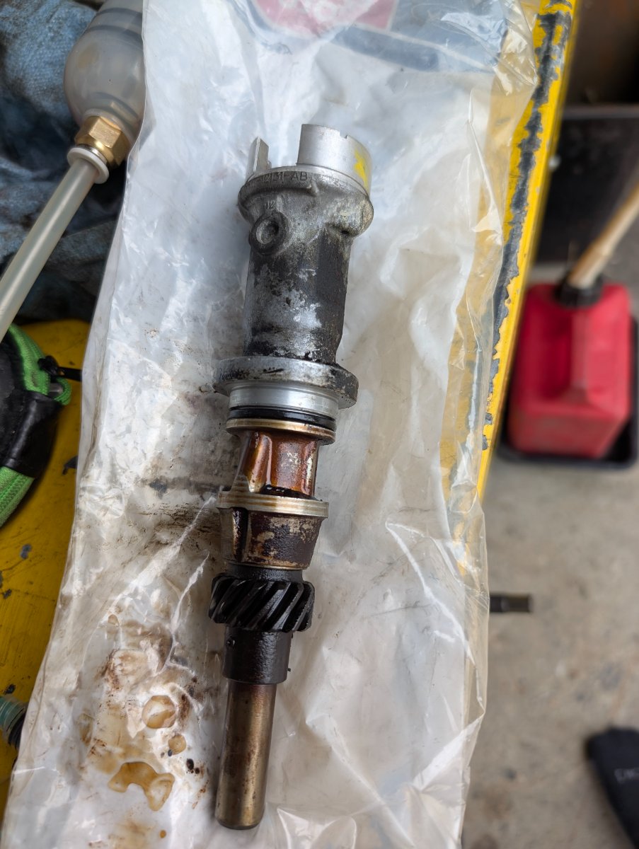

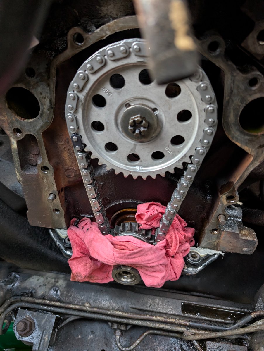

Check for coolant staining on the front left and right side of block/timing cover. If it's chalky white, the timing cover probably leaks coolant. Also the cam sync can wear and loose oil pressure. People say it squeaks and howls when it's going bad, but I changed mine before it did anything.

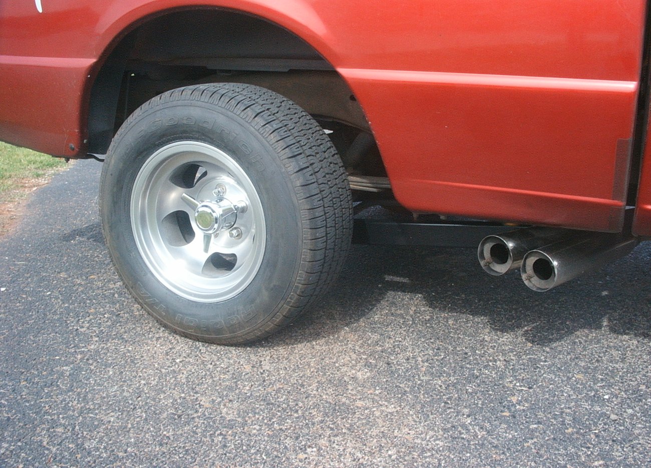

My 98 only has a four speed auto. And yes, I swapped in 4.10 gears back in 2020. Makes it a bit more fun to drive.
I've also installed those James Duff "drag bars" which eliminate axle wrap. The shifts are smoother and more "instant."
Very good. No doubt you've noticed those smoother shifts. Nice wheels, by the way.
