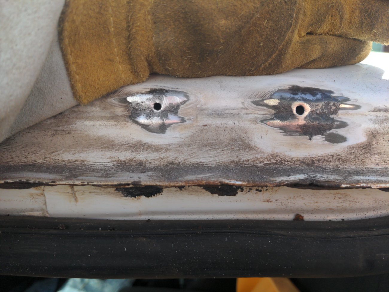

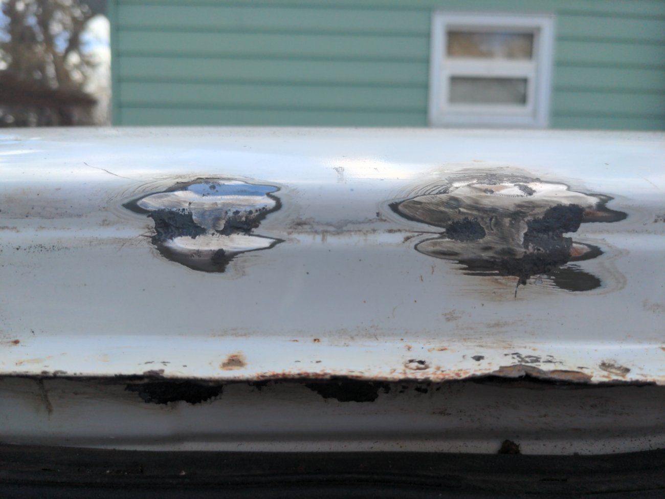

A bit of a bodywork saga, but I'll keep it brief. I had what I thought was a paint chip rust bubble situation right at the top of the topmost door seal. Turns out, someone had mounted something to the roof with 4 holes, 2 on each side, just below or right at the edge of that seal, then when they removed it, they just filled the holes with silicone.
Anyway, when I peeled off that piece of weatherstripping (which grabs the seam between the roof and the cab body) I found that that seam has been marinating in salt water for who knows how long... a serious amount of rust.
Upon removing that weatherstripping from both sides, I could see that there was _some_ sealant right at the top lip, but it wasn't really doing anything in my case, either because it failed over 20 years, or more likely, when they peeled off the weatherstripping to drill those holes, they basically broke the seal and it never sealed properly after than. And that led to both sides being permanently wet.
So here's my question. It looks like the very top edge of that piece of rubber has a flat spot that's meant to be sealed to the body of the truck to prevent water ingress. Is this the case? Because if not, I can't see how water doesn't just creep in there and soak that seam around the roof panel.
Assuming that's the way it's supposed to be, anyone know what the proper sealant for that is or have any good suggestions for a substitute? I'll try to attach a couple pics soon in case I did a poor job explaining. It's that top piece there, you can see the holes right where the top edge of the rubber sits.

Not a bad idea. Lucky I have a welder on hand so I was able to fill the holes. It had actually gotten pretty bad and there was a fair amount of paper thin steel around those holes after all these years, but luckily that all evaporated as I tried to weld it. 😂
Oh, the steel looks pretty ratty but I wire wheeled it aggressively and poked it with a pick and couldn't break through so as ugly as that is, it got a coat of bondo and a few coats of paint at 0C. That's what we call "Canadian bodywork". I'll _definitely_ do that properly this summer. 😂

Nice job welding that thin steel!
Thanks. I have a bit too much experience chasing thin steel across a hole if you know what I mean. I'll probably have to go back and make some proper (steel) patches in a year or 3. I'm just trying to save my $30 junkyard headliner. 😆
