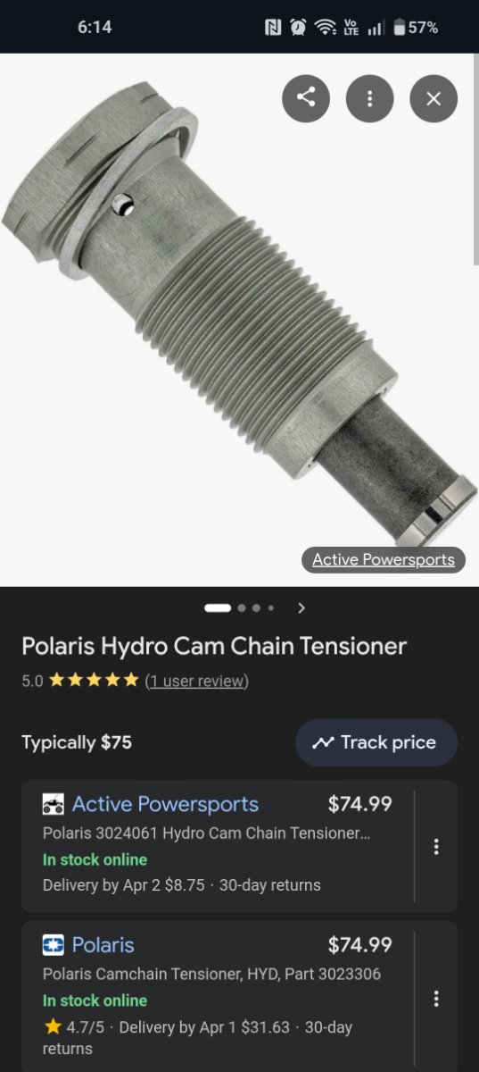

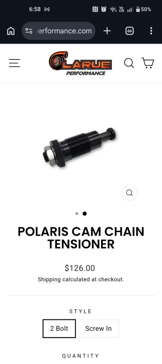

If I'm not mistaken, I read something months ago that some Polaris maybe side by side or atv uses the same tensioners and they make manual tensioners for it that you could use in your Ford. I could be way wrong on that but I could swear I read that somewhere.
Either way, for as little as they need changing I'd just use OEM tensioners and call it good. I think they have improved the quality of the tensioners since the early days when they were notorious for failing early
I couldn't help it I had to check if Polaris actually used these kind of tensioners. I guess it's from the Polaris Slingshot which has an inline 4 engine
Timing Tensioners - Do Manual options exist?
Actually, the OEM tensioner is mechanical (manual?). It has a spring that provides tension at startup until oil pressure builds to provide tension. It looks like the Polaris is also an oil pressure tensioner. It is called a hydro chain tensioner.
I would not use a tensioner designed for another engine. Too many things could be slightly out of spec and create all kind of problems.
I wasn't suggesting to use a Polaris hydro tensioner in his engine. He asked about manual cct's which they make for the Polaris but allegedly fit the 4.0 SOHC. Theoretically, if it screws in, seals and has enough "adjustment" to tension the chains correctly it would work fine. Ive read that some have used them but I wouldn't try it. And they aren't any cheaper than OEM
