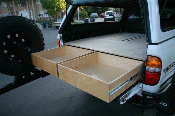

Yes, it’s not a Ranger, but the photo above shows a platform that uses (2) drawers in the rear instead of an open space and plastic bins.
