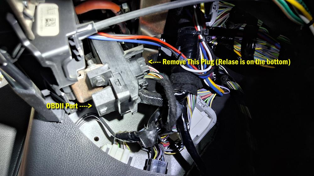

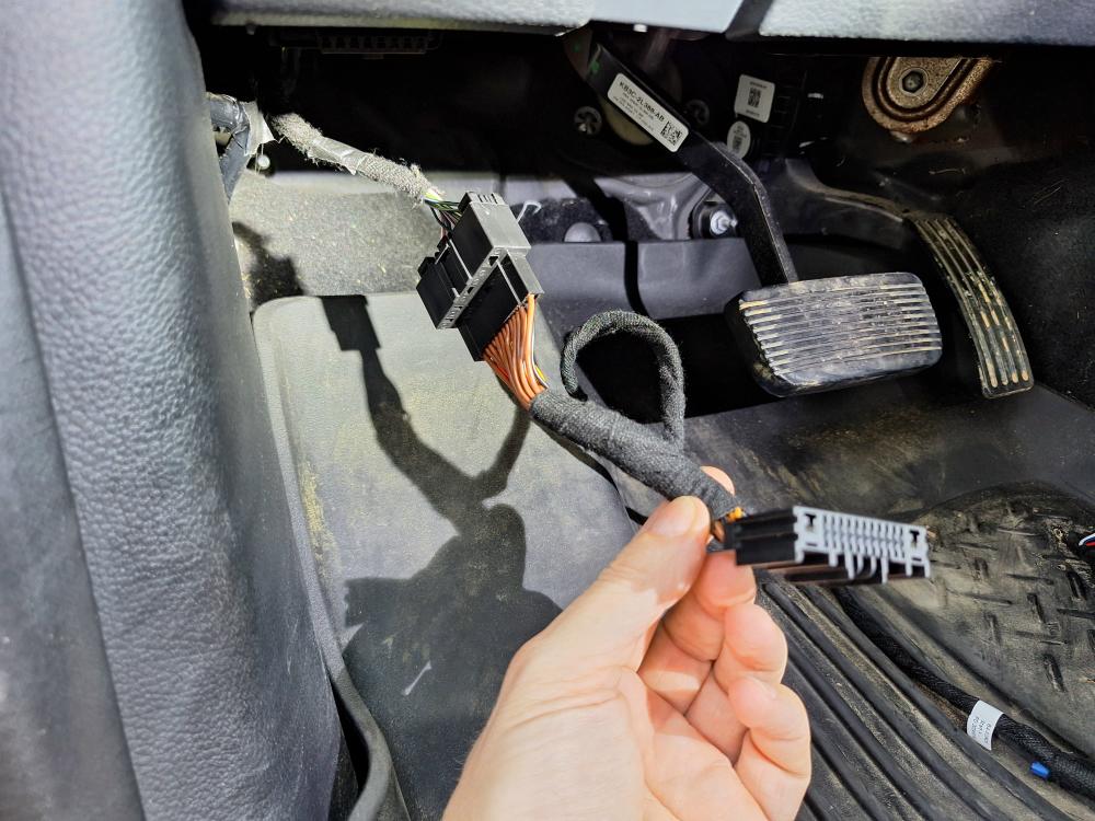

Step 1: Remove the connector going to the Gateway Module located on the back of the OBD-II port (under the hood release).
The plug has a release on the bottom center of it that you have to push in before you can pull the plug out.

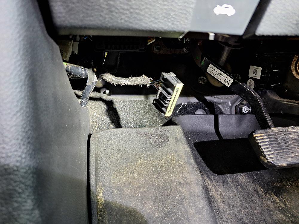

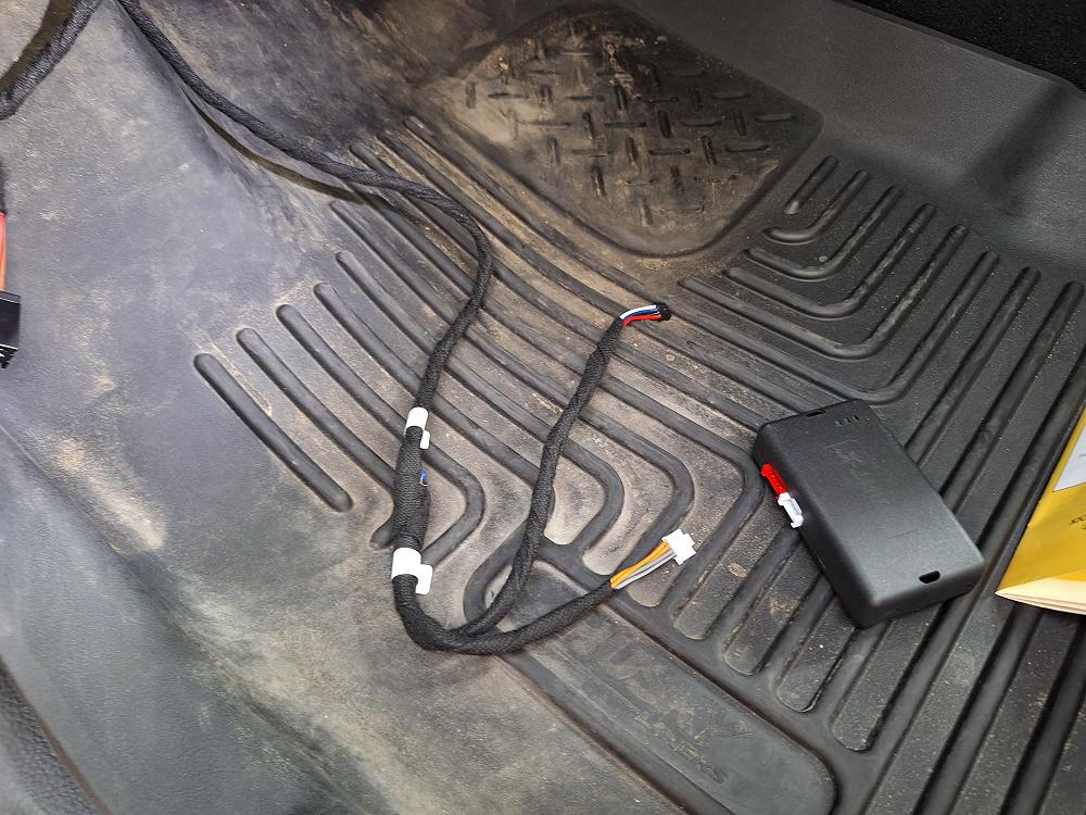

Step 2: Once you have the removed the connector, connect the T-harness from the kit in-line with the connector.
NOTE: Do not plug the Remote Start Module into the harness!

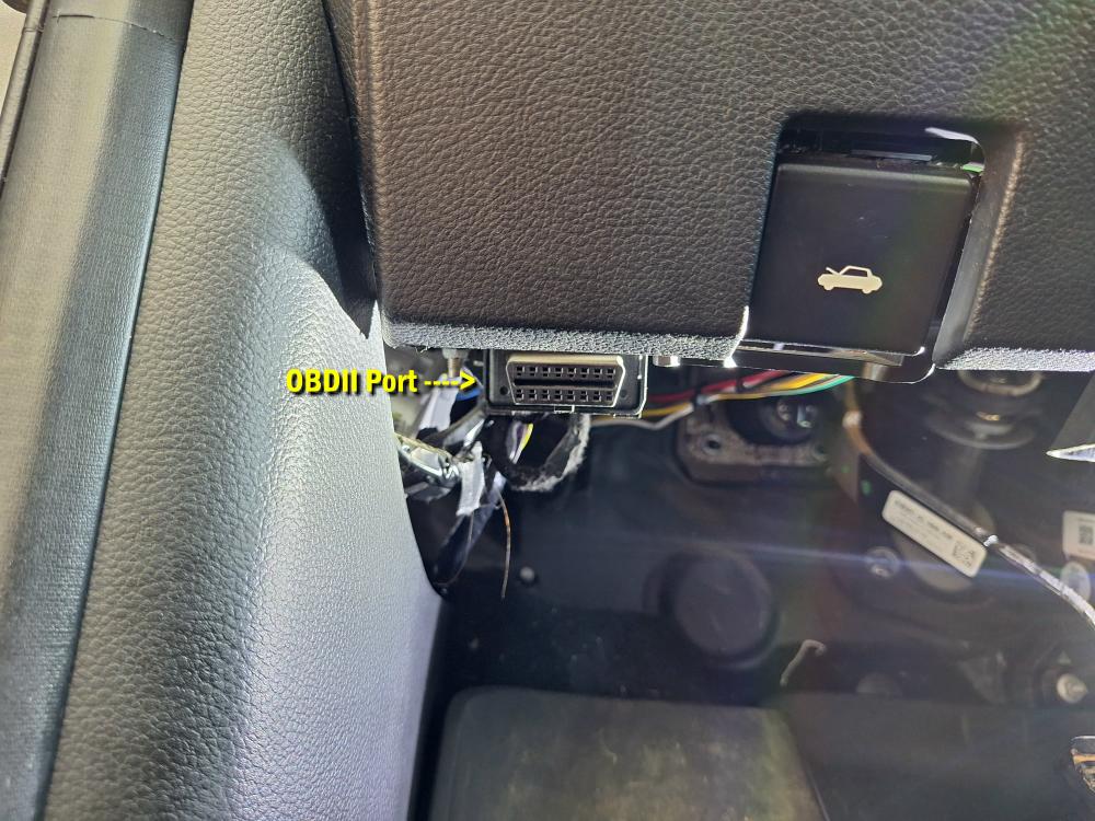

Step 3: Plug the other end of the T-harness into the back of the OBD-II port.

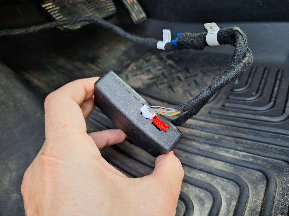

You can’t just plug in the Remote Start Module. There’s a procedure you have to follow and an order in which the last two plugs are connected.

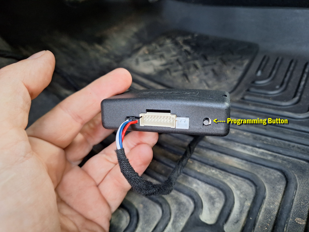

Step 4: Press and hold the Programming Button. With your finger still holding it down, connect the black connector.
The connection is to the far left of the button and is the only place the black plug will fit.
The blue, red, yellow and blue and red LED’s will alternate.
Step 5: When only the blue LED is momentarily lit, release the Programming Button.
The blue LED should stay lit. If it doesn’t then unplug the connector and restart Step 4.
Step 6: Insert the remaining white connector

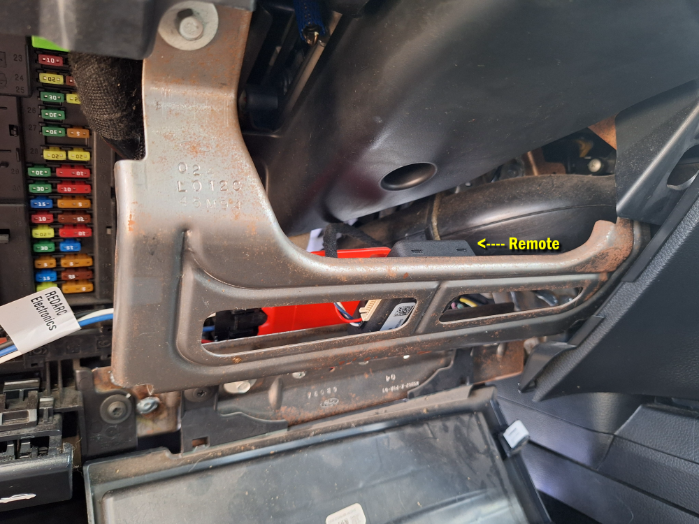

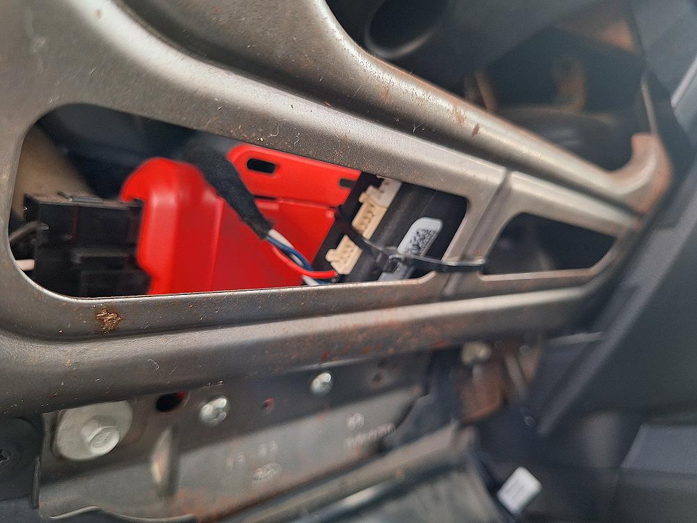

I removed the panel under the steering column and mounted the module in between the metal bracket shown below. It fits perfectly turned to its side, and in this position the wires aren’t rubbing on any metal. I used the included zip-ties to secure it.
Note: Be careful that you don’t press the programming button while your securing it with zip ties, and make sure the zip-ties won’t make contact with the programming button.
