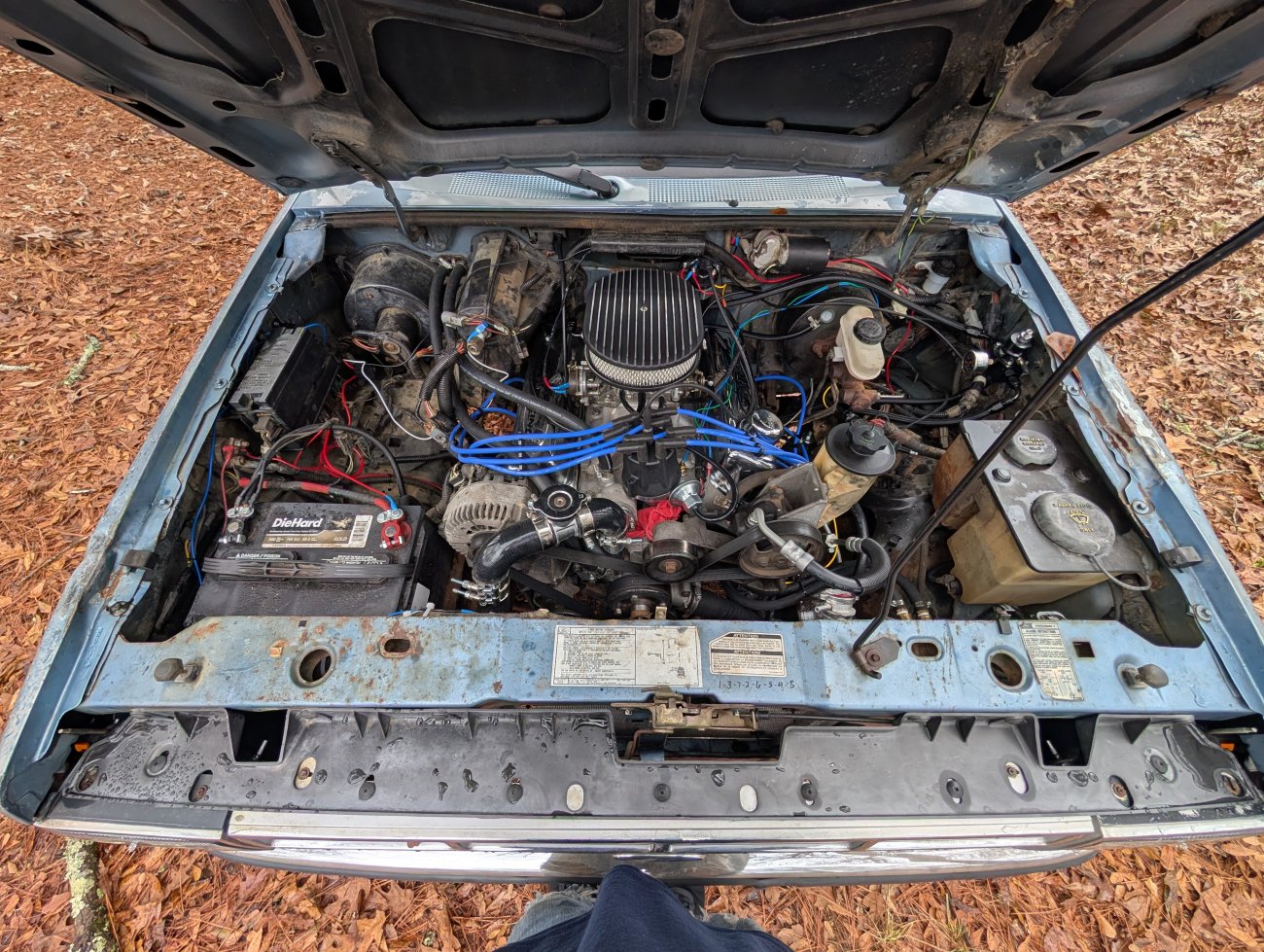

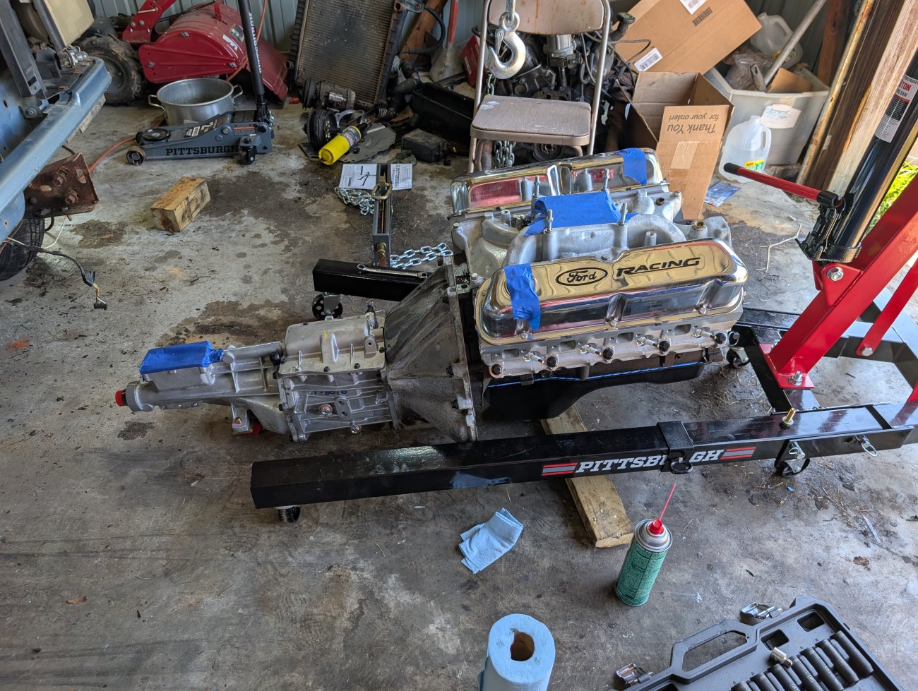

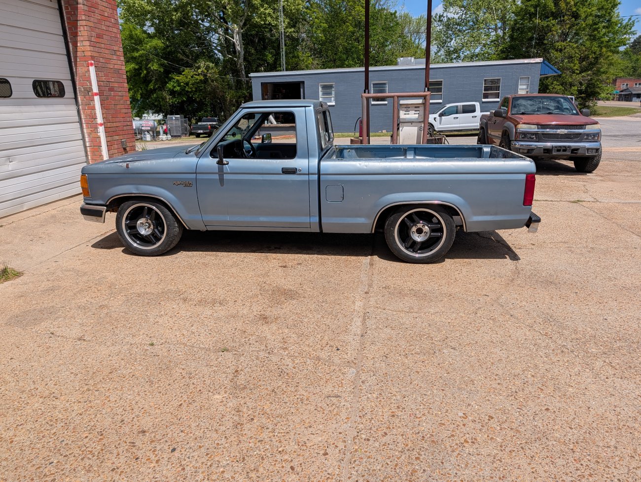

I finished a 302/5.0 swap in a 1990 Ranger back in December and thought I would share my experience. I didn't get a lot of pics, so this won't be a step-by-step, but I can definitely answer any questions with how it went for me.
Details:
- Rebuilt 1997 Explorer short block
- Flotek 180cc heads w/ 1.90/1.60 valves
- Summit stainless steel 1.6 roller rockers
- Summit 8902 cam w/ new lifters
- Used eBay dual plane intake
- 600cfm Holley 4160 carb
- eBay early Mustang tri-y headers
- Explorer front accessories and brackets
- eBay 2-row Ranger V8 swap radiator
- Ranger V6 rubber mounts with modified steel plates from the Explorer
- T5 transmission (new)
- Foxbody Mustang flywheel, clutch and starter (new)
- Hydraulic slave kit from DazeCars
- Raised trans crossmember from RicksRangerz
- Driveshaft from an early 4-cylinder Ranger (can't remember if gen 1 or 2)
- 7.5" rear axle with 3.73 LSD from gen 1 Ranger
- SVE 1993 Cobra R replica wheels with 245/45R17 Mickey Thompsons
3/5 inch budget lowering kit from Rick's Rangerz:

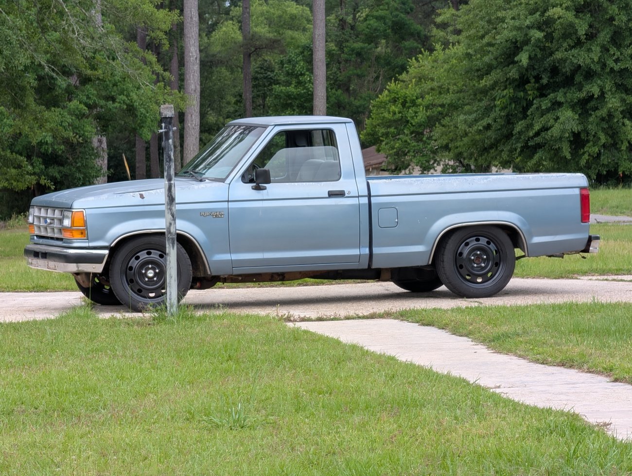

Crown Vic Interceptor wheels:
1990 Ranger 302 swap

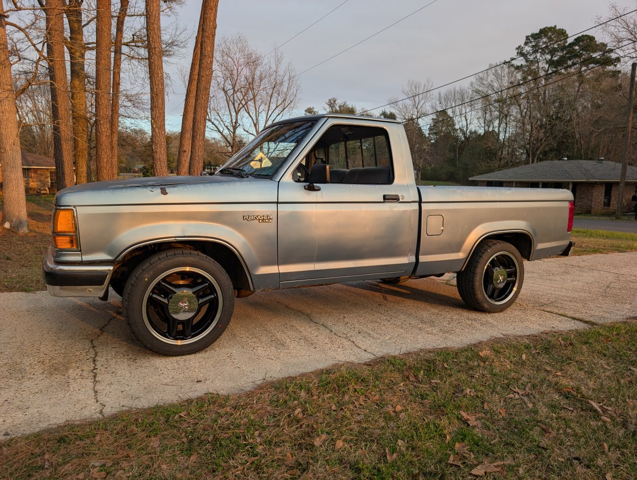

Run ok? How many different gears can you break the tires loose?

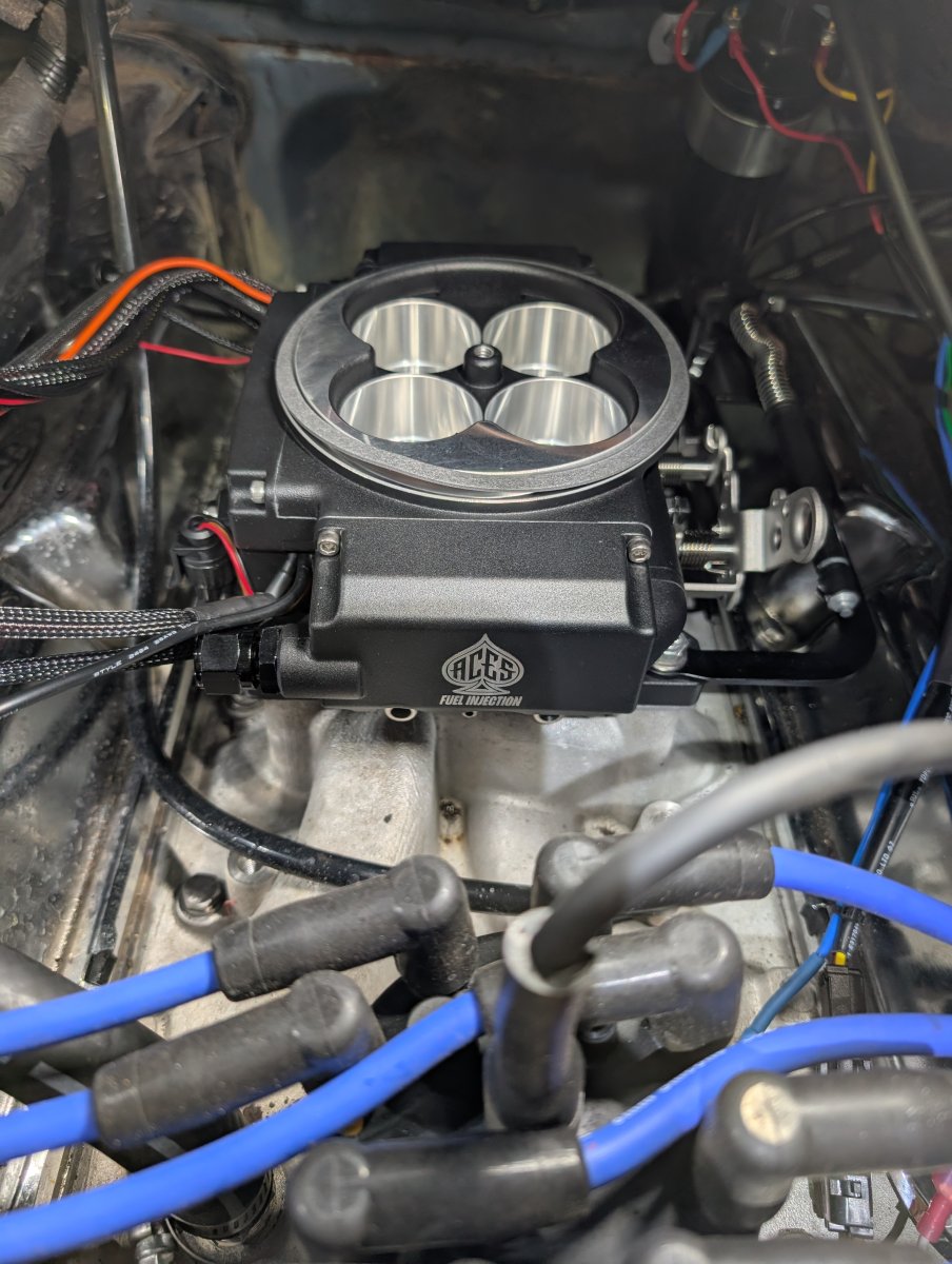

Well... not many since I put the TBI kit on it. There are still some bugs I need to get worked out. I'm hoping to get it tuned soon.
I know it has potential, though. Even with the original 3.45 open diff and going "easy" during break-in, it would spin through 2nd on a carb. I just put the 3.73's in a week ago and it feels grippier with the Mickey T's.
Now the truck needs new suspension bushings that I haven't gotten around to.
Basically it's still a work in progress. 😁
always a work in progress
Honestly, I don't think I'd have it any other way. Seems like I get bored with it when I don't have something to do to it.
absolutely.
done enough just means i can drive around.
i am good with done enough.
Like what do you have going on for bugs with the TBI?
Timing isn't right and sometimes it goes rich when I give it throttle. When I let off the throttle and push the clutch in to shift, sometimes RPMs hang before going down. Little things that a tuner would be able to fix.
In case someone else is curious down the road what you have for a distributor...
I fought the rev hang thing with my carb, it was the air filter mounting gasket lol. It is incredibly annoying for sure.

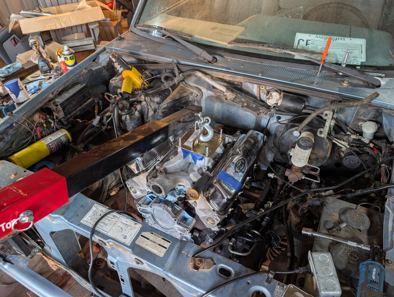

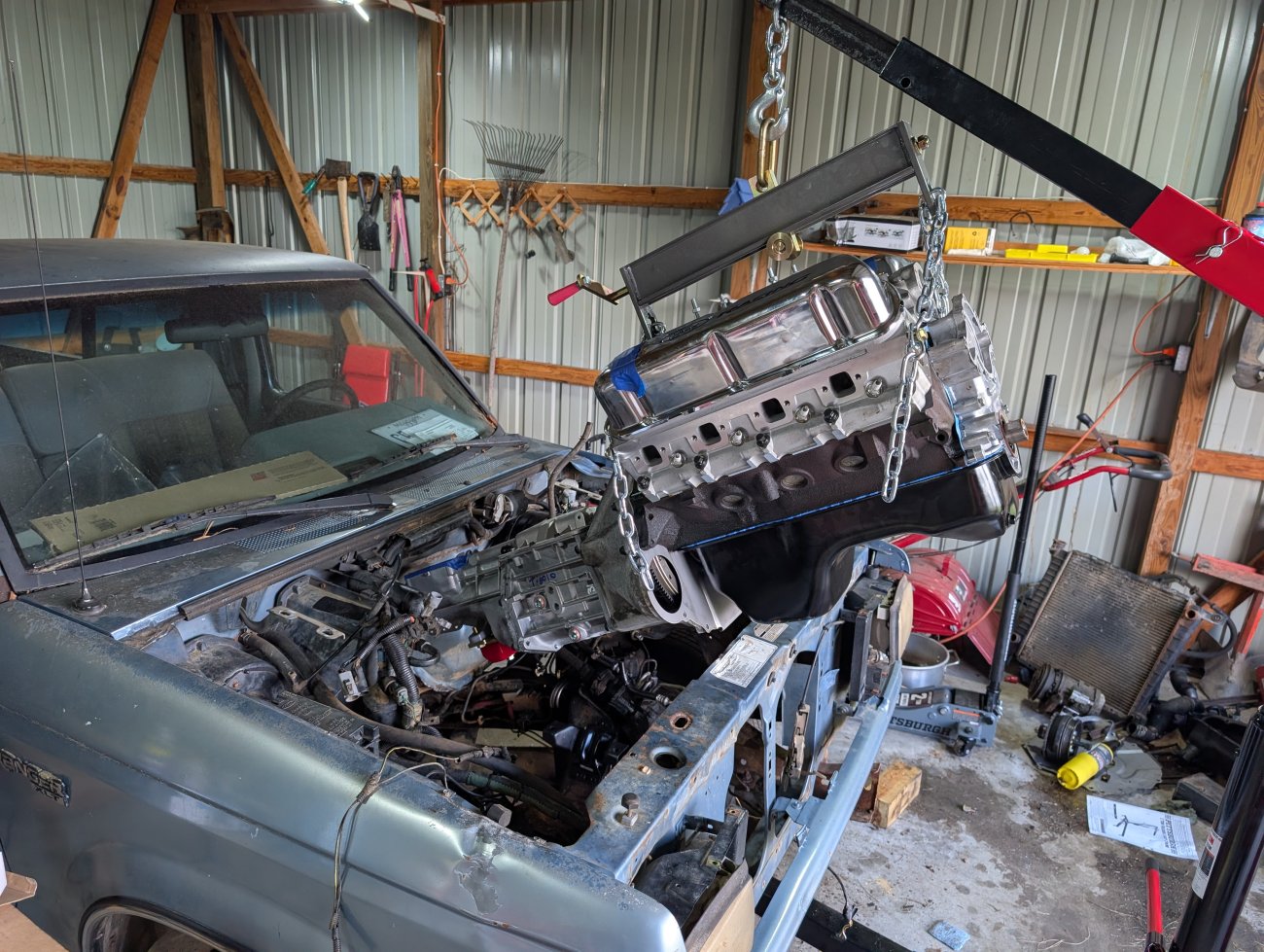

Which Daze Slave kit did you use? Did it clear the floor? And pics of the header clearance on the passenger side?
I used his Foxbody kit that bolts to the transmission and asked for a 3/4" slave cylinder. He'll swap it out for no extra charge. It doesn't clear the floor, but I didn't care at the time. The bleeder valve is actually denting the floor more and more every day. If it ever breaks, I'll try the slave that has the fittings pointing rearward.
I don't have pics any of the exhaust right now, but I can get some tomorrow. I did have to clearance the top part of the frame on that side. The driver side collector was hitting the bellhousing so I ended up grinding that down too.
I've decided to take the EFI off and go back to a carb. This engine was running so much better with a 600cfm Edelbrock. Plus I really don't have $400+ for a tune right now.
Honestly, my engine tuning experience is minimal. I haven't worked with a "basic" engine like this in 30-ish years when I was in high school. Even then I was just rebuilding stock stuff and running.
I just need to get some experience tuning a carb and distributor, and maybe I'll try the EFI thing later.
I'm not saying that Aces stuff is bad; I'm just not ready or skilled enough to give it what it needs to run right.
