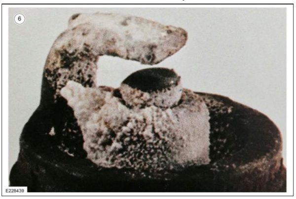

Deposit Buildup:
6. The presence of deposits on the spark plug can be indicative of oil leakage or poor fuel quality. Often, these ashy coatings cause misfires as a low resistance path from center electrode to ground is created.
Correct the oil leak, if necessary.
Inform the customer of possible poor quality fuel.
Install new spark plugs.

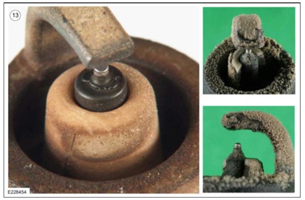

Sodium/Oil Migration:
13. In the case of oil migration, misted oil is absorbed into the combustion chamber during charge intake. For cylinder deactivation, valves remain closed and oil within the chamber does not combust. Misted oil adheres to the spark plug surfaces and oil penetrates into the clearance volume between the insulator and center electrode via capillary action. During cylinder reactivation, oil near the surface is burned off, while soot (carbon deposits) is generated within clearance volumes due to incomplete combustion. During spark plug reheating, the center electrode thermally expands at a much greater rate than the insulator, causing compressive stresses within the center electrode and tensile stresses on the electrode insulator exterior. These stresses can fracture the ceramic insulator if sufficiently high. In sodium migration, sodium sulfate is created during combustion and deposits form in the clearance volume between center electrode and insulator. Currently, the source of sodium sulfate is not known, although it is believed to originate from E100 fuel. Present theory suggests that failure is caused by electrode/insulator locking, where electrode and insulator are mechanically joined by the sodium sulfate. During cool down, the electrode contracts and increases in diameter, which pushes (via sodium sulfate) against the insulator and causes failure in the same manner as seen in oil migration.
