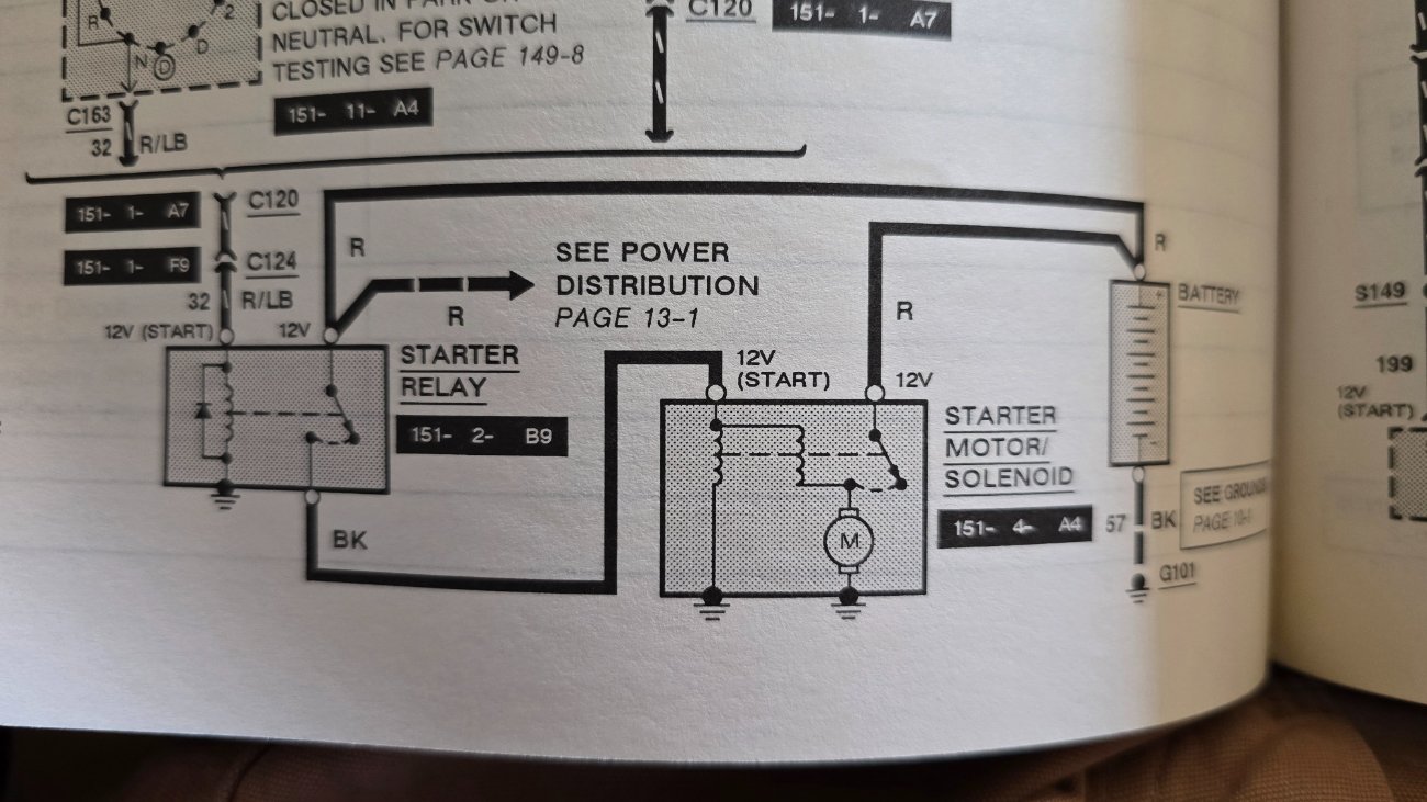

To check the starter relay - the device mounted on the inner fender.
First make sure full battery voltage is present on the big terminal where the battery cable is attached.
Second, take a jumper or screwdruver and connect from that terminal to the small terminal. This simulates the signal coming from the key switch. If the relay is working, you should hear a strong "click" or "clunk" as the relay closes its contacts. The starter motor should also spin and try to start the motor. If it does not, you can try it again and measure the voltage on the other big terminal that sends power to the starter motor. If it is full battery voltage, then the starter relay is good. If it is significantly less than battery voltage, the relay is probably bad.
One more test. Short directly across the big terminals. The starter motor should turn. If it doesn't, then there is a problem with the starter or the ground path back to the negative battery terminal.
Sorry to be stubborn about terminology concerning starter relay and solenoid. These are very different components with different jobs. Especially when looking at the wiring diagrams or communicating with others, it gets confusing when the wrong terminology is used. The solenoid is mounted to the starter motor. It usually looks like a big lump attached to the side of the starter. It does 2 things. 1 - it shoots the bendix gear forward to engage the teeth of the flywheel. 2 - it closes an electrical contact sending power to the motor windings. The starter relay, up on the inner fender is just an electrically operated switch that sends power to the starter solenoid when the ignition switch is activated.

There is no "negative" terminal on the starter relay.
The little terminal is 12volts from the ignition switch. This energizes the starter relay coil.
One large terminal is 12volts from the battery.
One large terminal sends 12 volts to the solenoid on the starter when the ignition switch energizes the starter relay coil.
The metal base of the starter relay is the negative sude of the starter relay coil and must have a tight, clean connection to ground /the sheet metal inner fender.
Review my instructions again and study the wiring diagram. If necessary, I'll create a video tomorrow.

Ok thanks 👍 In the meantime I'm going to check all the wires to the starter. I'm gonna have to jack her up to get under there comfortably. I'll advise.
I tapped the starter with a hammer while my friend cranked it. Fired right up with the first tap. I ordered a new AC Delco starter from Rock Auto. Further, The local neighborhood auto parts store where I purchased the starter 9 months ago, won't refund or replace it without a receipt, really who saves the receipt?...I'm done with these mom and pop shops now. They sell garbage chinese parts, just like Amazon, so why pay mom and pop shop prices when u can get the same crap on Amazon, but for way less.
