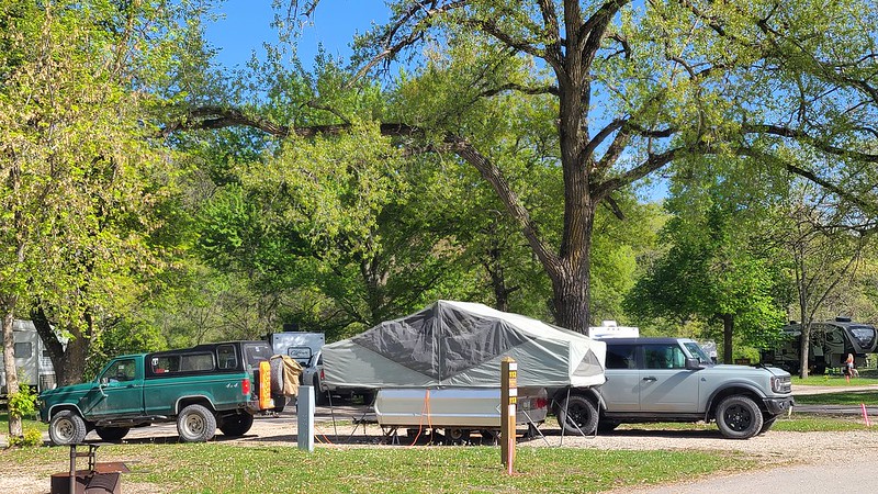

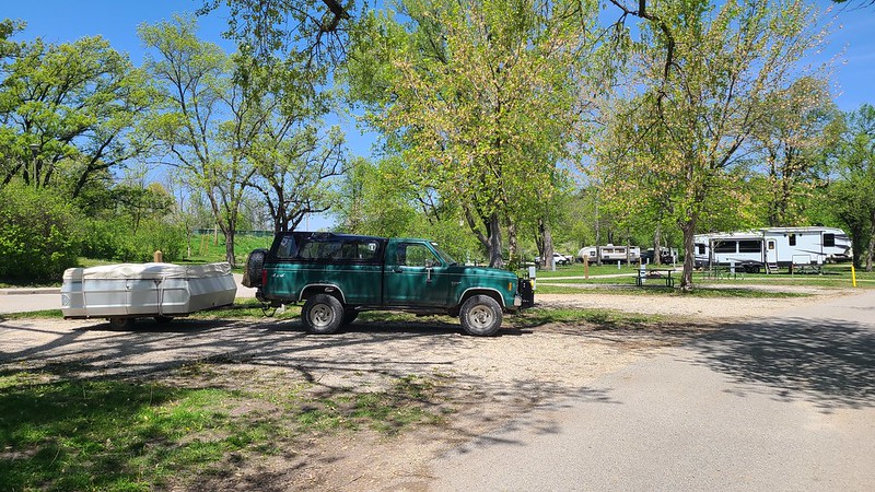

The most our popup trailer is supposed to weigh is 1200lbs. No idea what it weighs when we go but my V8 swapped Ranger plays with it.

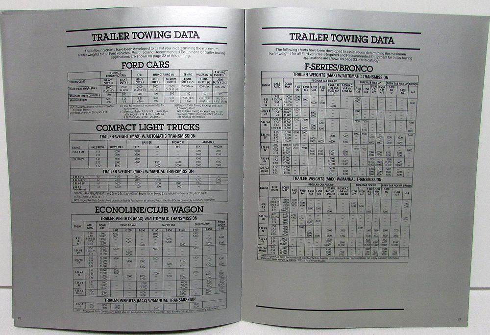

Your owner's manual limits the '85 Ranger to 2,200lbs trailer towing for the 2.8/manual/4x2.. (It's really 5,000lbs GCWR, as the 4x4 tows 200lbs less) See the attached Towing guide - its a copy of a copy but the best I have.
Note: The 2,200lbs is based on the truck having 3 - 150lb occupants* in the cab and full tank of gas, no junk stuff behind the seat/in the box, etc. The 3 occupants is derived from the number of seatbelts, 150lbs was (still is for J2807 trailer standard) the average weight for an individual. So, in theory you could tow a little more than the manual, legally. Just no sandwich maker in passenger's seat(s), etc...​
Arizona trailer law requires truck with trailer having less than 3k lbs. GVW to be able to stop within 40'; a number of other states (Pennsylvania, Washington) add a caveat; the trailer needs brakes if >40% of the GVW of the towing vehicle ('85 Rangers start at 3,800lbs GVW = 1,750 lb. GVW trailer). The fine print: The trailer weight is the GVW of the trailer, not the actual weight of the trailer. (There is an assumption that you might fill up to limit but not overload the trailer.)

To stay under 2,200lbs, tent trailers like @85_Ranger4x4's are your best bet. (There might be older Scamp trailers in that weight range too.)
shit...i remember those tiny clutches and 5 speeds were junk....but i didnt remember them being that level of garbage....
bronco 2....tow 5 k with auto..... nothing with manual.
that is crazy.
i knew the 2.3 was good for 3k plus, but forgot it was an auto. those were rare.
that is embarassing.
that is crazy.
