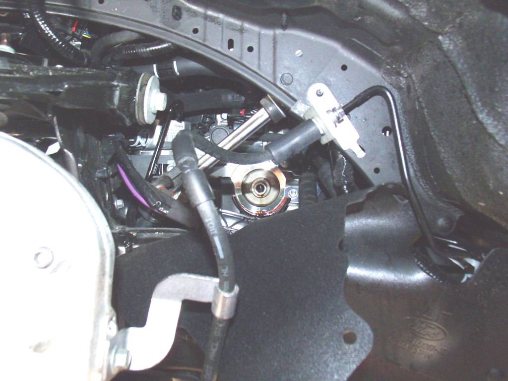

I removed the front drivers side tire… since I was rotating the tires anyway. The filter that came from the factory was different than the FL-910S Motorcraft filter. My filter wrench just spun on the factory filter…. shit! My filter wrench fits nice and snug on the FL-910S?
I tried some different wrenches I had, those didn’t work. ended up wedging a small piece of rubber friction tape. between the wrench and the factory filter. That worked. Pictures are after removal, just to show what I’m talking about. The trough Ford supplied to capture and re-rout the oil that runs out of the filter worked great. Well done Ford.
I then installed the new FL-910S Motorcraft filter, easy peasy.
The cover in the wheel well needs to be removed down past the brake line to allow cleaning out the oil filter trough. I shot some brake cleaner in the trough and then wiped it out with a paper towel.

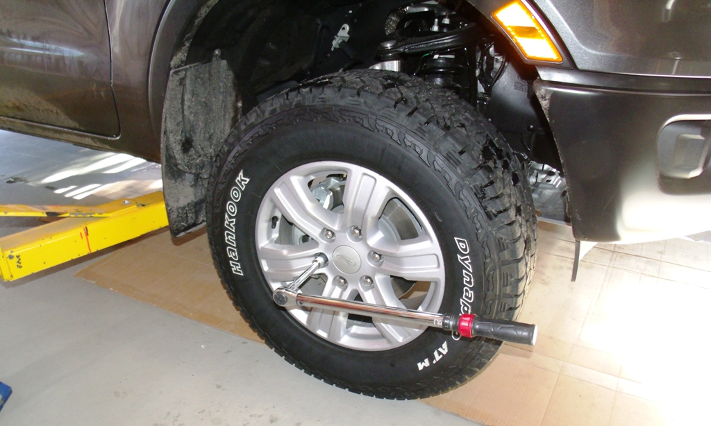

Rotated the tires, torqued the lug nuts to 100 ft-lbs.. and we’re good for another 4,000 miles.
