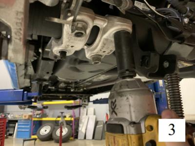

2) DISASSEMBLY
a) Remove both rear Shocks. (Pic 1)
WARNING: Leaf springs may be under tension. Springs under tension store a great amount of energy. Use caution during the following steps to avoid personal injury and/or damage to the vehicle. Be careful not to damage brake hoses and or driveline while relocating rear axle.
b) Properly support the axle using a jack or lifting device so that it can be raised and lowered. Support the rear axle U-Joint to keep the axle from rotating.

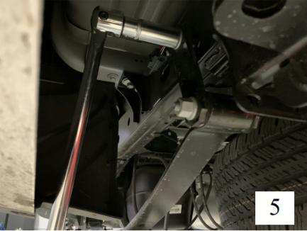

c) Remove the 4 bolts from the rear brake lines attached to axle (Pic 2)
d) Remove the U-bolts nuts and U-bolts. (Pic 3)
e) Remove the front leaf spring bolt/ nut. (Pic 4)
f) Loosen the shackle bolt/ nut at the rear leaf spring; remove the bolt connecting the shackle to the frame. (Pic 5)
g) Remove both leaf springs from under the vehicle. It may be necessary to lower the axle before they can be removed. Be careful to not damage any brake or ABS lines during removal.
h) Remove OEM bump stop and save the bolt as we will reuse this later.

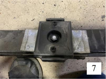

3) LEAF SPRING PREPERATION
a) Remove the top OEM U-Bolt plate using some pliers to crimp the plastic retainers and flat head screw driver to remove the plate. make sure to not use excessive force. (Pic 6) This will expose the bottom nut. (Pic 7)
b) Remove the centering bolt by using a pair of vise grips and a impact driver and socket. (Pic 8)
c) Remove the block and upper shim. (Pic 9)
d) With the items removed, flip the centering bolt and tighten back with impact driver (Pic 10)

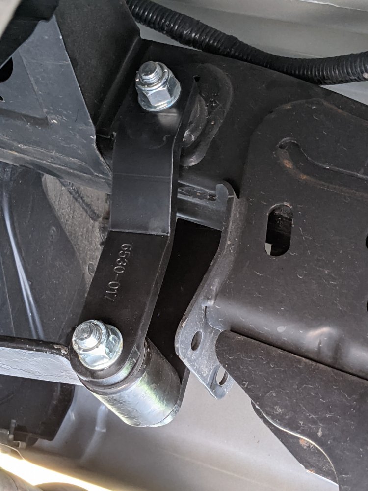

4) SHACKLE PREPERATION/ INSTALLATION
d) Install the BELLTECH INSIDE shackle plate # 6530-017 ( BELLTECH STAMP toward center of truck ) and using the supplied 9/16” X 6” bolt w/ washer to attach at the frame point. (PIC 15)
e) Lower the spare tire enough to allow the bottom bolt to be installed, using the OEM supplied kit to lower the spare tire. ( Refer to manufacture hand book for more details) (PIC 16)
NOTE: Two hole adjustment available. For a 5” drop use the top hole, closest to the frame, for 4” drop use the bottom hole, furthest from. For a 6” drop USE the OEM shackle. For a 4” setup skip to step 8a and then return to this section.
f) Install the supplied 9/16” x 4.5” bolt w/washers to the bottom hole connecting to the leaf spring. (PIC 17)
g) Install the BELLTECH OUTSIDE shackle plate # 6530-015 and tighten both the top and bottom bolts with the supplied 9/16” nut and washer
!DO NOT TORQUE/TIGHTEN THE LEAF SPRING BOLTS , FRONT NOR REAR, UNTIL THE VEHICLE IS ON THE GROUND!
