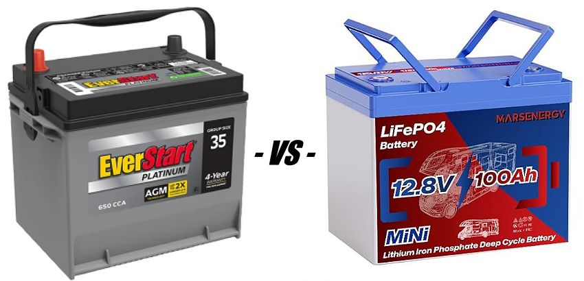

AGM vs LiFePO4 Batteries for Overlanding
Choosing between an AGM (Absorbed Glass Mat) battery and a LiFePO4 (Lithium Iron Phosphate) battery is one of the most important decisions when building an overland or auxiliary power system.
Both battery types can power accessories like refrigerators, lights, air compressors, and inverters—but they perform very differently in real-world use.
Quick Comparison
| Feature | AGM Battery | LiFePO4 Battery |
| Usable Capacity | ~50% | 80–100% |
| Weight | Heavy | Lightweight |
| Cycle Life | 300–800 cycles | 2,000–5,000+ cycles |
| Voltage Stability | Drops during use | Very stable |
| Charging Speed | Moderate | Fast |
| Cold Weather | Performs well | Limited (charging below freezing) |
| Cost | Lower upfront | Higher upfront |
