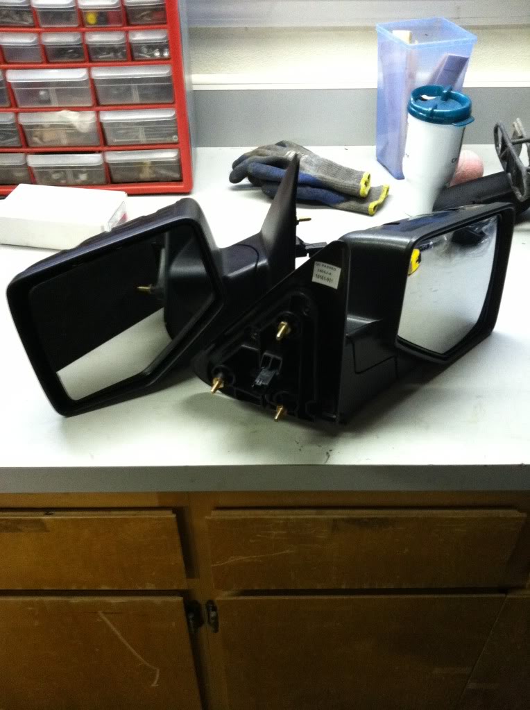

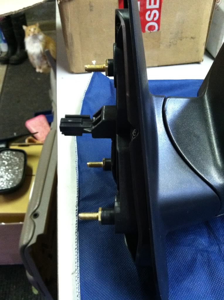

legoms013 wanted to update the look of the Ford Ranger even more, so he swapped in the parts from a 2004-2005 Ford Ranger;

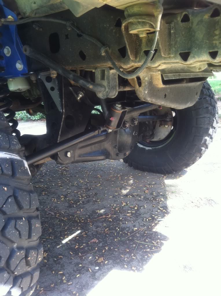

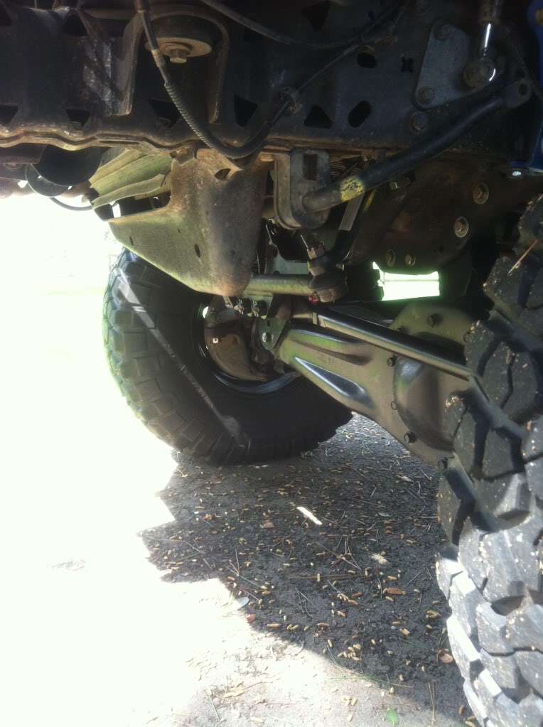

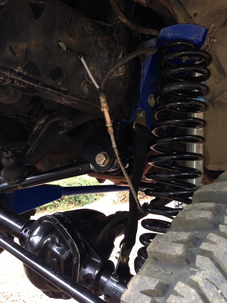

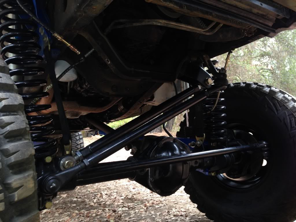

The front axle was mounted up with BC Broncos 5.5-inch coils (250 PPI, linear rate), James Duff SAS track bar bracket, and their fullsize Ford long arms.
Both axles run 4.88 gears.

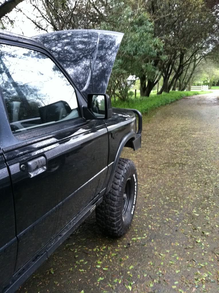

What started out as a stock 1996 Mazda B4000 4×4, has transformed in to an awesome 2005 Ford Ranger 4×4 (titled as a 2000).
