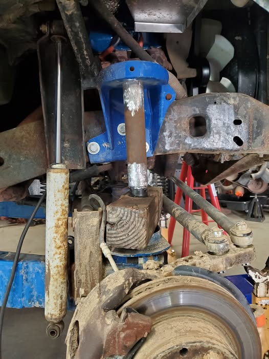

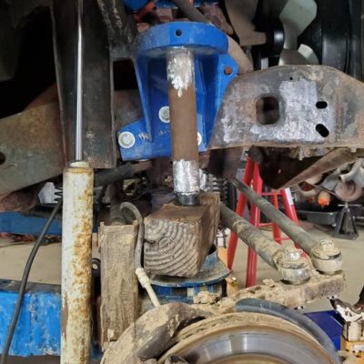

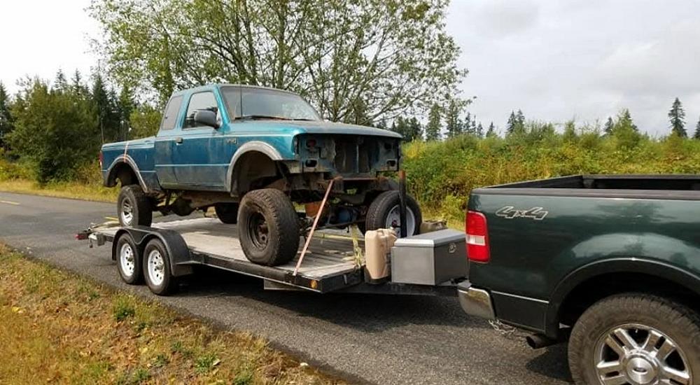

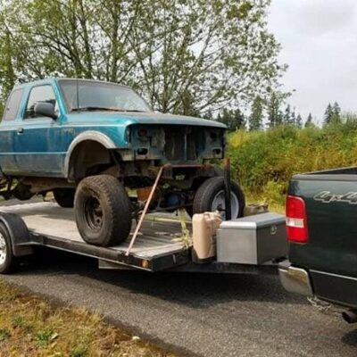

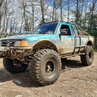

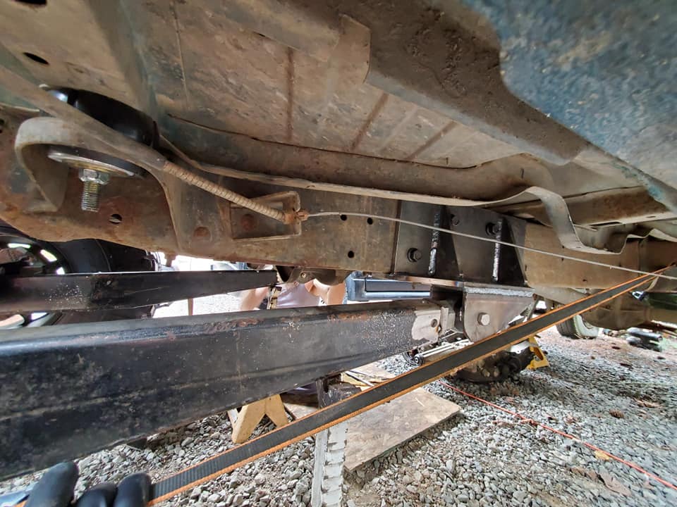

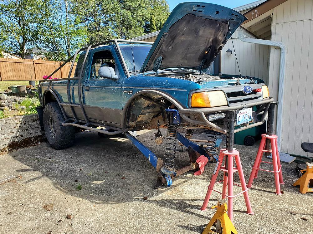

Finally, in August 2018, we came across this local 1993 4.0 5-speed. The odometer read 45k (felt more like 145k, not 245k) I even liked the color. The seller had previously solid axle swapped in a Dana 30 and was in the very early stages of swapping in a Dana 44. It still had the factory 8.8 in the rear. Arm mounts were tack welded to the frame, and that was the only connection point. It had an empty Dana 44 housing (found it had a slightly bent tube later) that was aligned using pull straps. Not ratchet straps. PULL STRAPS! And no front suspension. It had a 10×6 block of wood supporting the engine cradle mount on the front axle. The rear window was leaking, and it had been sitting for about 5 years. Mushrooms were growing on the carpet inside the cab, and it reeked to high heaven. The truck’s bed was on the ground under a tree on the other side of the seller’s property. The bed rails were in rough shape. Holes had been drilled for a ladder rack, and it looked like something had ripped the sheet metal for the right front tie down hole. Harley’s words: “This is going to be a lot of work.”
The only thing securing my/our interest: it idled fine and drove up onto my trailer under its own 2wd power. I bought it. We ratchet strapped the bed down to the frame and took it home.

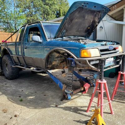

I gutted and cleaned the interior and tossed some eBay heated seat pads in the seats. Then it was slowly acquiring parts and building it piece-by-piece, making adjustments and changes as necessary. From purchase to first official test run was 5-years and 7-months.

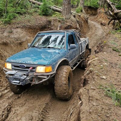

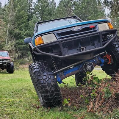

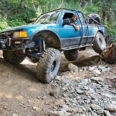

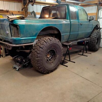

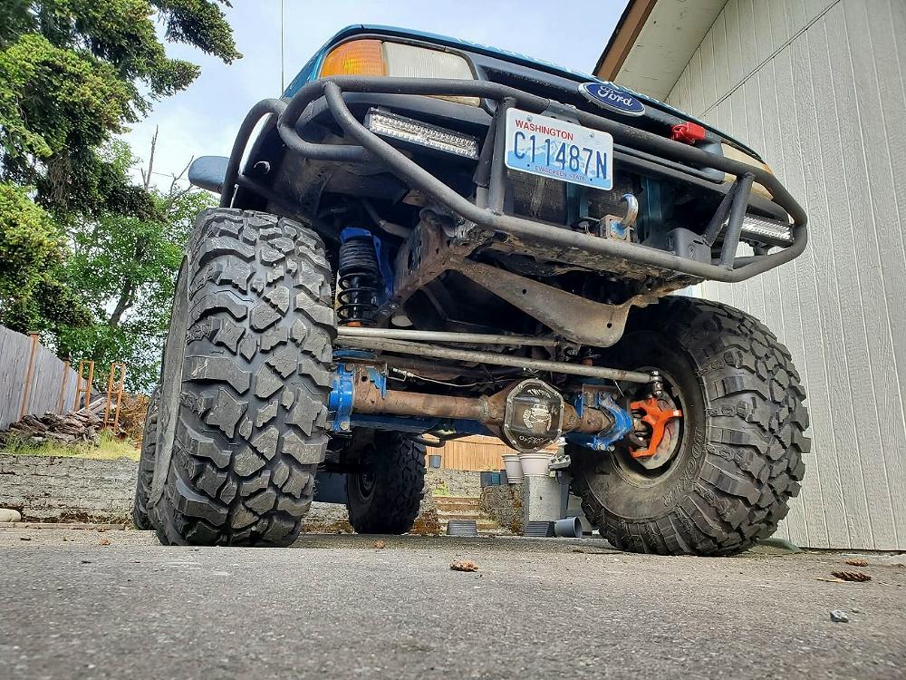

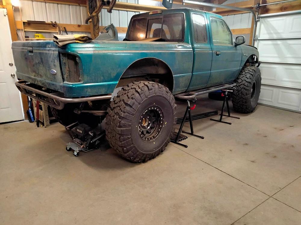

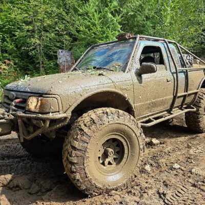

I originally planned on building around 37s. I’m aware of the Dana 44’s max tire size recommendations. Harley found the set of 41.5s for sale still wrapped in packing tape for a price too good to pass up. I have had tons of people give me guff over the tire size on a Dana 44. I do get on it pretty good, and I do love giving it more skinny pedal. But two years and at least 10 to 15 hard and fun trail runs later, and I still haven’t broken an axle, knock on wood.

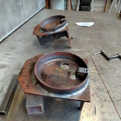

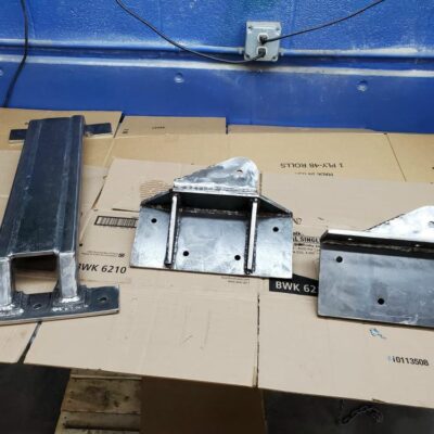

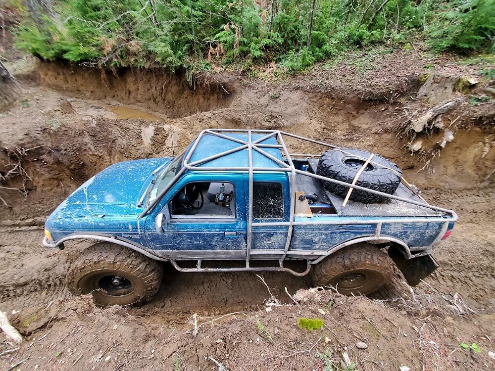

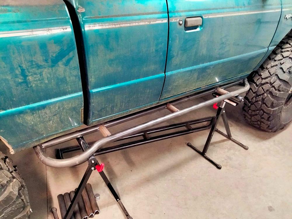

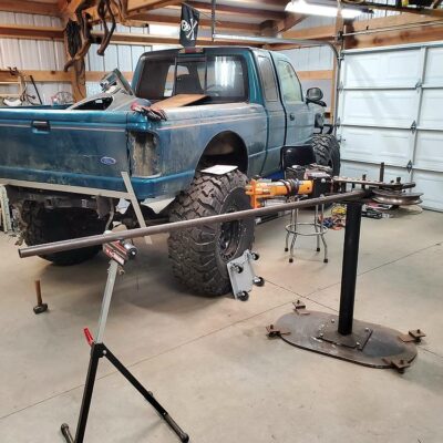

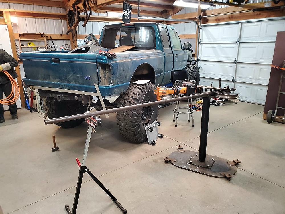

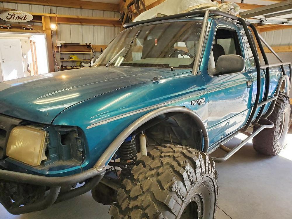

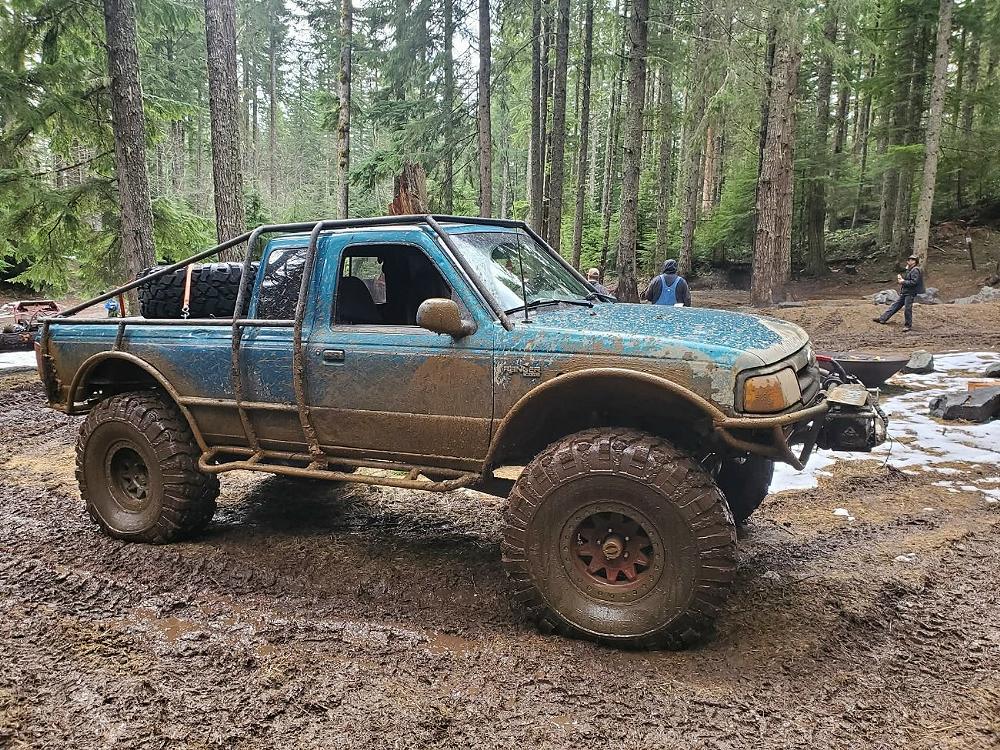

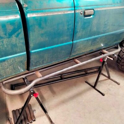

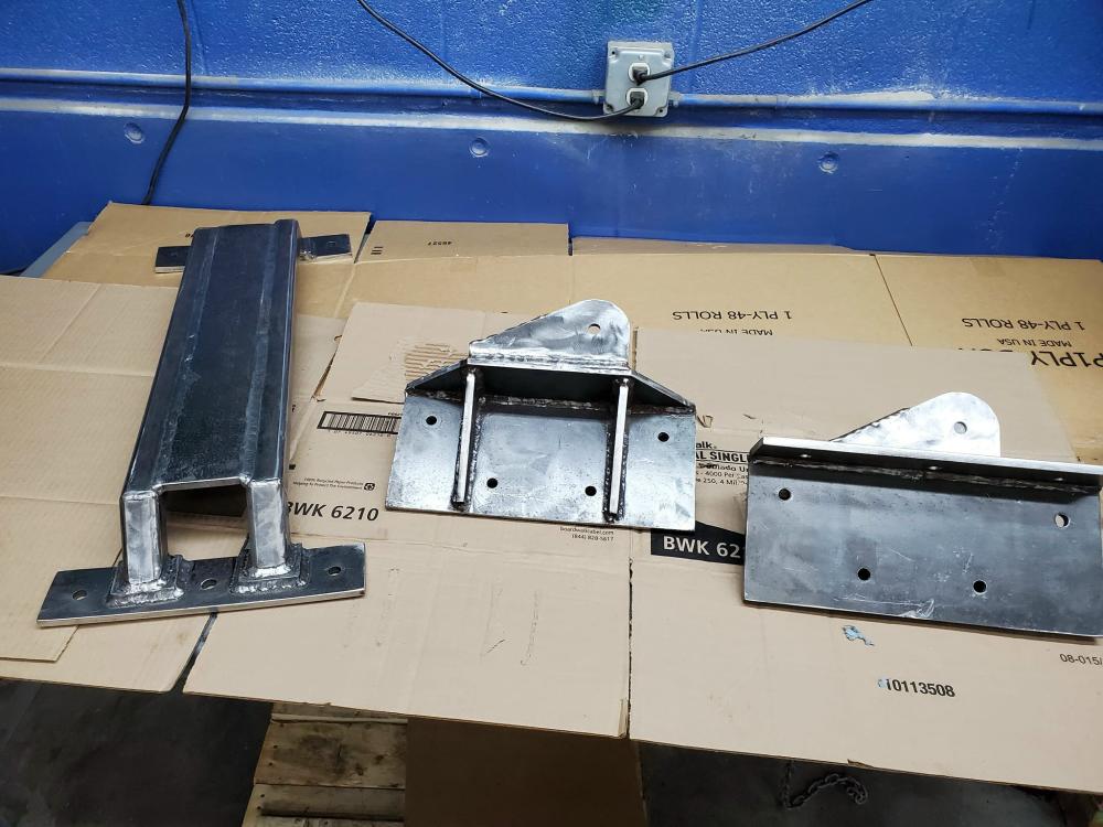

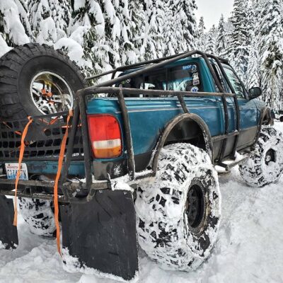

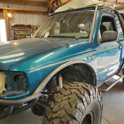

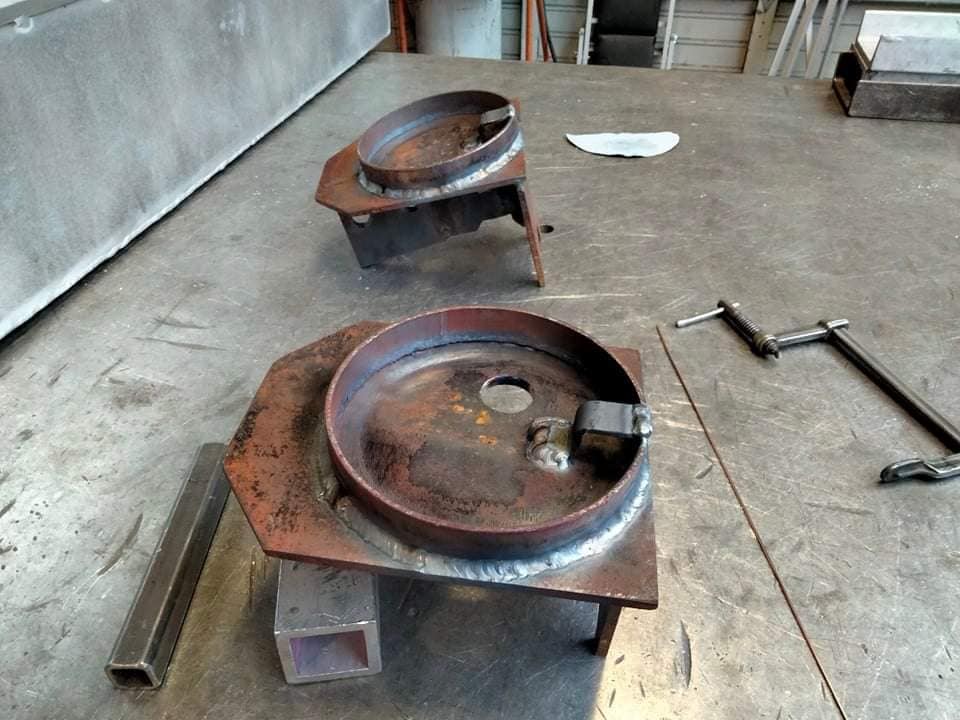

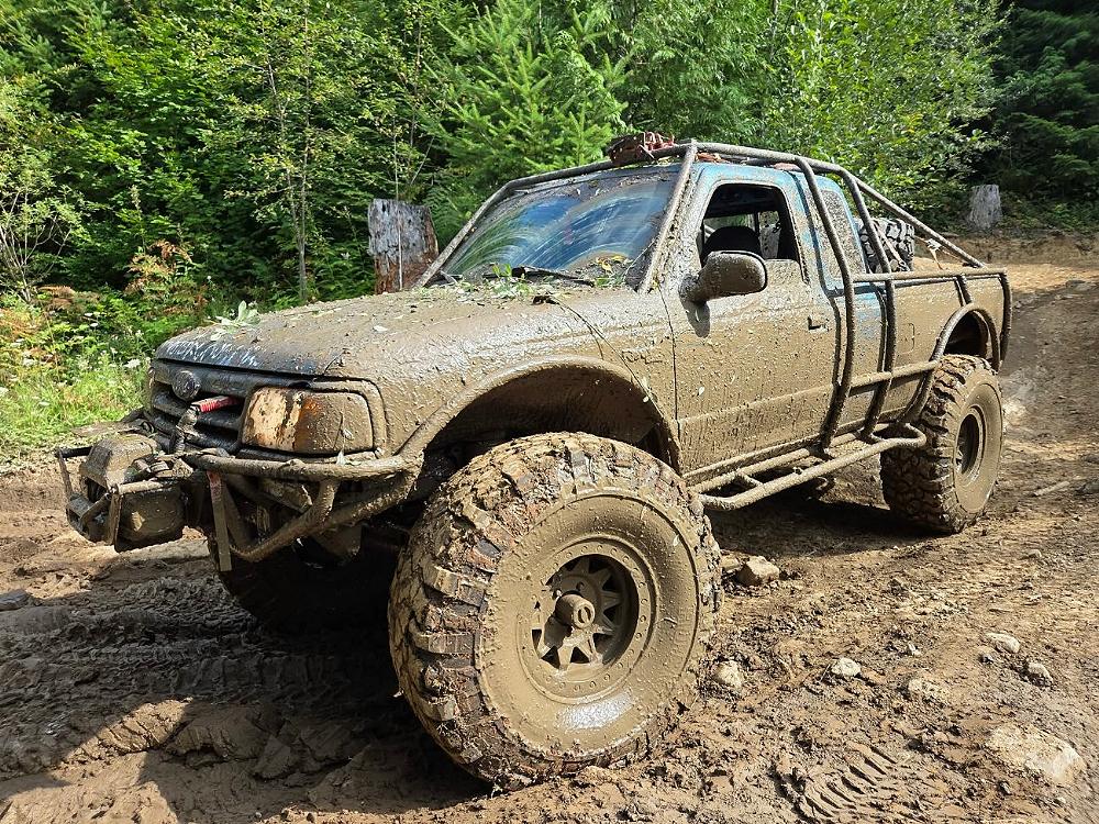

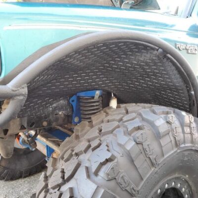

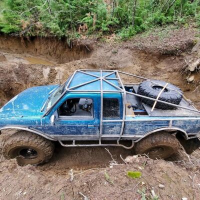

Harley custom designed and built the bumpers and cage. He used a roller for the wheel well bars and the vertical bars on the side of the cab. The main reason I wanted an exterior cage is there isn’t a lot of room inside the cab, and every trail truck I’ve had ends up looking like I took it through a can opener. Washington trails are tight, hence the term “tree hugger.”

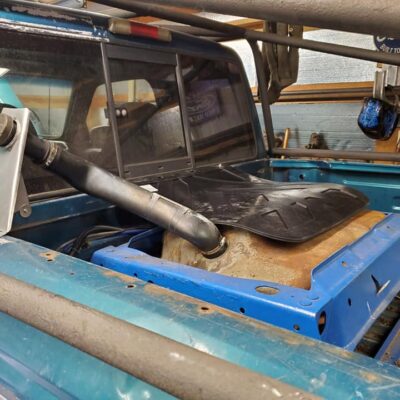

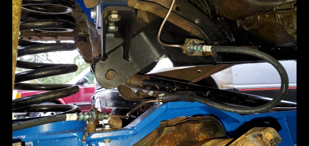

The main reasons for the ’86 Bronco II fuel tank are 1) there was an ’86 Bronco II sitting there waiting for scrap, 2) my doubler didn’t clear the tank as it’s not a shorty, 3) I had to remove the fuel tank when I rebuilt the entire brake line plumbing system, and 4) seven extra gallons should be reason enough. Lol.

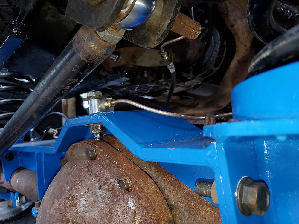

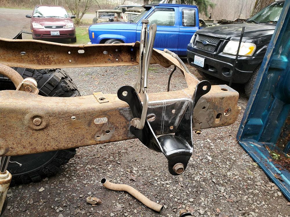

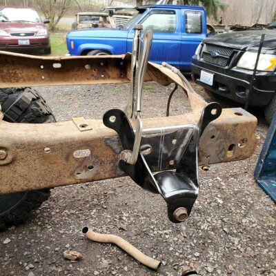

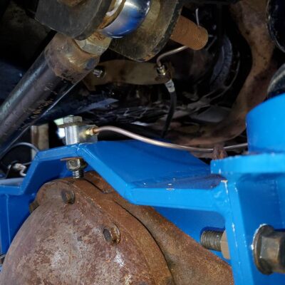

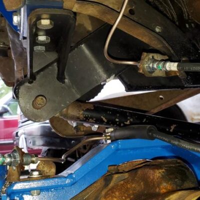

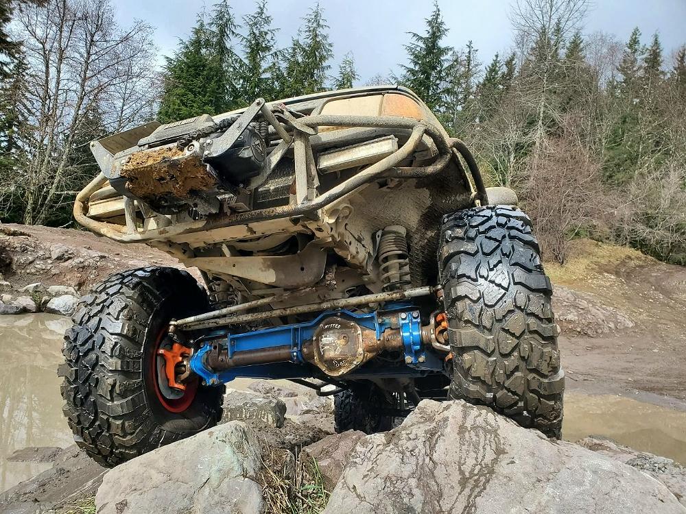

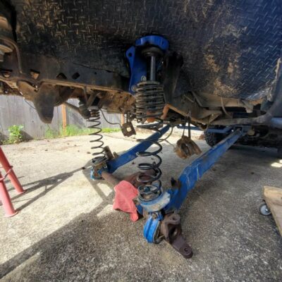

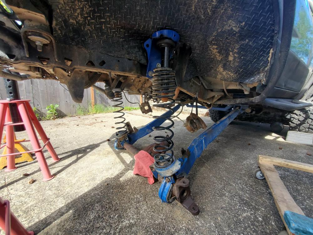

During the first test run, I discovered the track bar was kissing the engine oil pan when bottoming out. At the same time, my front frame to axle brake hose was getting pulverized between the track bar and dif. Those issues required installing bump stops. Cherokee spring style was the easiest way to make bump stops work. That’s when we switched from the 1978 F-150 lift coils.

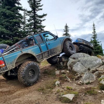

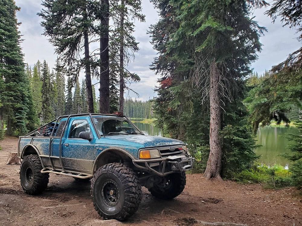

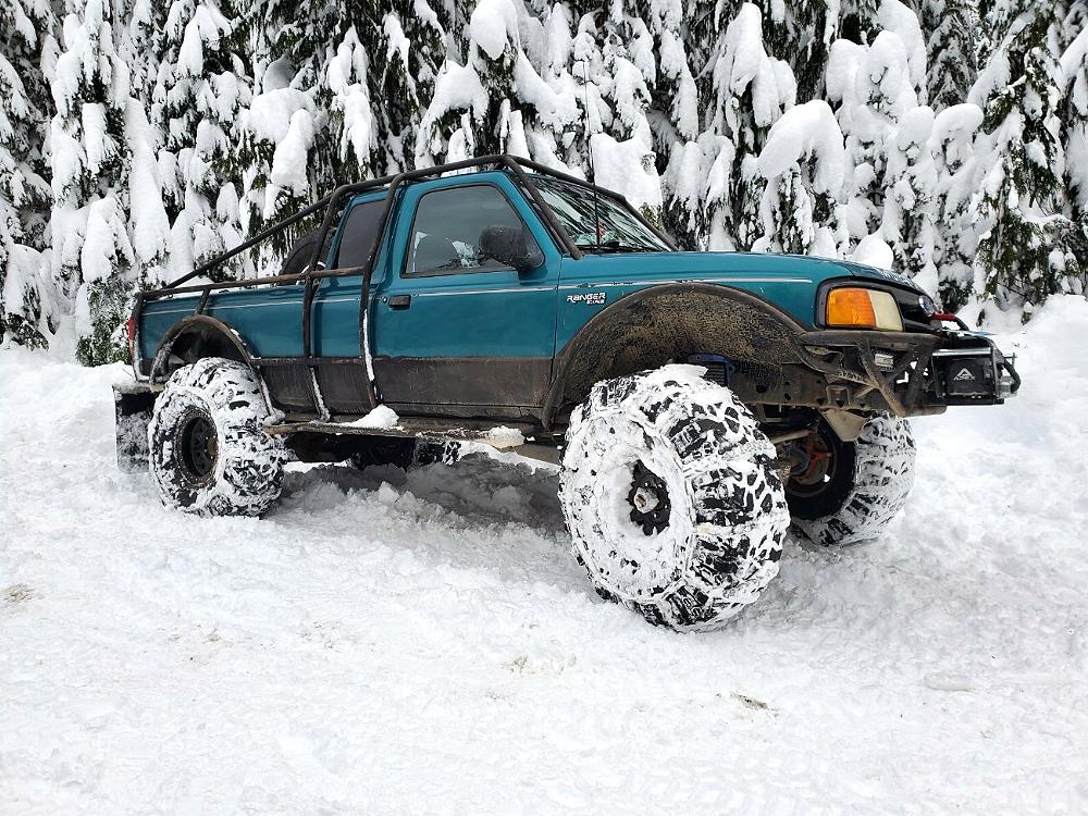

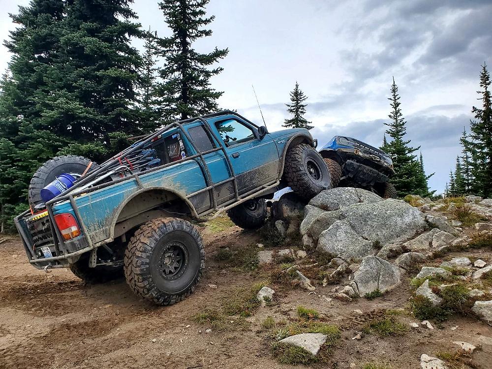

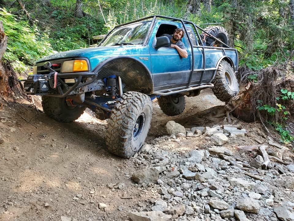

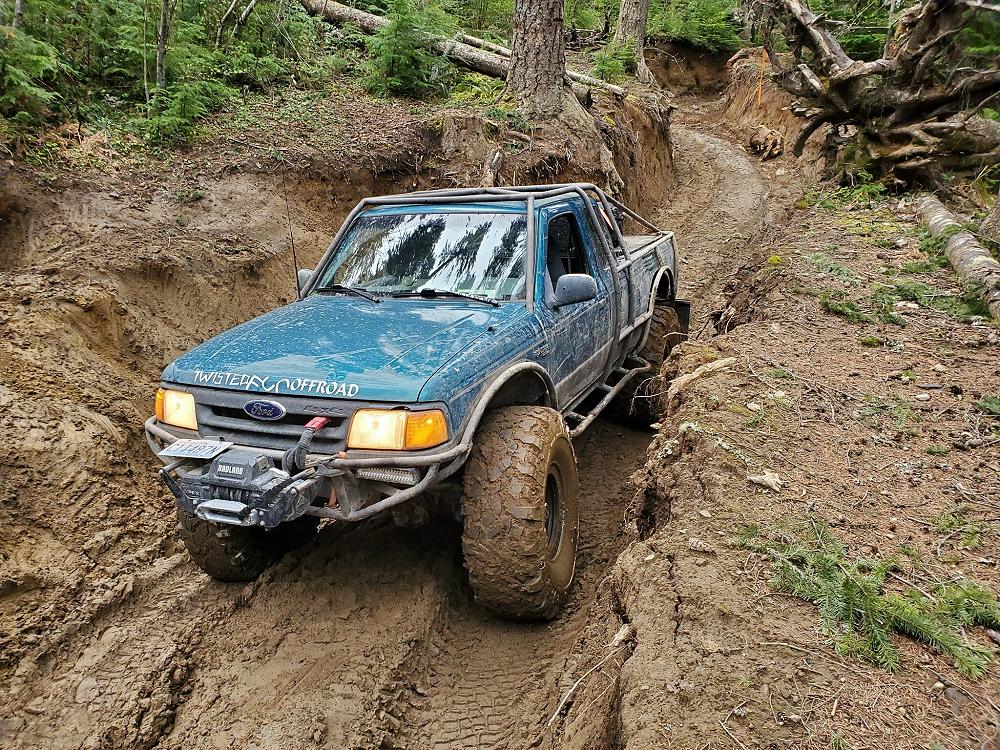

During the trail run after the test run and quite a few after that, I kept tinkering and adjusting and learning how it wanted to be driven. It just crawls over everything.
Thanks to Harley using factory angle spec books during building, it will do 70 down the highway with the suspension as smooth as can be. It does feel a little white knuckle in the steering over 45 miles an hour though, and it stops like a 70s lifted truck. Down the road, I am planning air shocks, coil overs, and a 4-linked rear.
Not really sure what else to say. Super fun truck. All the hard work and patience paid off. It’s so fun to wheel and drive. And a project is never finished.

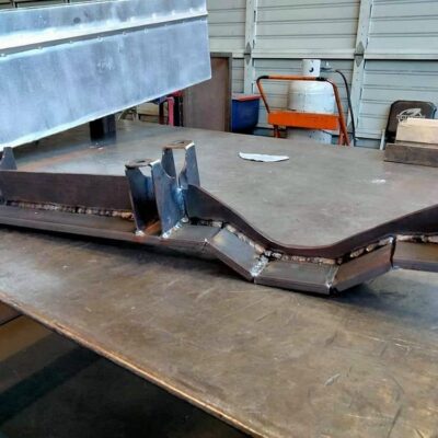

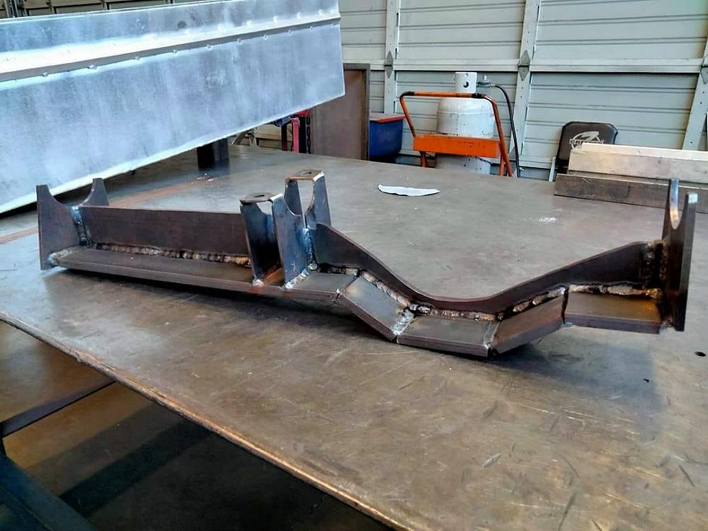

(Love this DIY bolt-on Dana 44 axe truss)

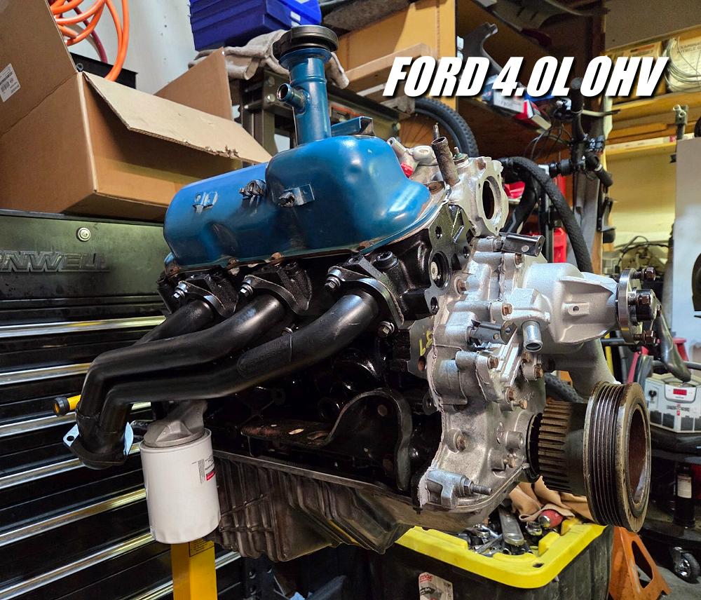

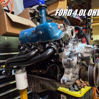

- 4.0 OHV V6
- 49-410-8 cam
- Bored 0.020 over
- Melling high flow oil pump
- Roller rocker
- Stainless valves
- Dual valve springs
- Full length headers
- 2005 Jeep Liberty V6 Saginaw power steering pump using Proquipped adapter
- Everything else basically factory specs
- All pulleys, pumps & belt original equipment
Intake
- BBK 60mm
- Throttle body spacer bored out to 60mm
- Intake manifold opening bored out to 60mm
Fuel Tank
- Factory fuel tank from 1986 Bronco II mounted in bed (T-Case doubler didn’t clear Ranger tank)
- 1989 fuel pump in the tank allows my dash gauge to work properly. (24 gallon instead of factory 17 gallon)

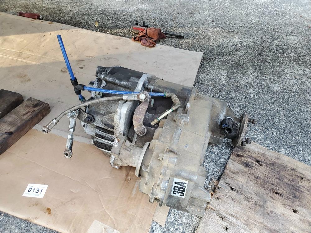

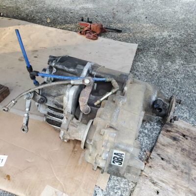

Transfer Case Doubler
- BW1350 front
- BW1354 rear
- Doubler plate and shaft built by Michael Steelman, 1350m case modification and assembly done by Harley Fields
- Shifter linkage all thread rod with Heims and shift levers custom fabricated by Harley Fields

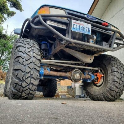

- Reid Racing high steer knuckles
- DOM Tie Rod & Drag link
- Gearbox & pitman arm original to truck

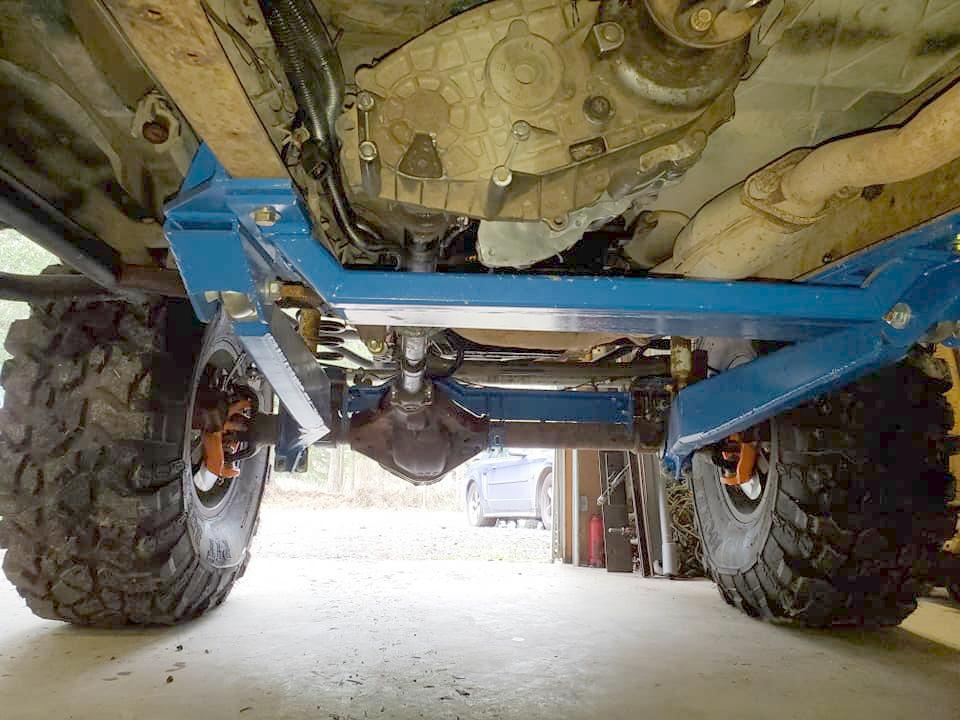

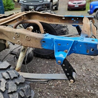

- Track bar relocated to rear of front axle custom fabricated by Harley Fields

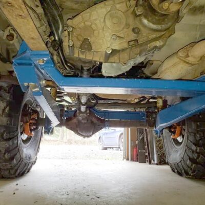

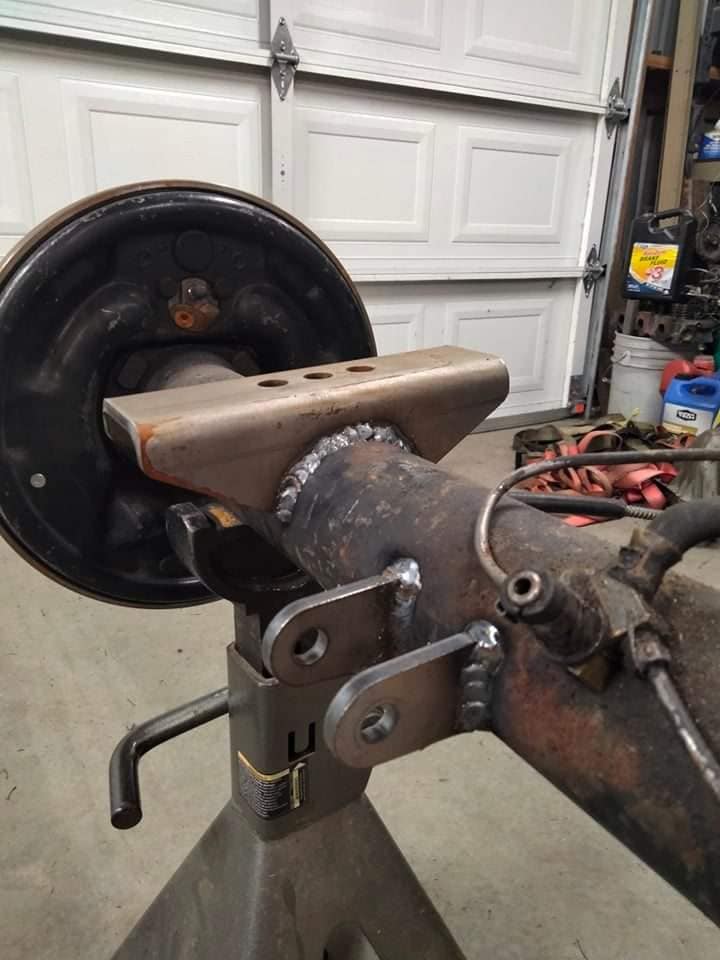

Front Axle
- 1978 F-150 Dana 44

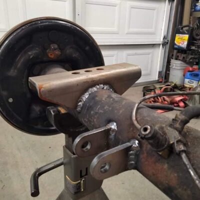

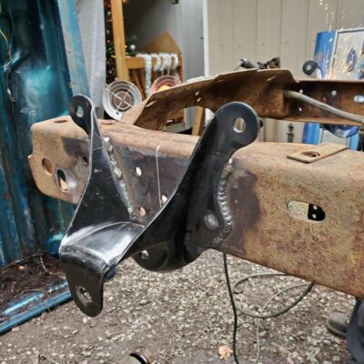

- Bolt on truss & lower buckets custom fabricated by Harley Fields
- Yukon 4.88 gears
- Spartan Locker
- Timken bearings
- Standard Gear Chromoly shafts
- Spicer U-Joints
- Warn hubs
- Ruffstuff 3/8 thick differential cover armor

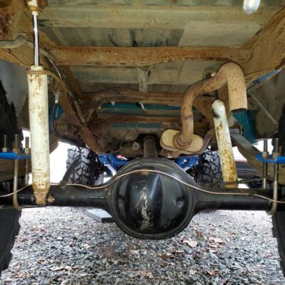

Rear Axle
- 1972 Ford Torino 9-inch
- Yukon 4.86 gears
- Detroit Locker
- Timken bearings
- Mosier Engineering Chromoly shafts
- Barnes4WD pinion guard armor
- Wild Horses Skid plate weld on armor

- 1992 F-350 frame to axle brake hose going to both axles
- Two left front Dana 44 brake hoses – one to each caliper

Suspension

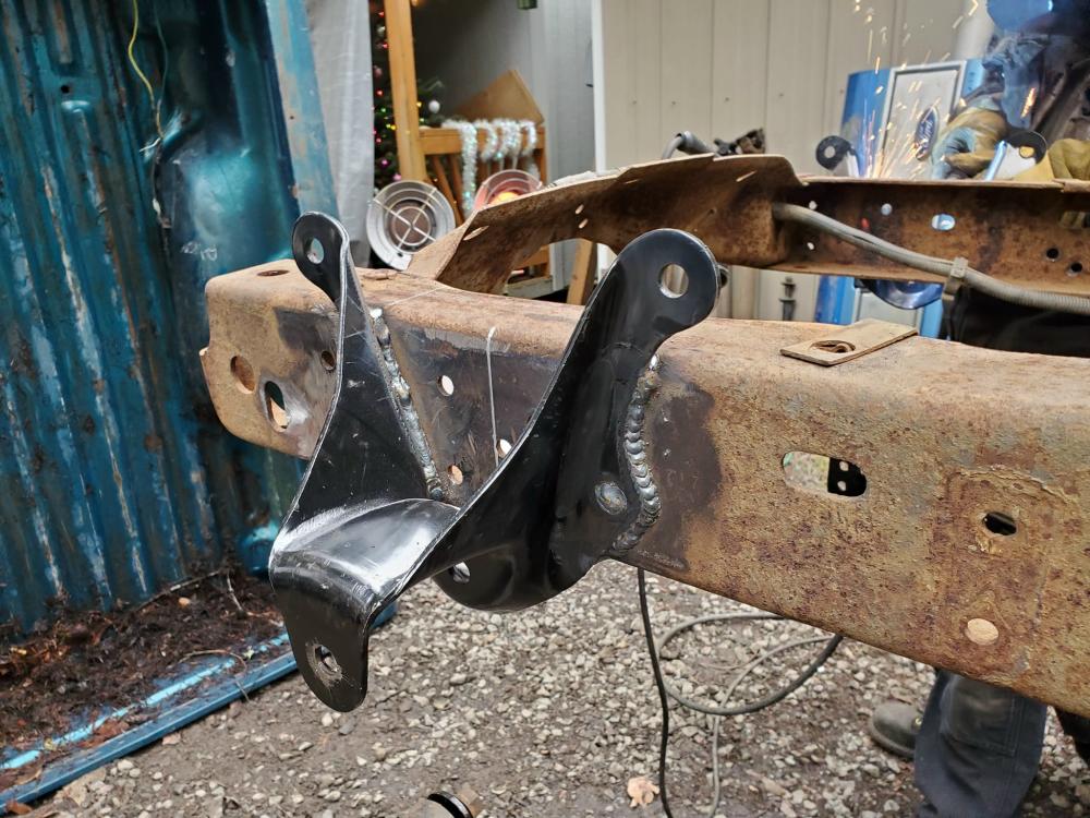

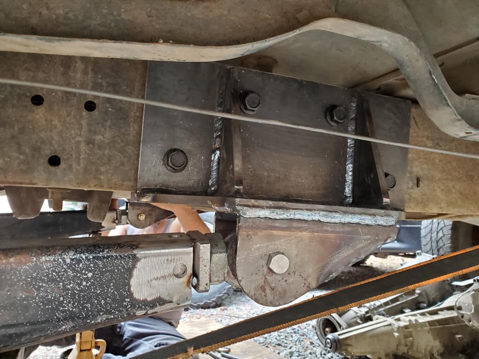

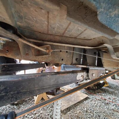

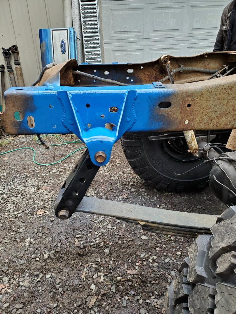

- Long arm radius arms – bought as they are – built to clear 40’s on a Dana 44 under a Jeep Cherokee

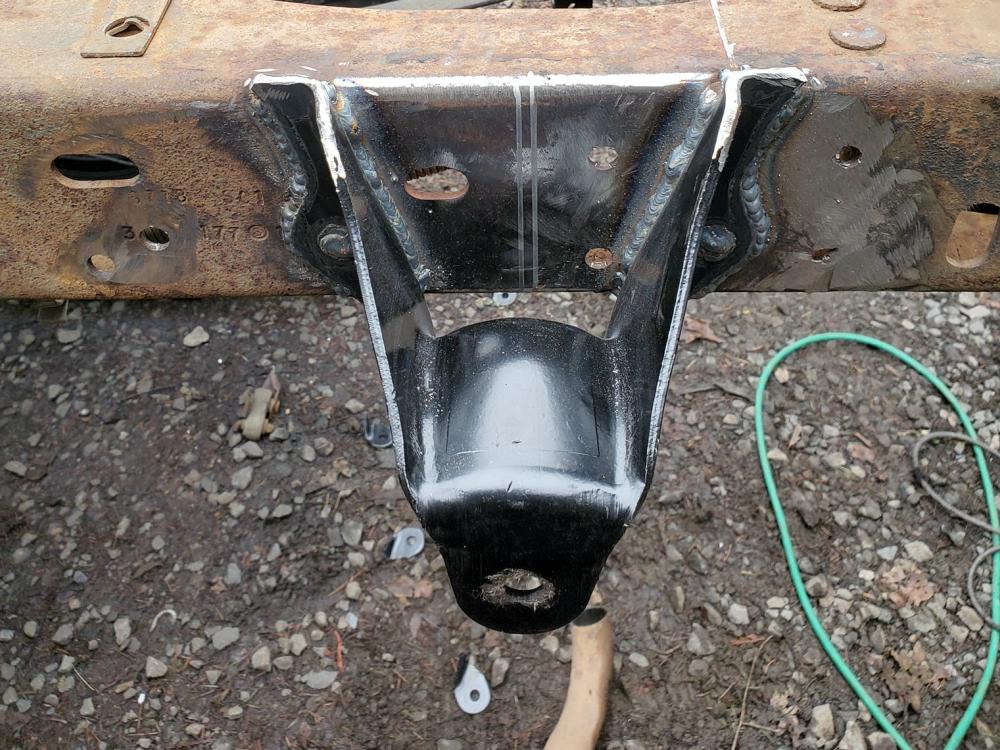

- Frame mounts & cross member support custom fabricated by Harley Fields
- Skyjacker front & rear shocks (4-inch up, 6-inch down travel)
- Upper shock mounts from 1978 F-250
- James Duff 1978 F-150 upper coil buckets modified to Jeep Cherokee bump stop style
- 6-inch lift progressive coils

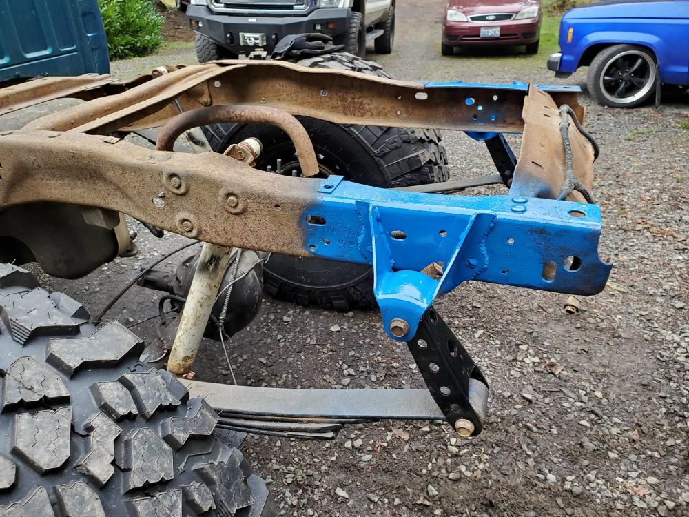

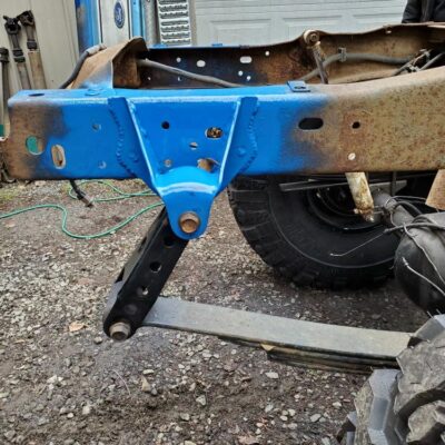

- Rear Factory Ford Explorer leaf packs with two add-a-leafs.
- Rear spring hangers lowered to bottom of frame rail.
- Belltech 6400 shackles
- Estimate 9-12 inches of lift
Wheels & Tires
- 41.5X13.5R17 Pitbull Rocker radials
- Dirty Life racing beadlocks
Cage, Bumpers & Lights
- Custom fabricated by Harley Fields using bender and roller
- Wanted to keep cross bar out of vision so cage disappears into fenders
- Stub & plate welded to inner cowl
- Rock sliders are XO FAB DIY sliders assembled & installed by Harley Fields
- 12-inch LED light bars under headlights wired to factory fog light harness.

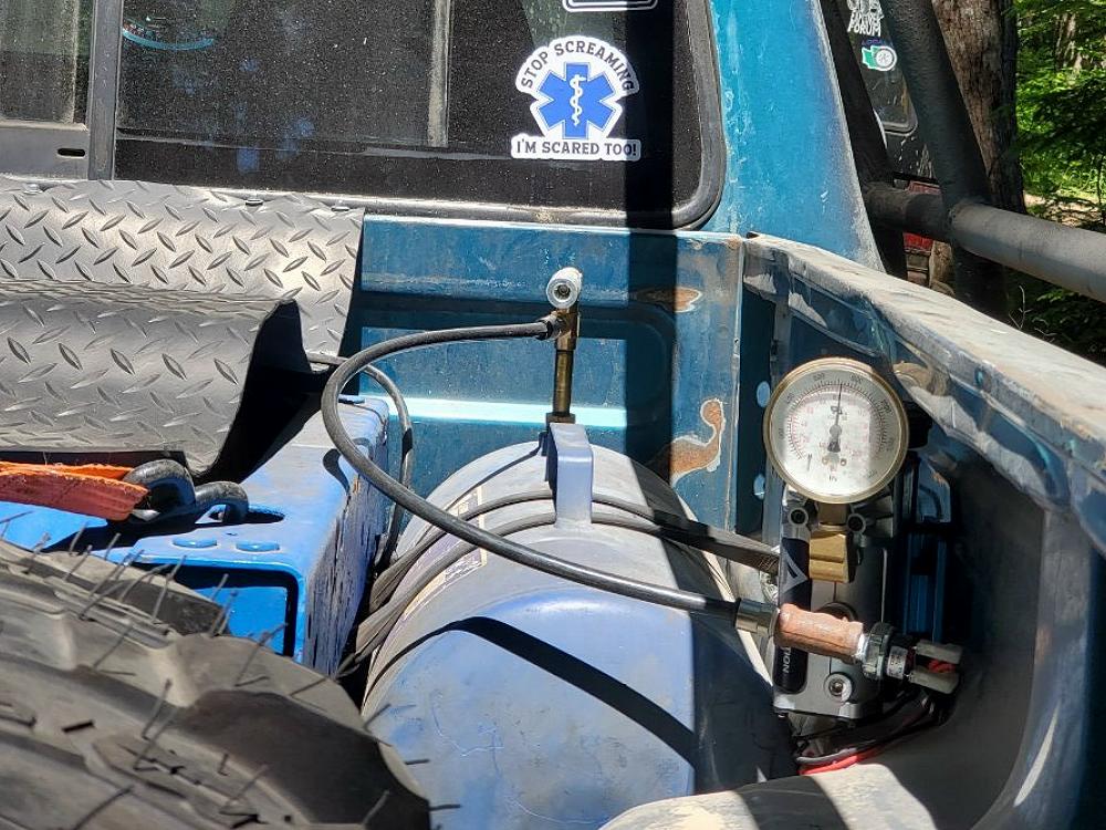

- ARB single piston with 7-gallon tank in bed
