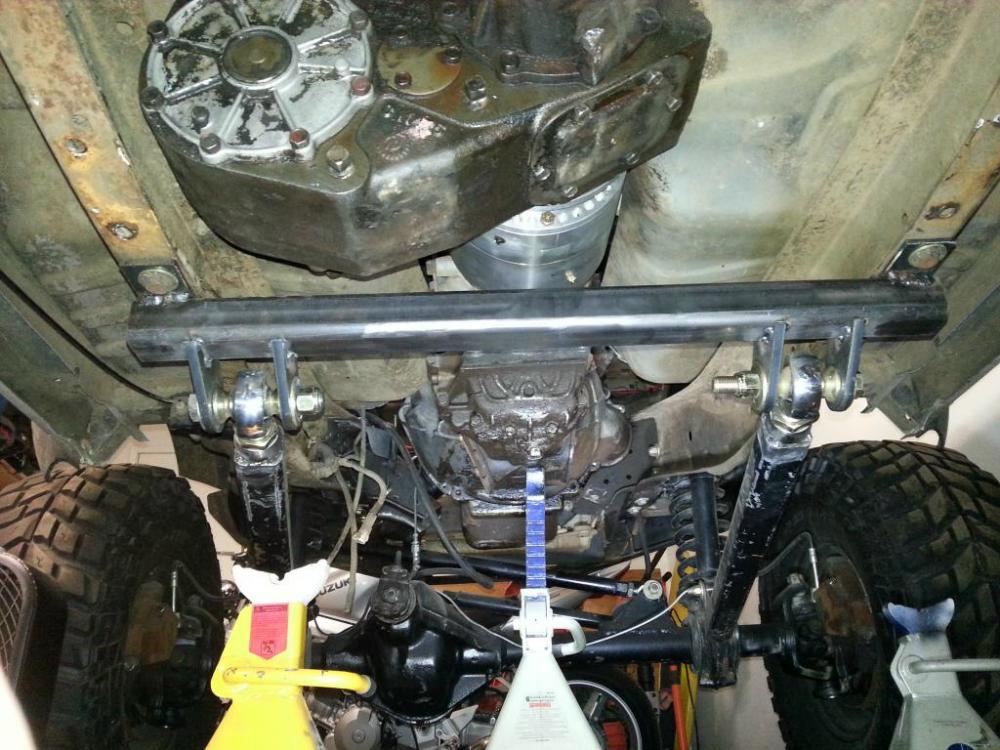

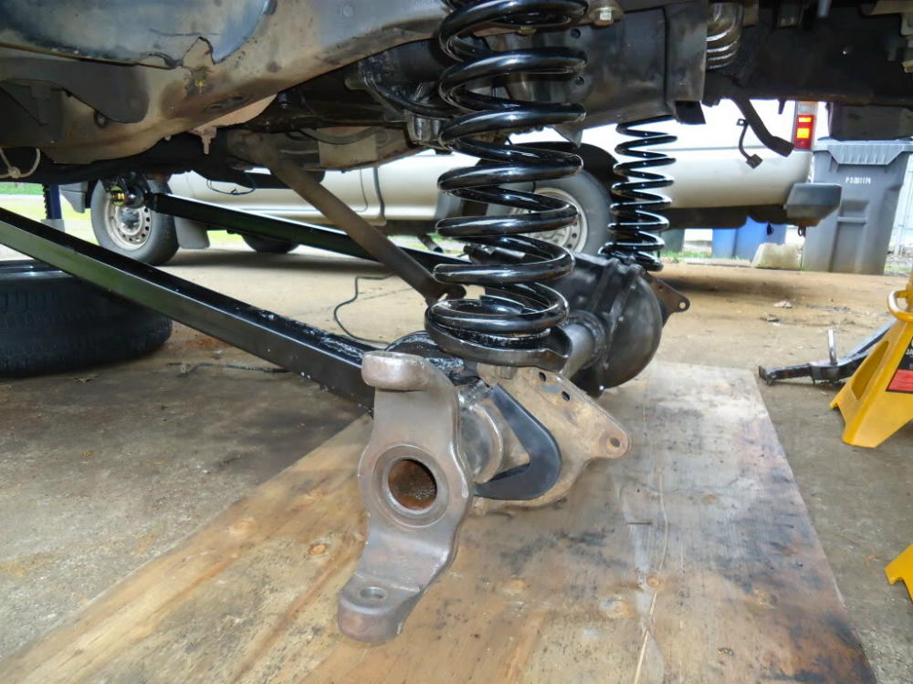

Front Axle
It was about time to lift the front and decided to go against TTB and go with a solid axle. I swapped in a full width Dana 44 out of a ’77 F-150. I used the coil setup but with 4.5″ lift EB coils. I extended the stock Radius arms approximately 12″ and used 1.25″ Heim joints at the ends for better flex. I built a cross-member to mount the radius arms to. I geared the front axle with 5.13’s and a Spartan Locker. I used Chevy 1-ton steering set and tie rod ends on the steering and swapped the steering about the knuckle instead of below. I built the track bar and track bar mounts on the axle and frame itself and used heim joints.

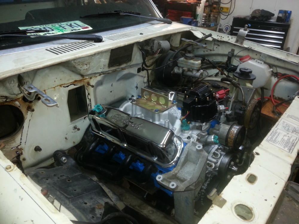

The old 2.3 I had in the truck was slow. I needed more power but didn’t want a lot of weight. I picked up a whole running TurboCoupe for $500 and swapped the 2.3 turbo engine in. The truck has a lot more power since the turbo swap and it didn’t add very much weight.

In 2014, Hagan updated the truck again with a 5.0L V8, ZF5 manual transmission, transfer case doubler, and NP205 transfer case. He also swapped in a fuel tank from a Ford Bronco II.
