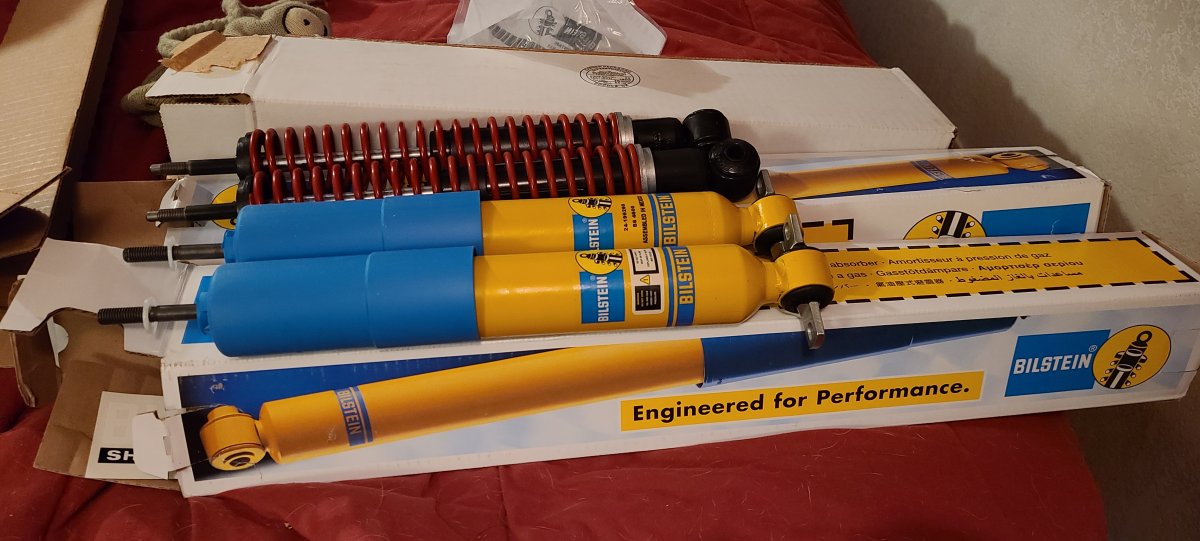

Smart thinking making them bolt on.
Those certainly aren't the factory style lower mounting points on those shocks. I'm not positive... but they interfere with the front axle shafts.
Really? I used Rock auto to find the part numbers and looked them up a bunch of places. The Bilstein's are supposed to fit the my truck. The Red/Black are supposed to fit the rear and are load assist shocks, found the part numbers the same way.

That is exactly what the difference would be... I thought it was a 4WD.
False alarm!
Please continue with your regularly scheduled joy concerning the arrival of your new parts!
False alarm!
Hahaha! Phew, you had me going there for a minute! While I've considered doing a 4x4 swap especially since I have a donor I don't think now is the time. If I do it I want to go full SAS swap and I don't have the time money or facilities to do that right now. It's kind of a long term pipe dream. Unless someone buys my 4.0 motor/trans etc. I'll probably rebuild both with some custom internals with the idea of upgrading. I'm also interested in possibly just doing a straight 4.0 swap for now, but I'd have to source a 2wd transmission for the 4.0.

This picture still begs another question...
Are the coil overs for the rear? Because the top mounting point on the rear shocks should be an eyelet.
I'm seriously not trying to ruin your excitement...
Sonofabitch! You're absolutely right! This is what they should be! Jokers sent me the wrong part... Why I ought ta... Send it back! Good loking out Gump!:icon_thumby:
