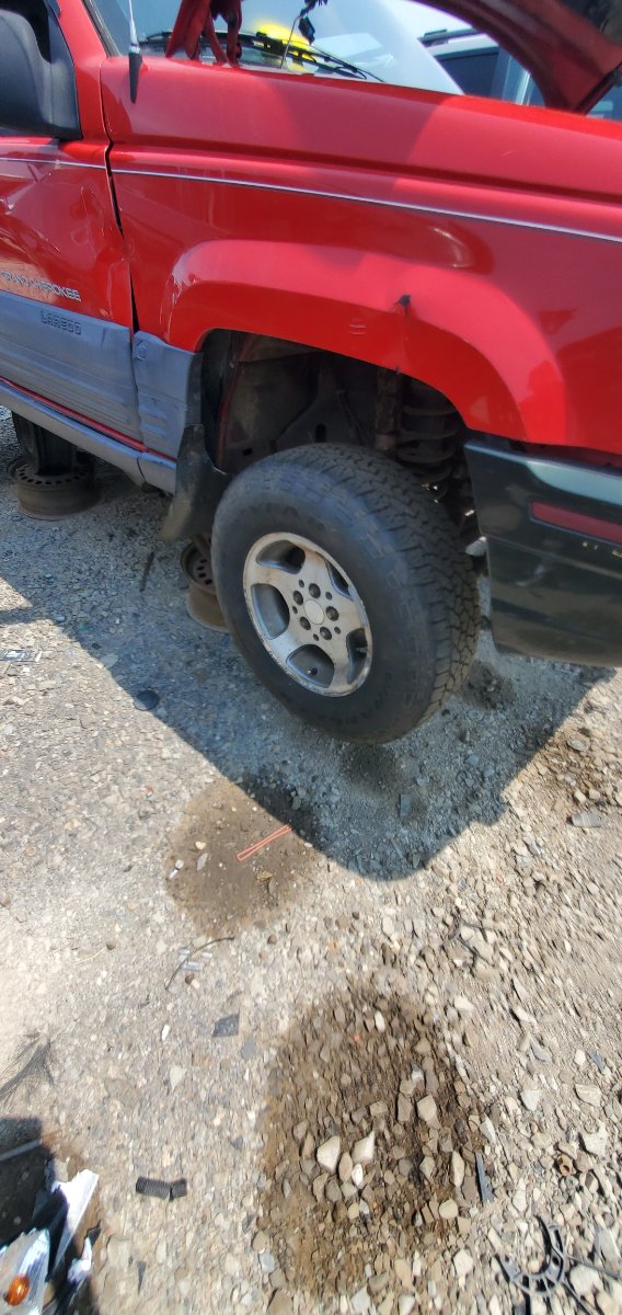

Let's see Paul Allen's Ranger.
Junkyard find
Will these fit a 2011?
Grand Cherokee? No. Cherokee is 5x127. Ranger is 5x114.3.
OLD XJ is the same as Rangers. 80s, early 90s squared off Cherokees. They are the preferred rear axle donor for 1948-60 Dodge 1/2 tons. Rangers are the preferred donor for same era Dodge/Plymouth -cars- due to the track width differences. Why? The stock 5x4.5 1940s wheels bolt right on to either donor axle… I’ll try to grab a pic later of a stock 1949 1/2t wheel with 6.00-16 bias ply tire on the 94 Ranger.
