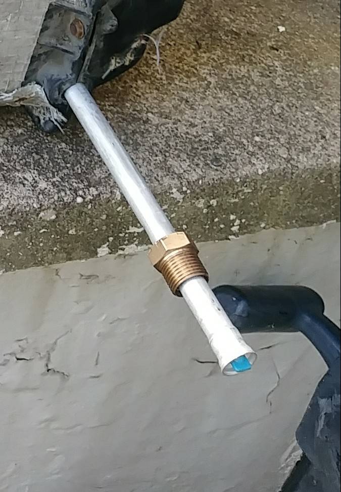

where is orifice tube

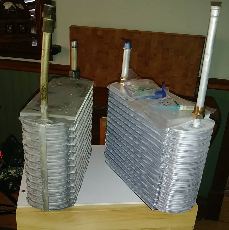

I wonder if the evaporator, could have a leak. Since I can't see it, maybe everything leaked out inside that enclosure, oil and all.
