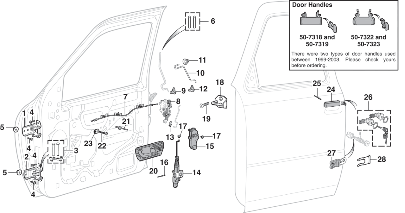

Do you need #9 or #12? It goes to the door latch somehow.

We have #26, #27, #10. No idea about the two parts you mentioned....
#6 goes on the rod you are trying to hook up correct? The pieces I mentioned look like plastic clips that hold the rod in place.

The ultimate answer was not any little plastic doo-hickey. We did buy new lock cylinders, but the way we fixed it was opening up the OTHER door and seeing how the heck this thing connects. Actually, more like FEELING it, because it was hard as heck to see. 90 minutes labor by two Dads, but it's done.
