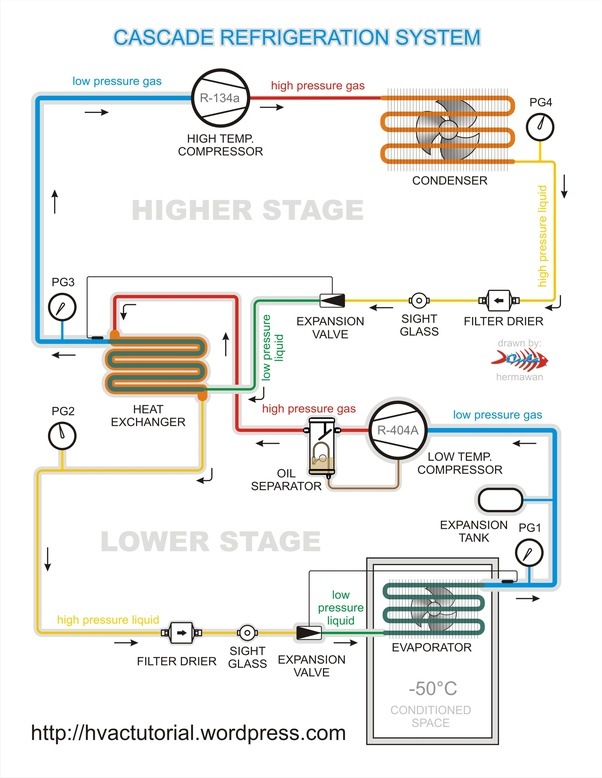

to go even colder, say -25 to-150 using Cascade /pump down systems, is a very unique field of refrigeration that I've really not dabbled in although, I have some knowledge of it.

If you look closely at the picture above, you will see a typical 134a system that is pretty typical of air conditioning or even air conditioning in a car or truck. The Cascade starts by basically using another system to arrive at much much lower temperatures.
