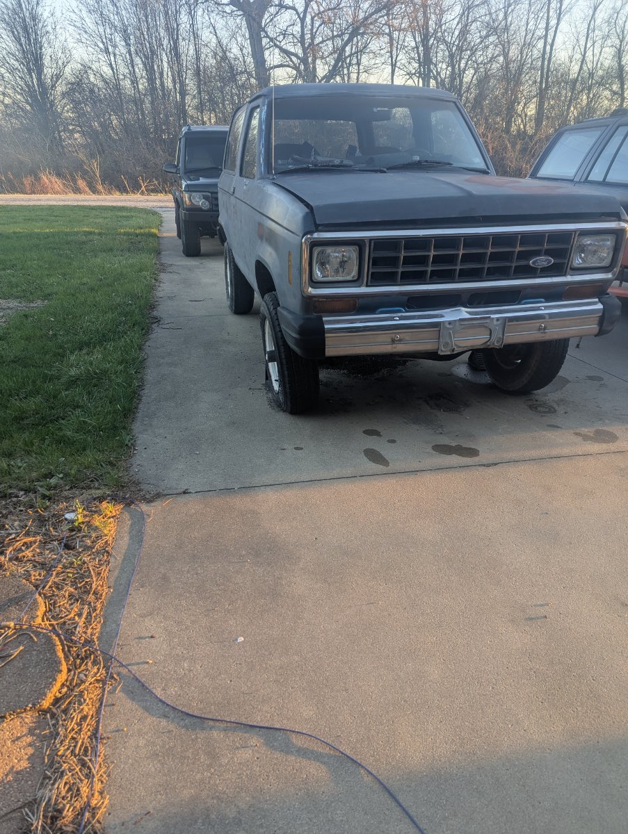

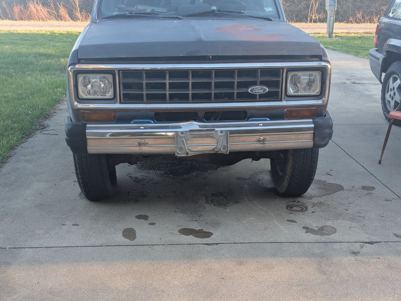

Well I managed to get the driver side done today, was quite an interesting day, not too bad of a job- just messy. But I may have another issue, and I have my suspicious by I could use some input.
When I lowered the truck for the evening, the passenger side wheel is crooked, like it's suddenly got a negative camber (I may have the wrong term). I know it's not so apparent in the photo, but it really is irl.
